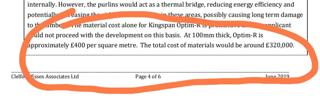

Iceverge Posted March 25, 2024 Posted March 25, 2024 22 hours ago, Griffithsg83 said: Inflation adjustes 40mm of opium-r would be close to £200/M2. For context you would buy 1.6m of PIR for that. Bin the idea of UFH unless you want to dig out the floor I say. 1
