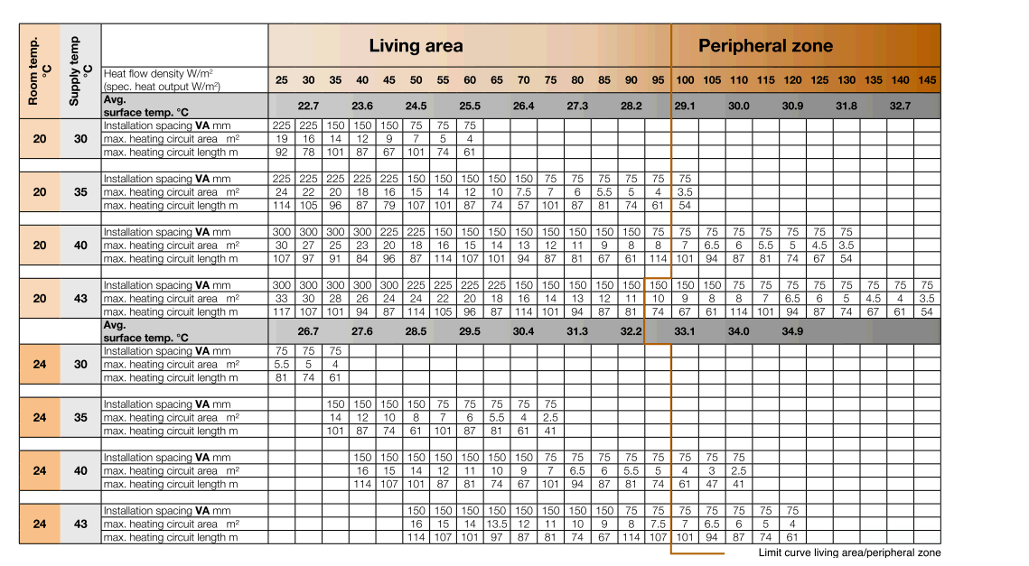

Trojan Posted March 22, 2024 Share Posted March 22, 2024 Similar to you badger I'm looking at installing a simple ashp single zone UFH system (although in a much higher heat loss area). This is a performance table I've been looking at to get an idea (they also have performance tables for their different systems and floor coverings, this ones fairly low profile with ceramic tiles - highest output). 4kW at 120m2 works out at 33W/m2. Looking at that 8 loops at 150mm centres would be more than sufficient and you could probably even get away with 6 or 7 at 225 centres while maintaining output at 35 degree flow temps. Looking into calculating flowrates a lot of google sources say 2-3 litres per minute or loop length/40. I watched a video of urban plumbers though where he calculates it by flow rate(l/s) = heat output(kw)/delta T(K) x 4.2 (specific heat capacity of water). Annoyingly his came out at 2.5lpm with a delta t of 7 so I don't know if it's just coincidence that he's in the range everyone else seems to use. If the formula is roughly correct though you'd only need 8 litres per minute (or 1 l/m per loop) for a delta t of 7, and the lower the output required (warmer days), the further that required flowrate falls. I've switched up the formula as I know the range the heat pump wants to operate (7-14l l/m) which would give you a delta T closer to 4 or 5 depending on output needed and flow supplied. I'd also urge you to go for the 5kw ecodan as it will modulate down to sub 2kw in warmer temps. Take everything I say with a pinch of salt though, I've not actually done it yet so it might turn out I'm talking complete pish. 1 Link to comment Share on other sites More sharing options...
