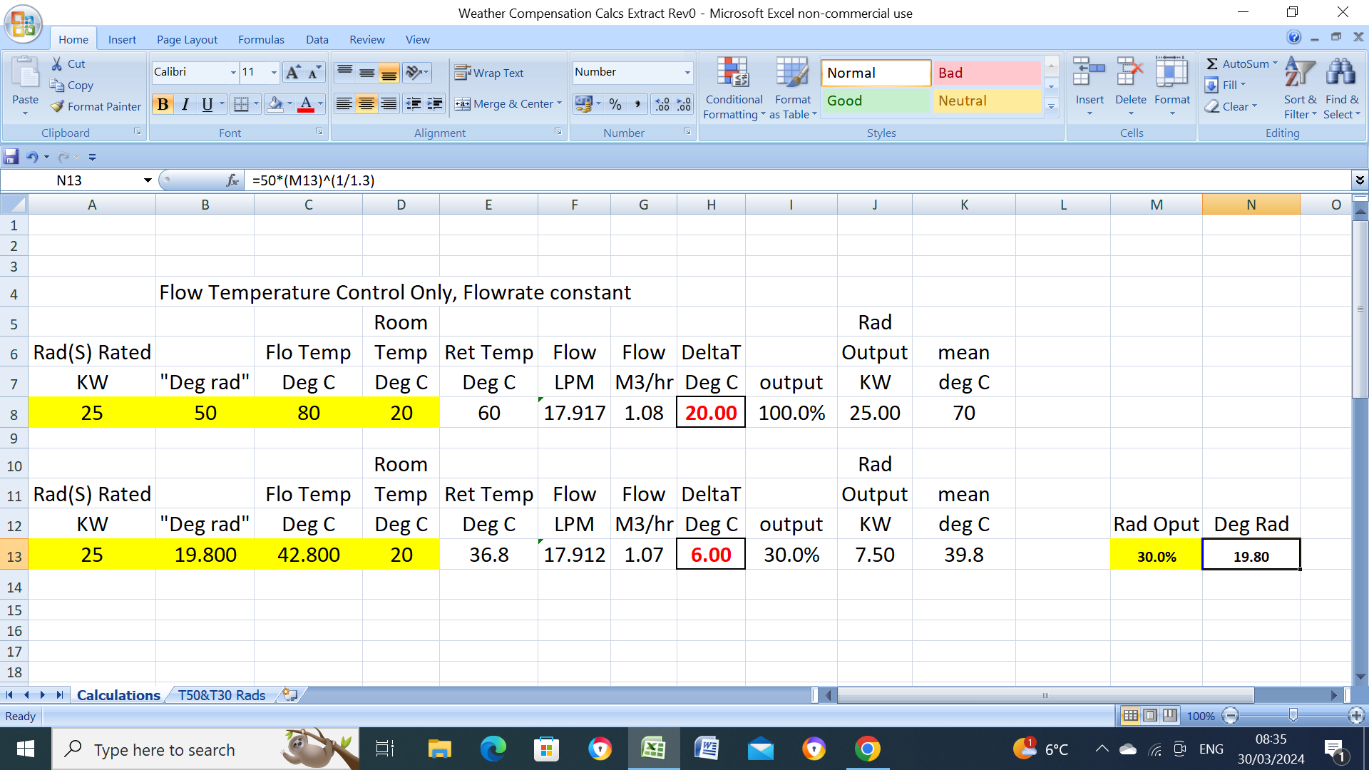

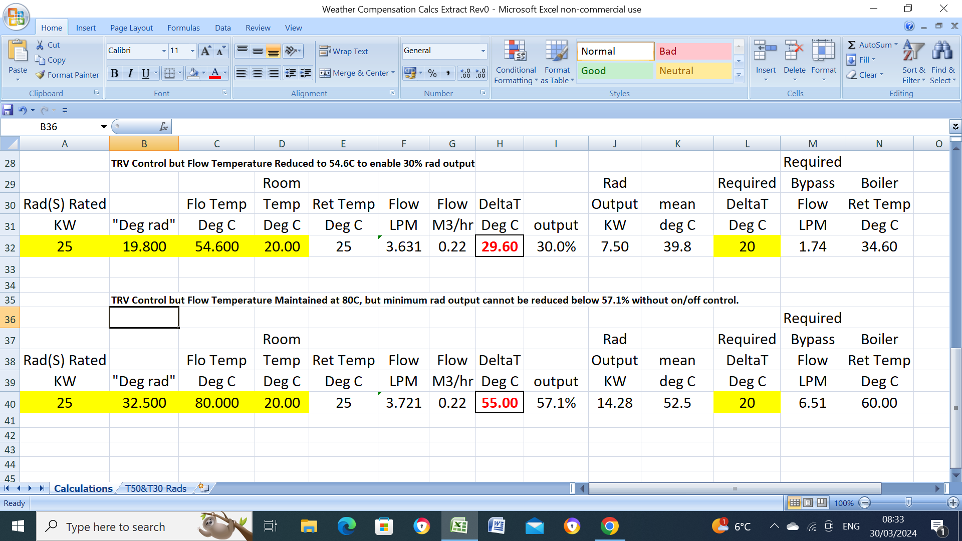

John Carroll Posted March 30 Share Posted March 30 (edited) Hi, Max Verstappen here, I do know quite a lot about radiators since they play a very important part in keeping my engines cool but also know how the rads work in my modest 4 bed house in Belgium. All boiler manufacturers use a dT of 20C (and have a settable flow temperature of 80C/85C) to calculate the max flowrate through their HEX and still allow sufficient pump head to circulate through the system rads etc without having to install a LLH or the like. Bearing that in mind a T50 rad must have a flow temperature of 80C with this 20C dT to give its rated output, the rad full output may only be required at a OAT of say -7C, the rad output requirement then reduces with increasing OAT so the rad flow temperature can be reduced to give this output, this can also be done by installing TRVs but these need careful monitoring as they can quickly run out of control at high flow temperature and also require a boiler internal or external by pass or both, it can be easily seen below the effect of not reducing the flow temperature and the very big effect on flowrates as was pointed out above. Edited March 30 by John Carroll Link to comment Share on other sites More sharing options...

John Carroll Posted March 31 Share Posted March 31 (edited) If the boiler flow temperature can be noted at when in DHW mode then this will give a good clue to the performance of the primary & secondary HEXs even though the blocking is apparently occuring during CH operation, I know I've repeated this more than once but if 2965 is just triggered by a the flow sensor, or maybe a a separate primary HEX sensor, it would be nice to know its setting. I posted these readings earlier from a 30kw WB CDI boiler which may give some clue, that boiler seemed to provide all sorts of info, don't know if this boiler has even got a return temperature probe. Fouled PHEX, (DHW setpoint 55C). DHW flowrate: 9.2LPM. DHW Temperature: 44.5C. Boiler flowtemp: 71.5C. Boiler output 16.4kw Mains Temp:19.0C NEW PHEX, (DHW setpoint 55C). DHW flowrate: 10.0LPM. DHW Temperature: 54.5C. Boiler flowtemp: 64.5C. Boiler output 24.1kw. Mains Temp:19.6C. Edited March 31 by John Carroll Link to comment Share on other sites More sharing options...

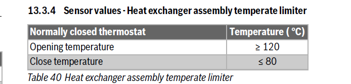

John Carroll Posted April 2 Share Posted April 2 I popped a email to WB, they inform that..... "The blocking code 2965 is generated when the heat exchanger temperature is greater than 88°C." So irrespective of TRV settings or whatever, once the heat demand is less than the boiler's minimum output then if the target flow temperature is set to 82C then it is almost inevitable that the temperature will reach 88C since all gas boilers don't trip the burner until the flow temperature reaches target temp+ (at least) 5C. This setting is far too close to the WB approved max flow temperature setting of 82C. I will now pose the question to them of whether there is a delay in clearing that alarm if still up on c/o to DHW. 1 Link to comment Share on other sites More sharing options...
SimonD Posted April 2 Share Posted April 2 1 hour ago, John Carroll said: I popped a email to WB, they inform that..... "The blocking code 2965 is generated when the heat exchanger temperature is greater than 88°C." So irrespective of TRV settings or whatever, once the heat demand is less than the boiler's minimum output then if the target flow temperature is set to 82C then it is almost inevitable that the temperature will reach 88C since all gas boilers don't trip the burner until the flow temperature reaches target temp+ (at least) 5C. This setting is far too close to the WB approved max flow temperature setting of 82C. I will now pose the question to them of whether there is a delay in clearing that alarm if still up on c/o to DHW. Nice one! Good to get some clarity here. For reference I spent last week completely reconfiguring a system with a massively oversized boiler. This was a 30kW WB system boiler which I got modulating using opentherm controls with a converter and now working on PDHW with the opentherm controls rather that the WB diverter. On DWH set to max boiler temp of 82C it would sometimes get to over 90C as the cylinder reached target temp and the diverter valve closed and the system then relied on the bypass only for flow. But never did the boiler block as such, just tripped the burner as would be expected. Link to comment Share on other sites More sharing options...
John Carroll Posted April 2 Share Posted April 2 (edited) Interesting, looking at their reply again they said the heat exchanger temperature and not the flow temperature so there could be a significent difference in these depending on where the sensor is attached, could be something as simple as a faulty or badly attached blocking sensor? Its a wonder the experienced WB engineer wasn't aware of this sensor's setting and location, i would chase them a bit further especially since this fault has been there since early on. Edited April 2 by John Carroll Link to comment Share on other sites More sharing options...
