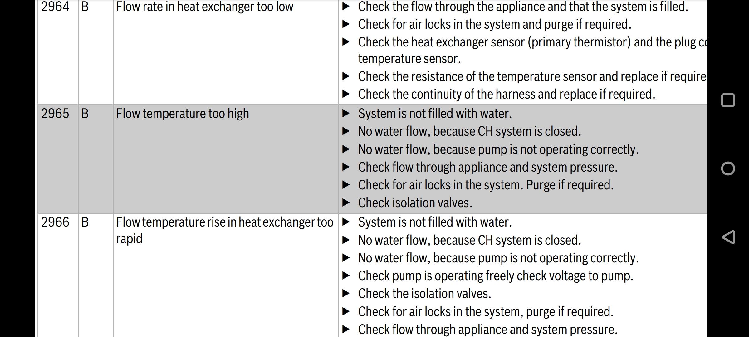

code is very specific '2965' to be precise
A quick read of the manual
The B is
Fault category B (blocking faults)
Blocking faults result in the heating system being shut down temporarily.
The heating system restarts automatically as soon as the blocking fault is removed.

Not missing point at all.  It's a single boiler, that has a blocking code, this will prevent it firing up for any reason. The CH flow fault needs to be resolved with the flow through the boiler, otherwise it will only continue as it is.
Would suspect the following occurs
Trv's are open, boiler flows no issue, does heating and DHW as normal, trv's close in or fully closed, there is not enough flow through the system left open (2 rads and 15mm pipes), boiler gets blocking code. Boiler does fire for any reason while blocked.  Rooms cool, trv's open, heating resumed as pump can now flow enough - repeat

I have very definitely stated that it is blocking code 2965. And it does clear after about 4-5 minutes. There has never been an actual 'error' code on this boiler that would require a manual reset.
OK, if  this happen after using DHW constantly with no demand for CH in between (DHW demands) and if the boiler flow temperature is anywhere in the region I posted above during DHW demand then blocking code 2965 simply cannot be true which I would point out again to WB.
 If its coming up during a CH demand or CH anticycle or overrun then it will have to rise to whatever temperature it operates at, probably greater than 90C, unlikely, but possible, IMO. Again  just observe the flow temperature for the pump overrun time after switching off the CH demand and see what temperature it rises to.
