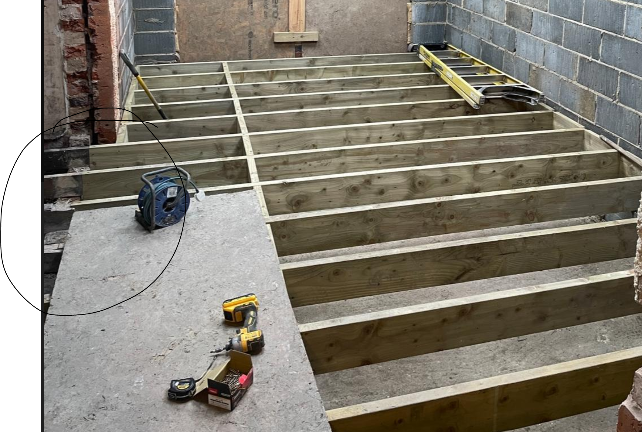

Lesley72 Posted March 18, 2024 Author Posted March 18, 2024 @Dave Jones I’ve found this photo.. not sure what use it will be 2
saveasteading Posted March 18, 2024 Posted March 18, 2024 Joists are designed for collapse and acceptable deflection ( 1 in 360 I think). Deflection is always the critical factor in domestic use. If the joists are the right size, and noggined, then they won't be budging. It must be the boards deflecting between joists. Have you tried bouncing on them at different positions, ie on or between joists? Near the wall the joists won't budge at all.

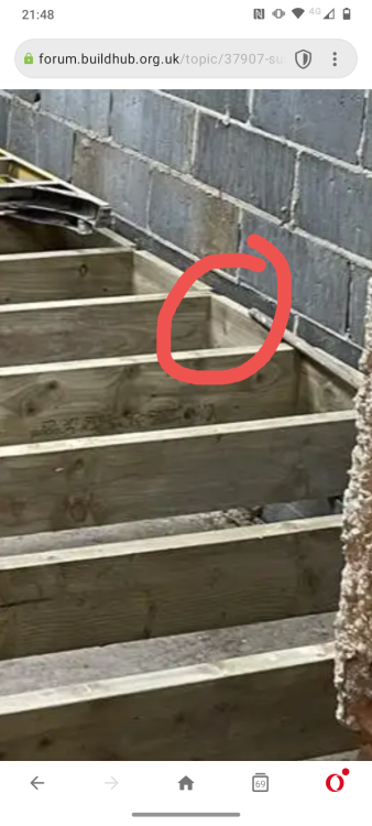

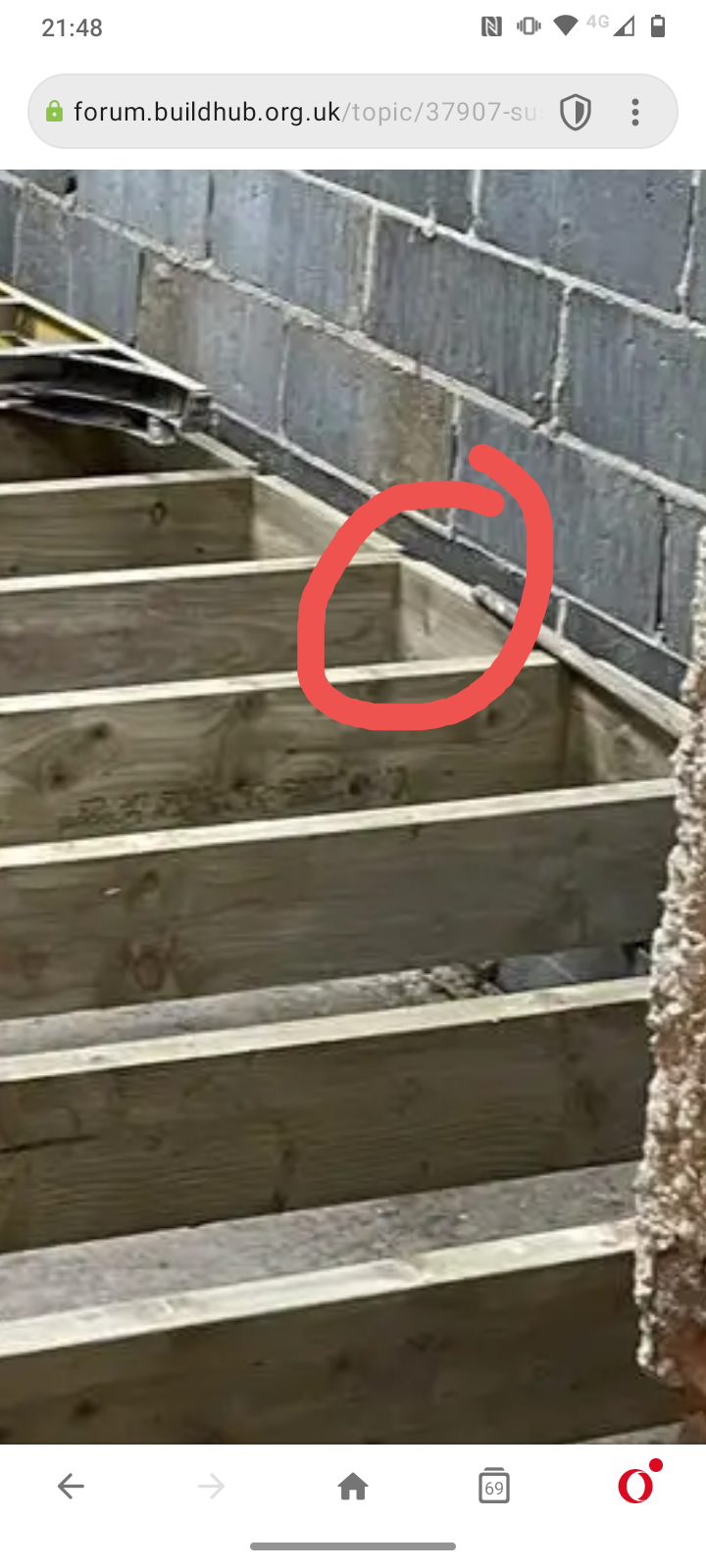

Dave Jones Posted March 18, 2024 Posted March 18, 2024 did they use hangers ? They notched out to sit on that wall. wonder how level it was ? Was the chipboard foam glued down ? Should be rock solid if it was ?
saveasteading Posted March 18, 2024 Posted March 18, 2024 Photos are great. The noggins need to be more central or another row of them. But i suspect that isn't the main issue.
saveasteading Posted March 18, 2024 Posted March 18, 2024 On 18/03/2024 at 19:47, Dave Jones said: They notched out to sit on that wall. Expand Sorry i don't know what that means. I can't see hangers. Are these just nailed into the wall plate?

Dave Jones Posted March 18, 2024 Posted March 18, 2024 On 18/03/2024 at 19:54, saveasteading said: Sorry i don't know what that means. I can't see hangers. Are these just nailed into the wall plate? Expand 1

bassanclan Posted March 18, 2024 Posted March 18, 2024 How is this timber fixed to the blockwork? There doesn't seem to be a joist hanger. I suspect the timbers are resting on a concrete block on its side. A noggin against the wall hides a lot! Have you got much insulation under there? Doesn't look much space for insulation and ventilation. If you are having to rip up the tiles then the chances are that the subfloor is going to be damaged, so worth spending the time getting that right first. If the builder hasn't fitted hangers as he should then all these remedial costs are on him!
