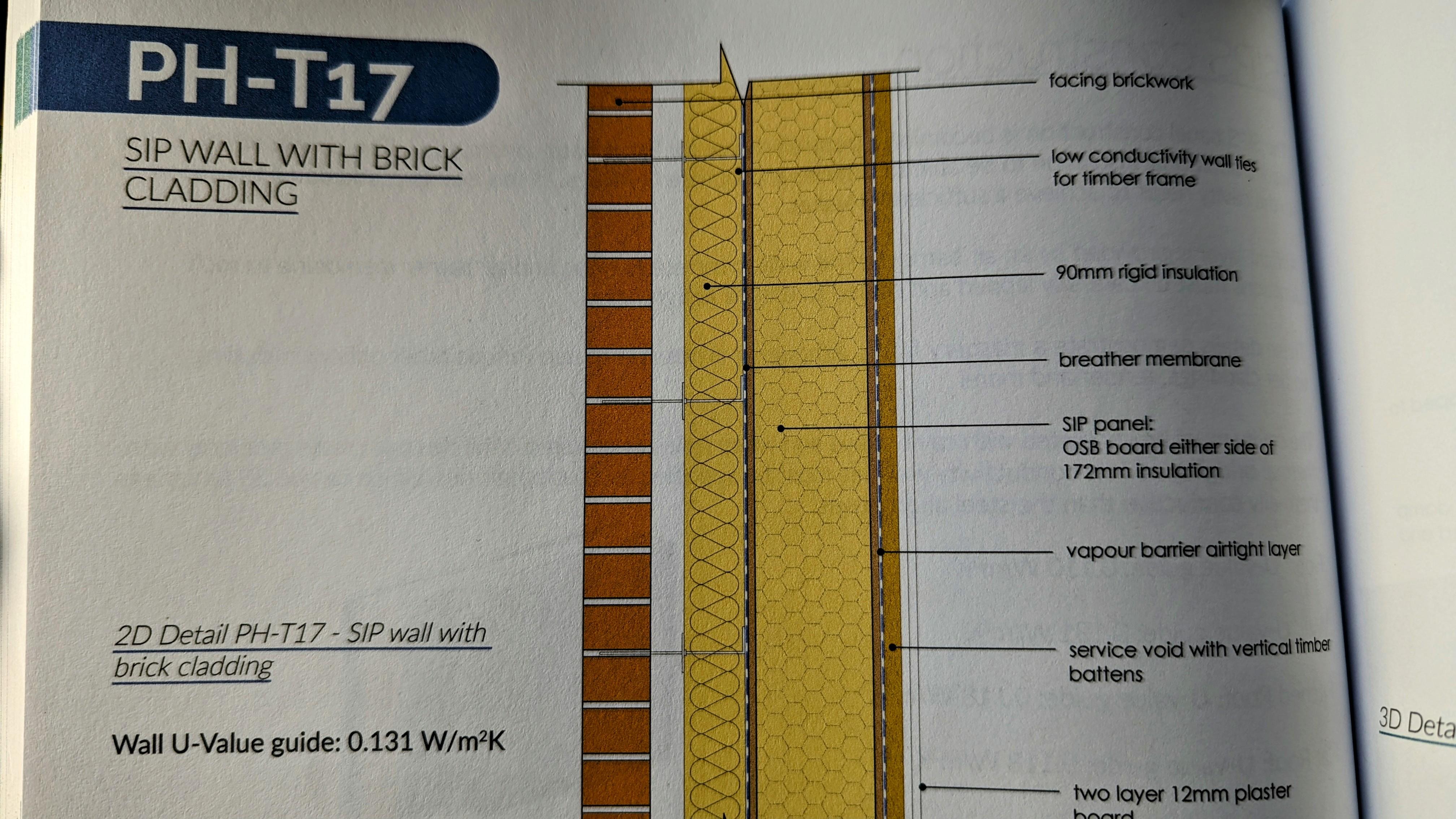

BrackensBuild Posted March 18, 2024 Share Posted March 18, 2024 We’re building with SIPs and will have 100mm EWI on the walls and 80mm insulation on the inside of the roof. For the walls, we will use Glidevale Thermo Extreme breather membrane outside, then Glidevale Protect BarrAir membrane on the inside. Currently trying to work out if we use the same membranes for the pitched roof and would welcome any thoughts or suggestions. Link to comment Share on other sites More sharing options...

BrackensBuild Posted March 25, 2024 Author Share Posted March 25, 2024 On 18/03/2024 at 08:12, Russell griffiths said: I’m baffled as to why you are building with sips and then having to add extra insulation. either get a better sips product or find a different method of building happy to be educated as to the reason. 142mm SIPs + 100mm EWI = better u-value for the same wall depth versus just a 250mm SIP. In addition, we can reduce cold bridging where we have timber posts within the SIPs instead of the splines (where structurally required). Link to comment Share on other sites More sharing options...
markocosic Posted March 25, 2024 Share Posted March 25, 2024 Air barrier - stops bulk movement of air through a structure (important) Vapour retarder/barrier - slows/stops movement of moisture through a structure (less important) Science: https://buildingscience.com/documents/digests/bsd-106-understanding-vapor-barriers SIPs on their own are problematic because: - You have a symmetrical wall/roof (vapour retarders in the form of OSB on BOTH sides) - That vapour retarder is made of weetabix (can't do moisture) - You have leaks in the wall/roof (making joints airtight is difficult/impossible) They don't fail so much at ground level (where cold air is sucked through the wall, heated as it goes through the insulation layer, and dries out in the process) They do fail at the ridgeline (where warm moist air exits and dumps the excess moisture into the SIP assembly) They really fail if the cladding/roof covering isn't well ventilated (and that excess moisture stays in the outer layer of weetabix) I would suggest this variation: stick an airtight vapour barrier (can be polythene) on the OUTSIDE of a skinny SIP then go over the top of that with insulation. The air/vapour barrier on the OUTSIDE is easier to apply well (less likely to be compromise than one inside the house with service penetrations etc) and keeps the SIP dry until it's insulated, roofed, and cladded. Link to comment Share on other sites More sharing options...

markocosic Posted May 7, 2024 Share Posted May 7, 2024 Still needs an airtight layer. That internal insulation layer is just to sell you more kingspan.ftom insulation perspective is better outside but practically they can't do that without turning the house into Weetabix due to non breathable nature of the insulation so are forced to put it inside and tape the living daylights out of it Link to comment Share on other sites More sharing options...
MoDo Posted May 7, 2024 Share Posted May 7, 2024 6 hours ago, markocosic said: Still needs an airtight layer. That internal insulation layer is just to sell you more kingspan.ftom insulation perspective is better outside but practically they can't do that without turning the house into Weetabix due to non breathable nature of the insulation so are forced to put it inside and tape the living daylights out of it No airtightness tape detailing that I can see on their Standard Details PDF. The system is designed to have plasterboard fixed directly to the OSB. Airtightness is taken care of by overlapping and sealed giant T&G joints of the SIPS panels themselves. PIR is just for higher u-values. A breather membrane is fitted to the outside. Link to comment Share on other sites More sharing options...
markocosic Posted May 7, 2024 Share Posted May 7, 2024 Weetabix waiting to happen in that case. Link to comment Share on other sites More sharing options...
