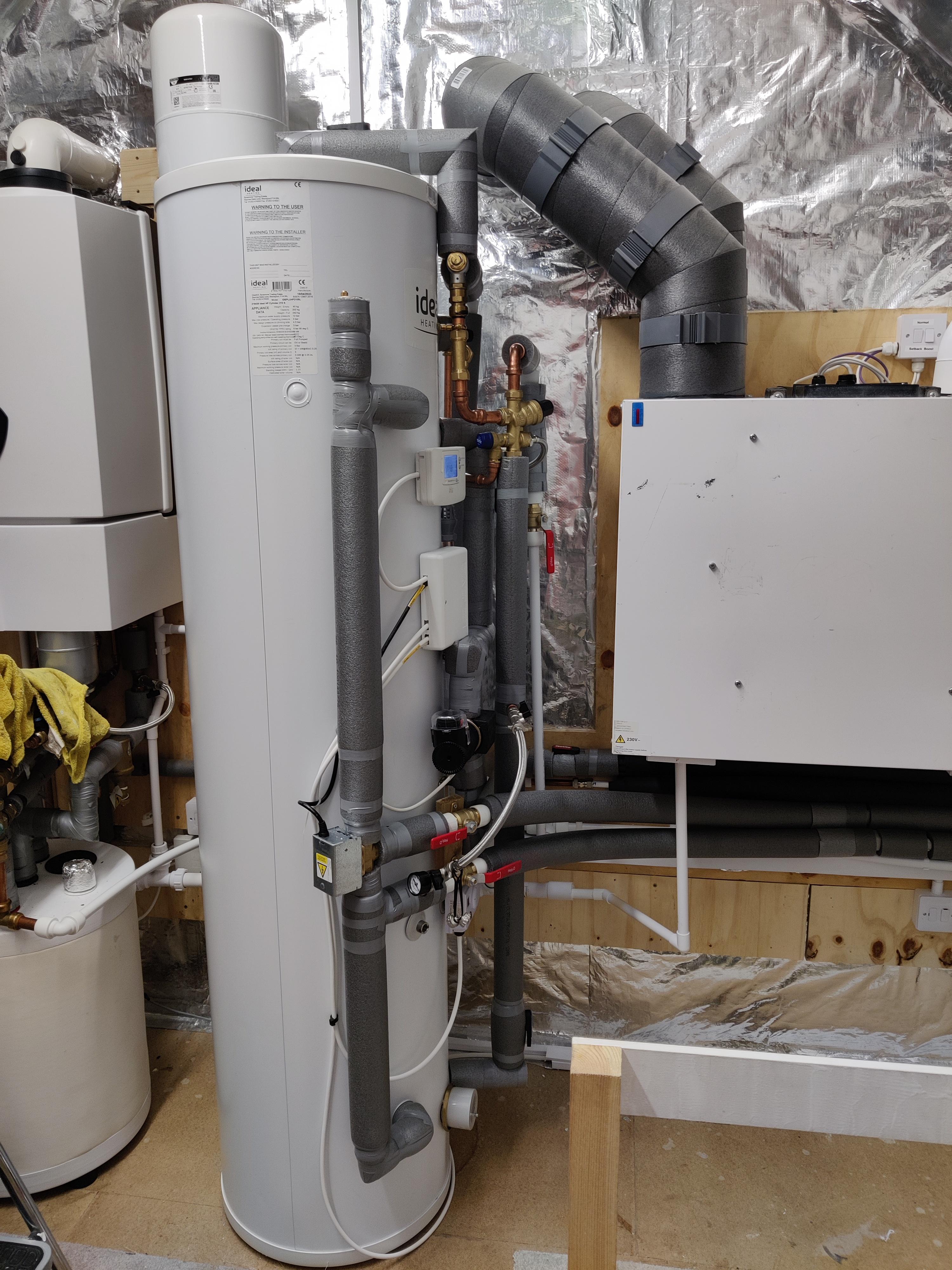

Dave Jones Posted March 16 Share Posted March 16 we have panasonic fancoil units in the bedrooms, mainly for cooling use. yet to use them as its too hot upstairs already with a flow temp of 25c to the slab. Plate heat exchanger while a bit more money are much more efficient than in tank coils and allows the use of multiple bog standard cheap cylinders. 2 Link to comment Share on other sites More sharing options...

Jane W Posted March 16 Author Share Posted March 16 46 minutes ago, Dave Jones said: Plate heat exchanger while a bit more money are much more efficient than in tank coils and allows the use of multiple bog standard cheap cylinders. I haven't looked into these or fan coils tbh, what considerations made you go that route? Link to comment Share on other sites More sharing options...

JamesPa Posted March 16 Share Posted March 16 5 hours ago, Dave Jones said: Plate heat exchanger while a bit more money are much more efficient than in tank coils and allows the use of multiple bog standard cheap cylinders. I'm interested in this comment. One ashp installer I am talking to suggests a pump plus phe instead of a large coil in the cylinder. The cost is no different because it allows you to use a cylinder that doesn't have a coil (£400) as opposed to a heat pump specific cylinder (800+). The arguments for the arrangement seem potentially convincing to me, although there is the noise of the pump to consider. It also introduces the possibility to put the pump plus phe remote from the cylinder, or retrofit an existing cylinder which has an insufficiently large coil, both of which have applications. 2 Link to comment Share on other sites More sharing options...

Jane W Posted March 16 Author Share Posted March 16 6 hours ago, JamesPa said: One ashp installer I am talking to suggests a pump plus phe instead of a large coil in the cylinder What are the benefits over a heat pump cylinder given similar initial costs? Link to comment Share on other sites More sharing options...

JamesPa Posted March 17 Share Posted March 17 (edited) 10 hours ago, Jane W said: What are the benefits over a heat pump cylinder given similar initial costs? Principally that more of the tank is heated so you can have a smaller tank. Also arguably greater efficiency (see the mixergy blog on this). You can probably get a smaller approach temperature (different between flow temp and dhw temp) also. Furthermore the coil isn't taking up space in the cylinder. The other potential advantages are situation dependent and mostly applicable to retrofits. It can be done as a retrofit to an existing tank which otherwise has an insufficiently large coil, and/or the phe doesn't have to be colocated with the cylinder (I can't actually think of a specific circumstance where this is useful but there is bound to be one!). On the negative side it's more complex and less familiar to plumbers. A couple of heat pump manufacturers cylinders use a phe and pump instead of a coil (Mitsubishi, plus I think Ideal) Edited March 17 by JamesPa Link to comment Share on other sites More sharing options...
JohnMo Posted March 17 Share Posted March 17 19 minutes ago, JamesPa said: Also arguably greater efficiency (see the mixergy blog on this). https://mixergy.co.uk/news-and-insights/plate-heat-exchanger-vs-coil-the-great-debate/ Interesting read, but does generalise with respect coils, making the assumption that all coils are just a single coil. Most coils are now multiple coils run in parallel, so you could have 4 to 6 separate coils fed from a manifold to make up the coil stack. It assumes the coil starts a fair way up the cylinder. My nothing special off the shelf cylinder, the coil starts as low down as practical, being just above the immersion. Not as low as the mixergy but not 20% higher as indicated in the text. I do believe the extra heat transfer efficiency. But you have an extra pump in the system also. The bit I find worrying for the real world is this - 4 hours to reheat the cylinder. https://mixergy.co.uk/news-and-insights/real-world-performance-of-mixergy-and-heat-pumps/search Link to comment Share on other sites More sharing options...
