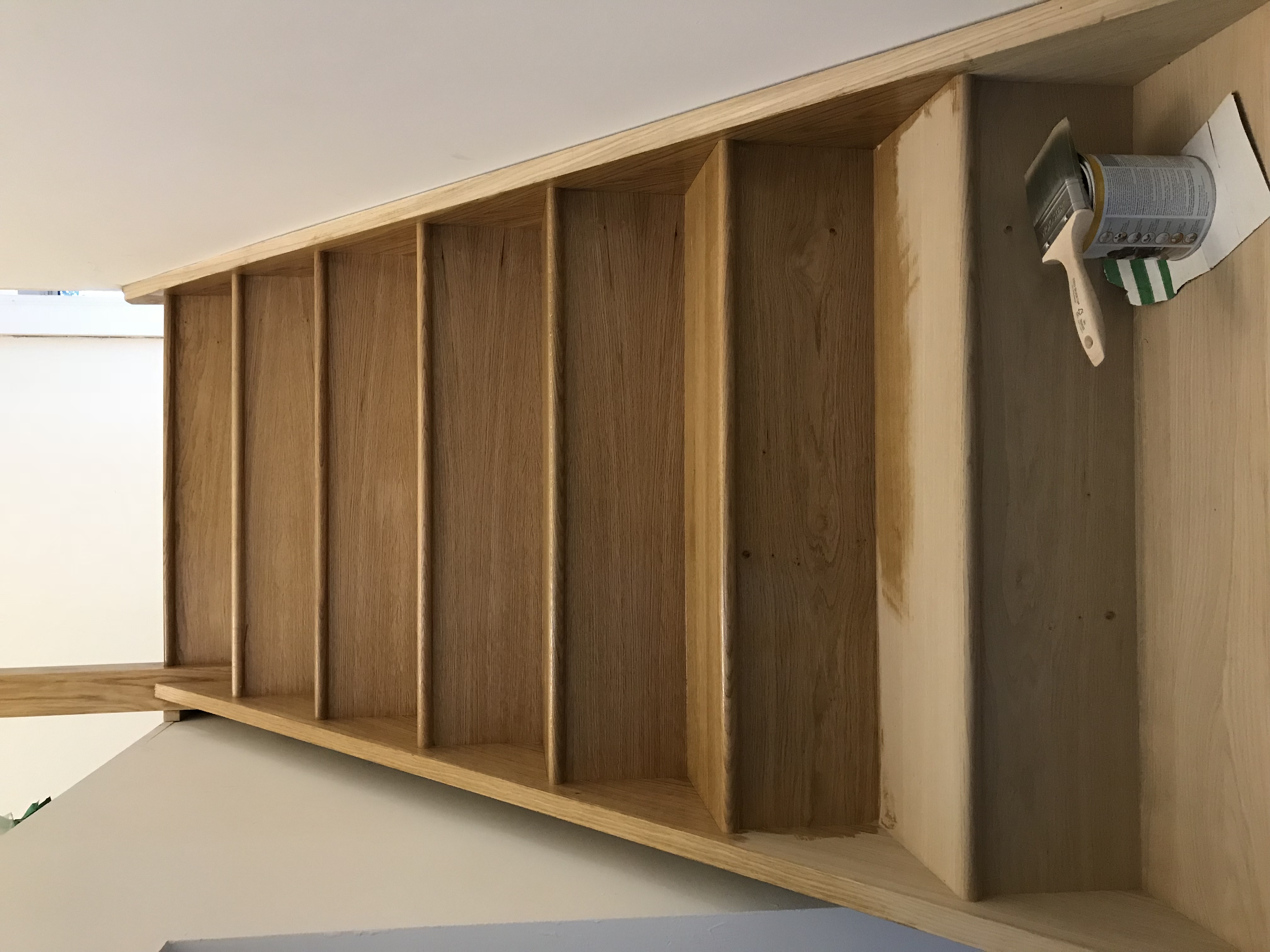

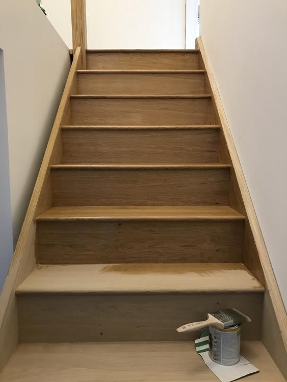

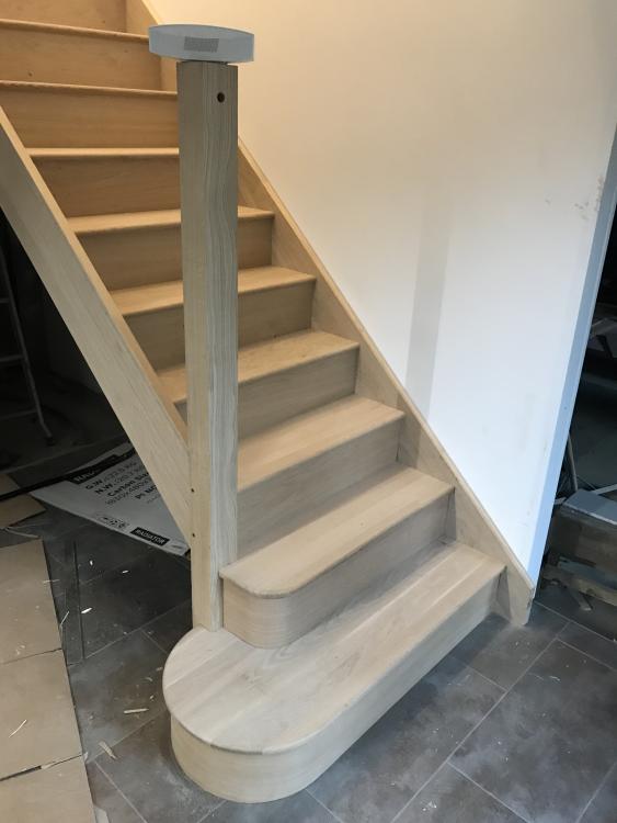

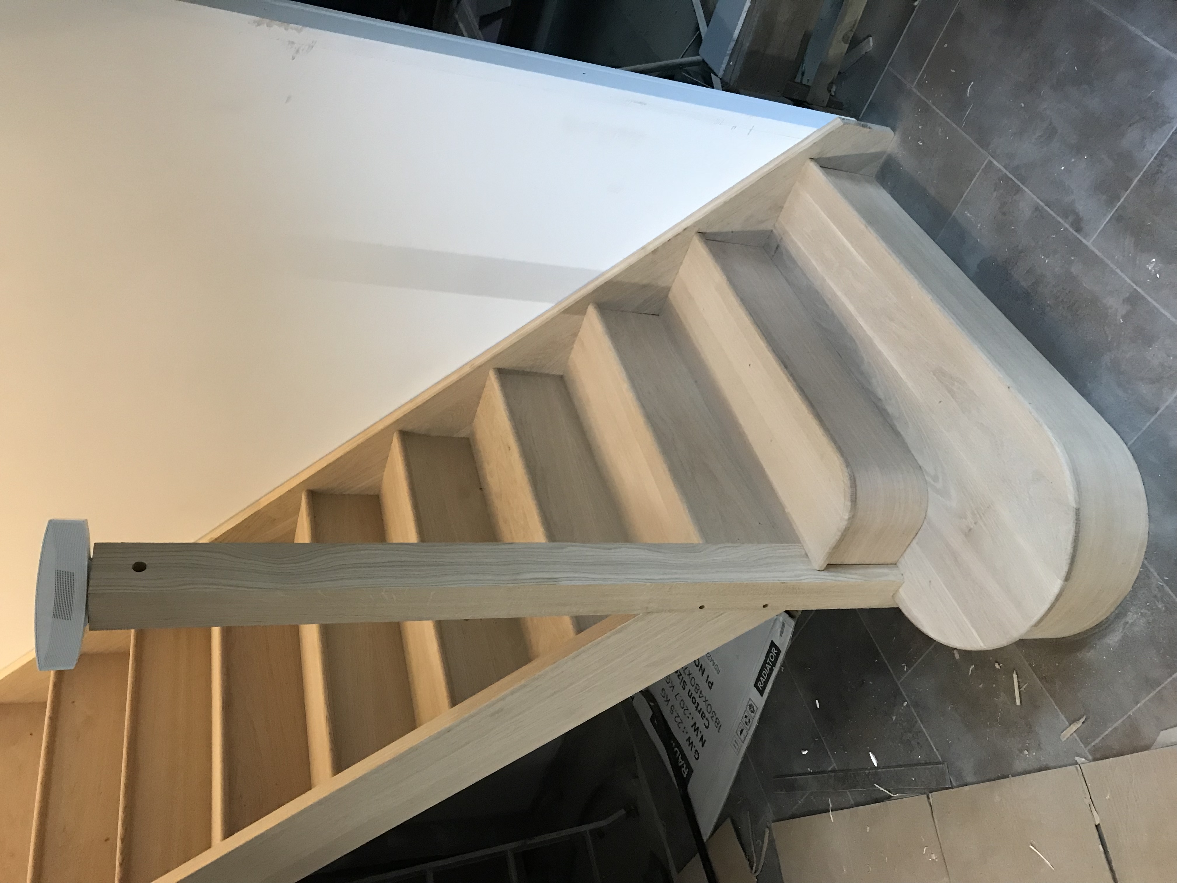

Grosey Posted October 4, 2017 Posted October 4, 2017 Things are moving thick and fast at my place at the moment which is exciting. First staircase from Stairbox was dry fitted today and will be completed tomorrow. So I’m keen to get it treated and protected ASAP. Its a combination of solid oak and engineered oak. I believe a hardwax oil is the best thing to use? Screwfix do a “Liberon” Hard wax oil in Matt or Satin or Osmo Polyx Clear Satin Matt Or something else? Want a good level of protection to protect from dog feet! Also any advice on the Matt or Satin look for Oak?

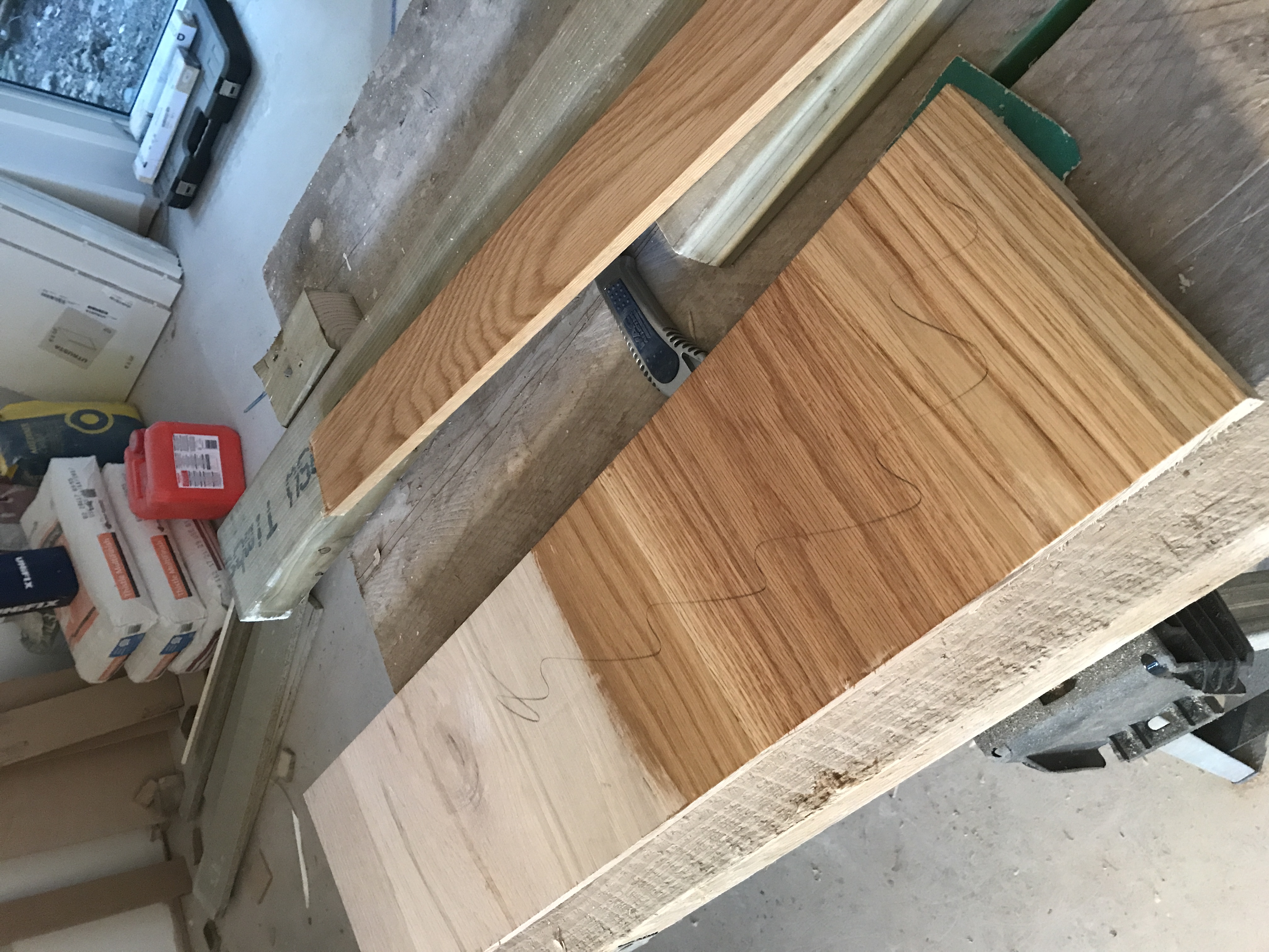

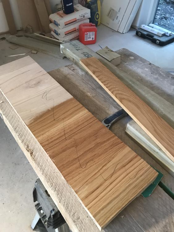

Lesgrandepotato Posted October 4, 2017 Posted October 4, 2017 This has two coats of Osmo oil satin (and a light coat of dust) i like it, no idea how well it will last

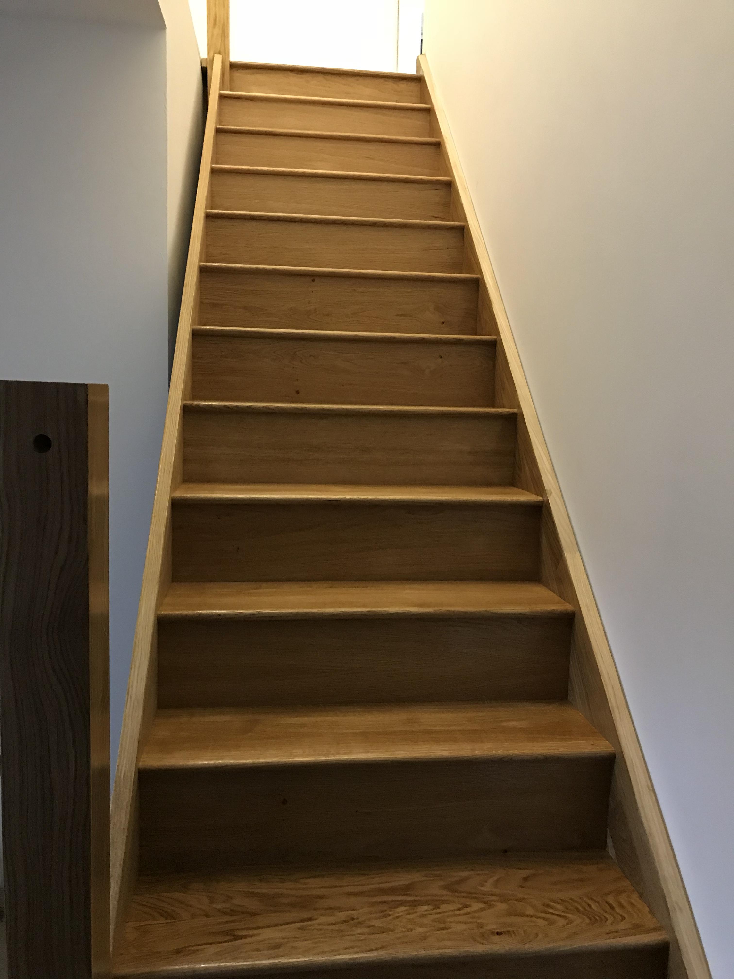

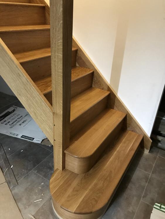

Stones Posted October 5, 2017 Posted October 5, 2017 + another 1 for Osmo polyx clear satin. Lightly sanded before application, and deburred between coats. Picture of our stairs after application, oak treads, pine stringers and risers. As other have said, it's proving very hard wearing.

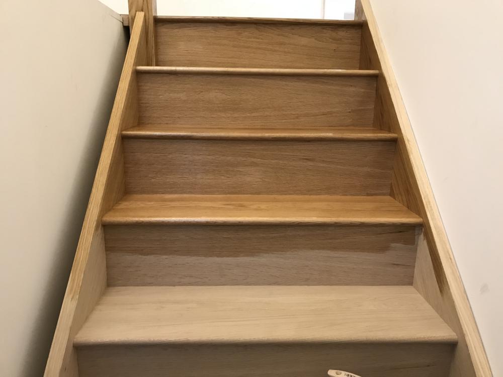

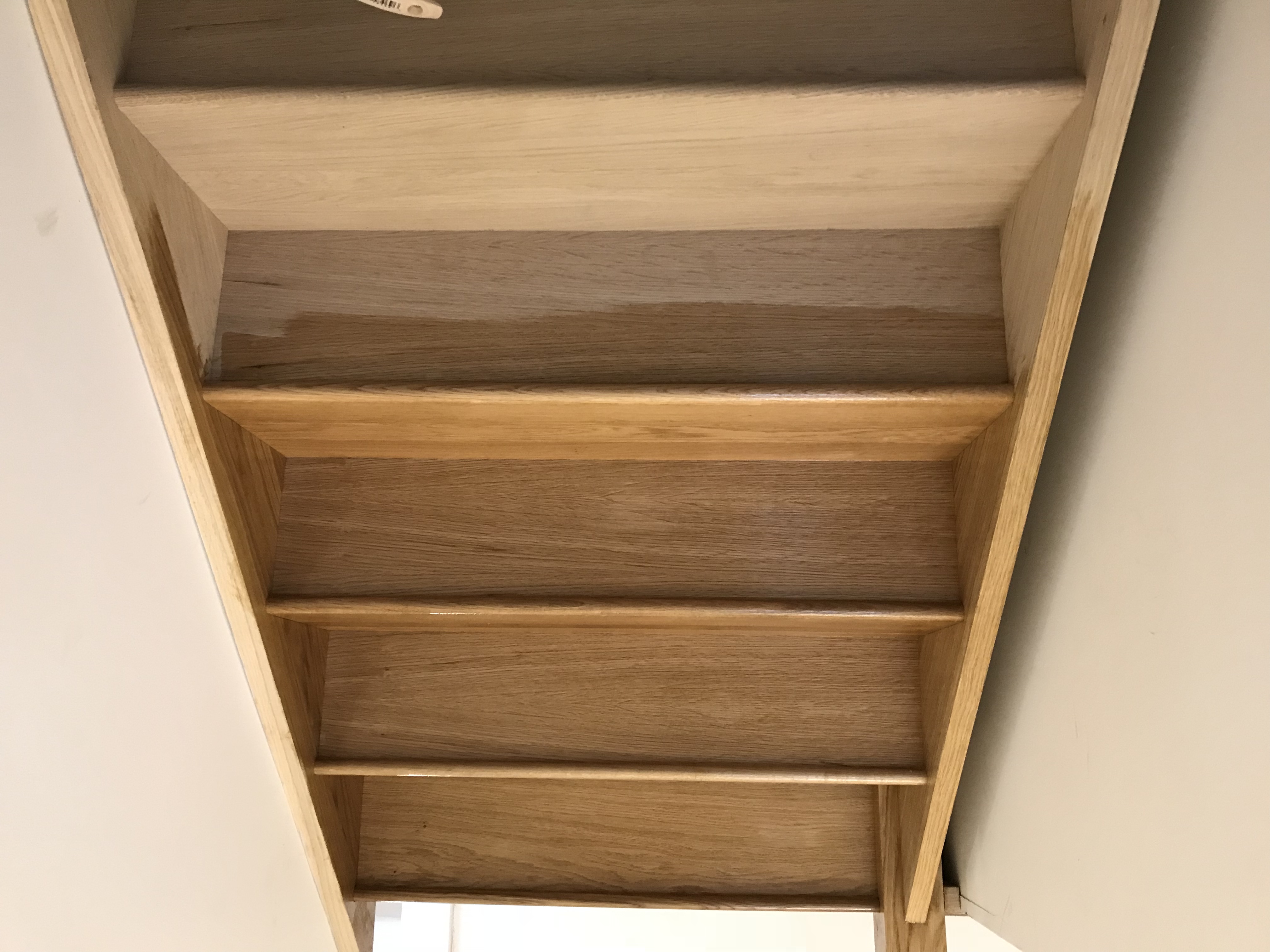

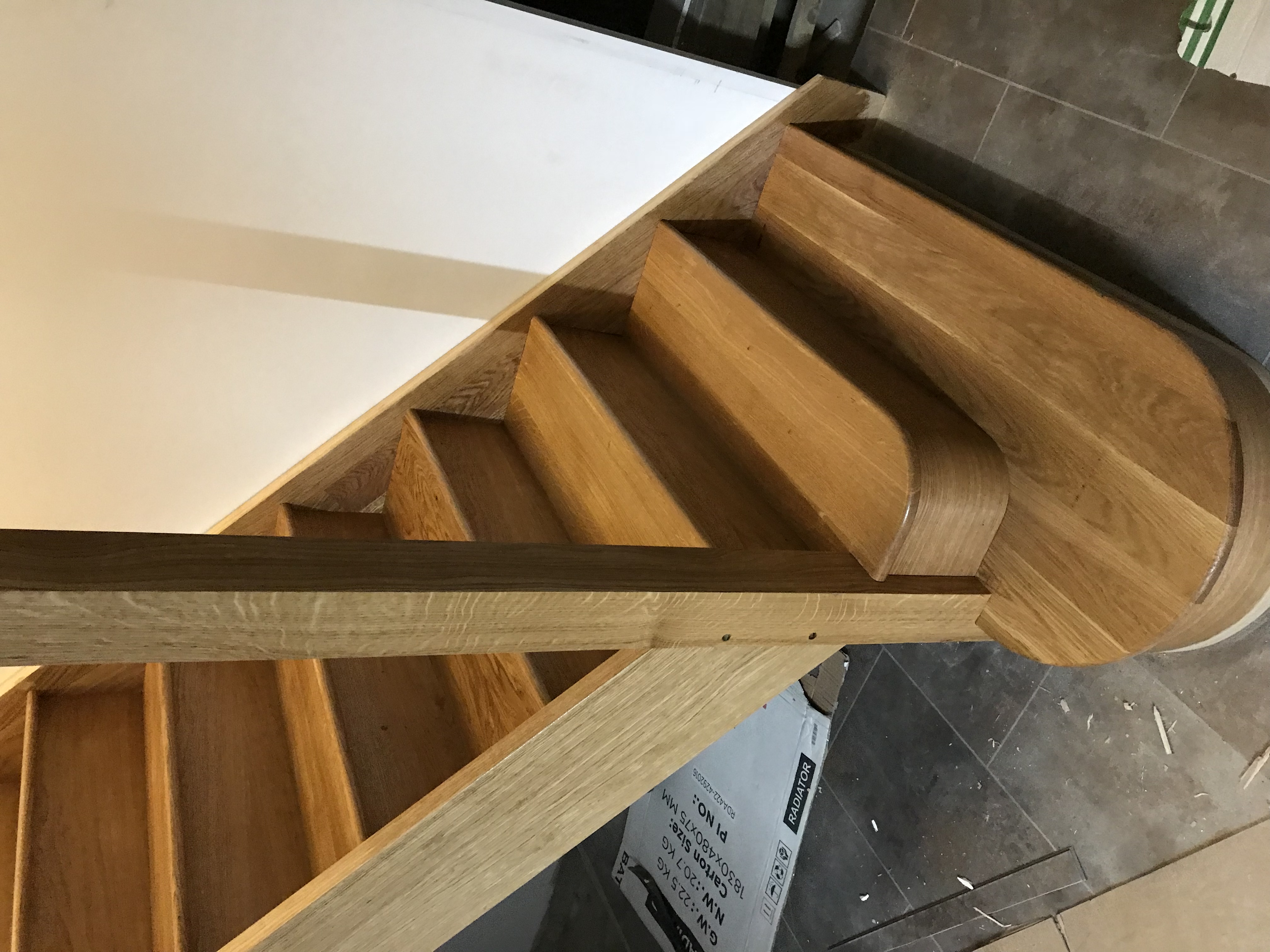

Grosey Posted October 5, 2017 Author Posted October 5, 2017 Thanks all for the advice, first coat done tonight. A bit honey-like and very wet looking currently... but then it is still wet! I love how it’s brought out the grain though, will give a light sand and another coat tomorrow night. 1
Redoctober Posted October 5, 2017 Posted October 5, 2017 33 minutes ago, Grosey said: Thanks all for the advice, first coat done tonight. A bit honey-like and very wet looking currently... but then it is still wet! I love how it’s brought out the grain though, will give a light sand and another coat tomorrow night. Have to say @Grosey that's a lovely looking staircase. Is that a bespoke staircase or from a company? PW.
Grosey Posted October 5, 2017 Author Posted October 5, 2017 Thank you, it’s from Stairbox - I’ve made a few comments about them in various different stair threads on here, can’t remember the specific posts but a search for “Stairbox” should bring them up. Im very happy with them and I’ll post more photos when the second flight are up, hopefully tomorrow. Looking forward to getting the handrails and glass in place also.
