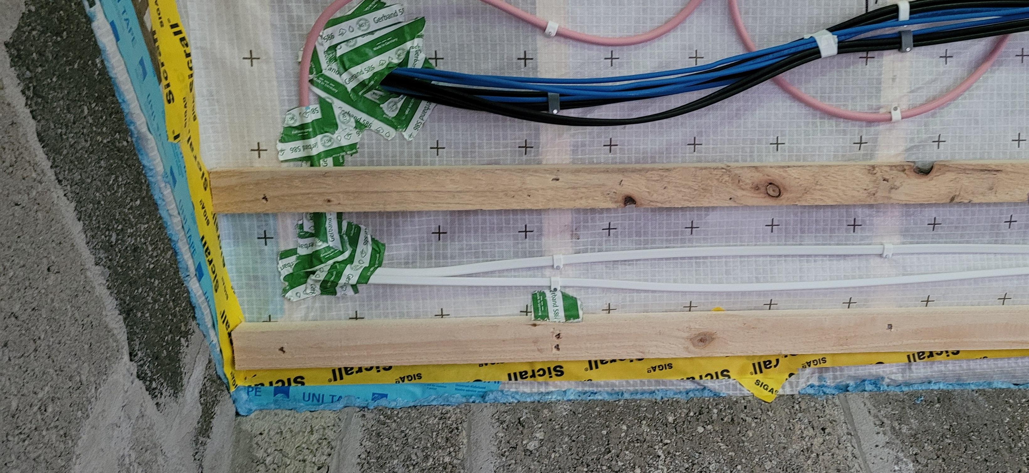

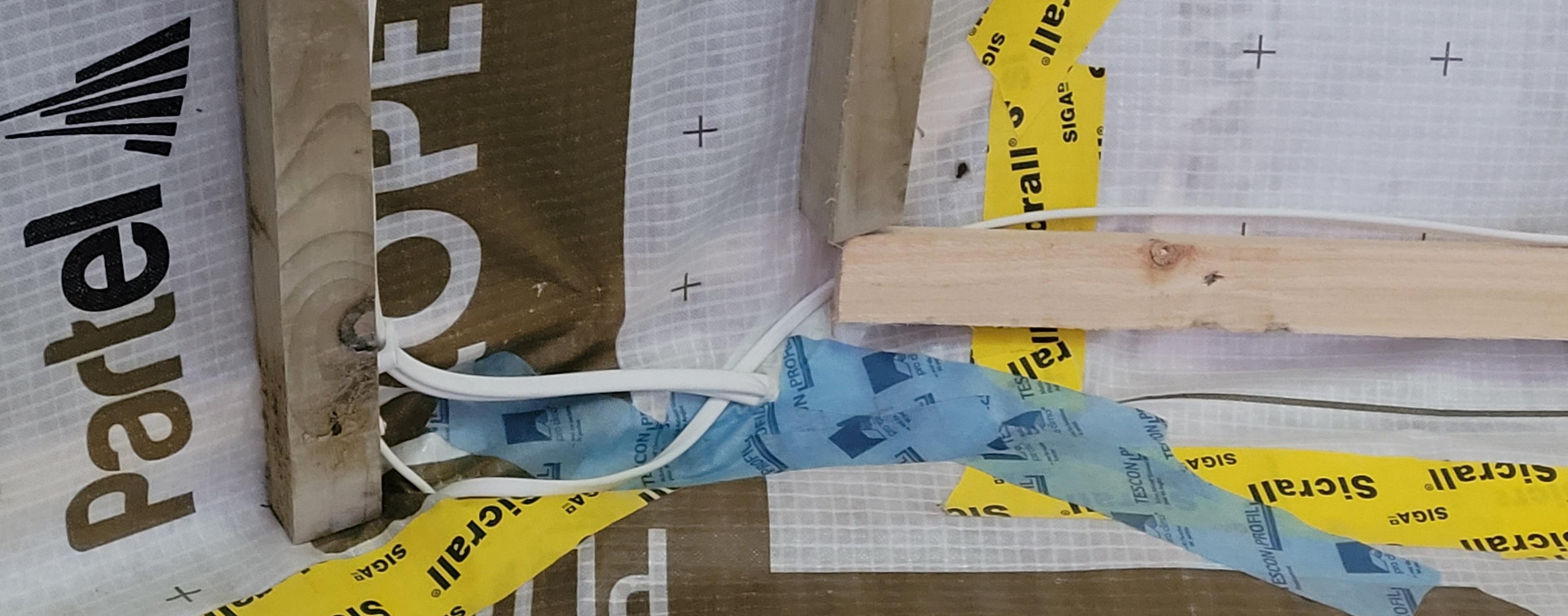

Redbeard Posted March 13, 2024 Posted March 13, 2024 Oh dear! You are not alone, though. Ideally the spark would have used purpose-made cable grommets. Would you have room to separate the cables and cut a square out of the membrane? Get a piece of EPDM (rubber roofing) bigger all round than the square you have cut out and drill holes a good distance apart for the number of cables you have, each hole slightly undersized for the cable. Then make a cut from each hole to the edges of the EPDM square and tuck the cables in. Then get short lengths of air-tightness tape and tape round each cable to the membrane. Finally, use air-tightness tape to tape the EPDM square into the hole in the membrane. 1

Redbeard Posted March 13, 2024 Posted March 13, 2024 You can make your own. I would not like to guarantee they would be quite as good as the proprietary ones, but I have had some success. Basically EPDM, as many holes as you need, and air-tightness tape around the perimeter. 1

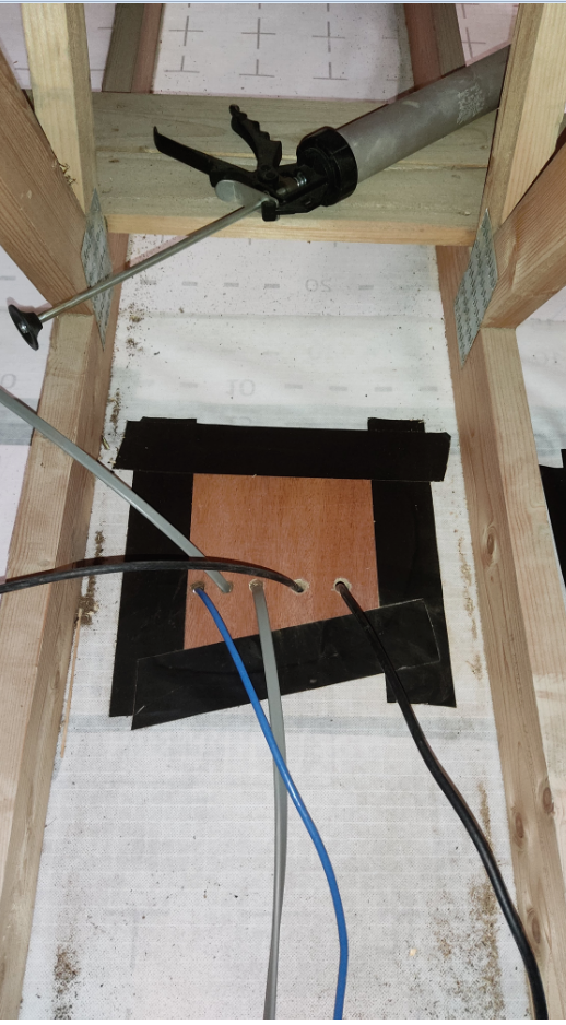

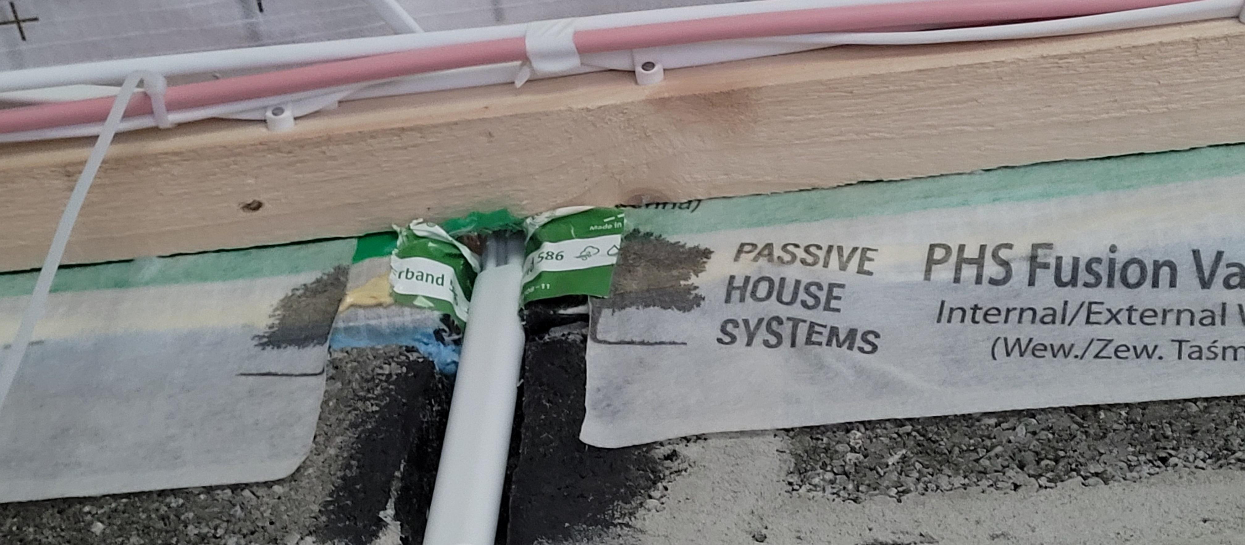

Iceverge Posted March 14, 2024 Posted March 14, 2024 14 hours ago, WisteriaMews said: I'm not quite at the stage yet to plan the cables on my self build, but puncturing the airtight membrane is something I've half started to think about. Do you have any tips on how to avoid them? As I said I've not given it serious thought, but mains electric, connection from the solar panels and TV aerial needs to come in. Power for the outside sockets, lights, security cameras and alarm need to go back out. It's adding up to a worrying list. Plan for ZERO holes in the membrane. I did this by. 1. Running a service cavity below the membrane, making everything go in here. 2. Put plywood where ever you need to penetrate and tape the membrane to that. Use the ONE WIRE for ONE HOLE mantra. I even drilled the holes and labelled them for the electrician. 3. That left a very simple set of instructions for the electrician. Don't ever make a hole in the membrane, only in the ply. ONE WIRE per ONE HOLE If there's any accidental holes just tell me. There will be no bollockings, no scolding, no problem. Just tell me and I'll fix it. 3

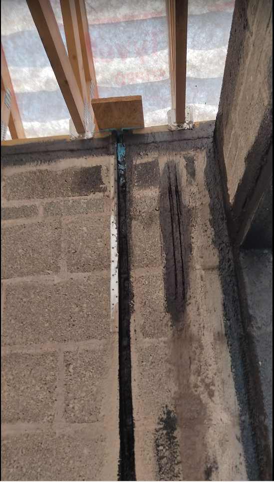

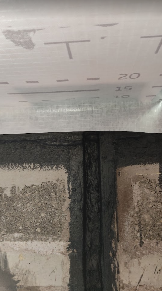

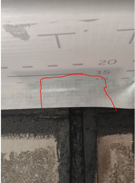

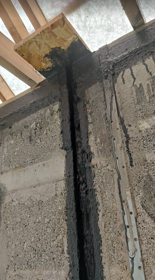

Iceverge Posted March 14, 2024 Posted March 14, 2024 Here's how I did the top of the conduits as membrane is almost impossible to seal into the corner. Continue the chase up through the wall plate. Screw a square of OSB down from the top and seal with airtight paint. Then run the membrane down the wall under the square of OSB. Seal to the wall everywhere with airtight sealant. Cut back the membrane as shown and seal to the OSB with airtight tape. That leave the electrician plenty of space to take the conduit above the level of the plasterboard and bend the wires into the service cavity without any need to go near the membrane. 1
Redbeard Posted March 14, 2024 Posted March 14, 2024 23 minutes ago, Iceverge said: That's a nightmare. Sorry to see it. However not terminal. Nothing ever is. My thoughts entirely. 9 minutes ago, Iceverge said: ONE WIRE per ONE HOLE I am assuming the wiring is pretty well done and that it is far too late to disconnect cables and run them thro' grommets as should have been done. Therefore, as per @Iceverge's mantra above, separate out those bunches, get some OSB/ply behind if you can (as it's a darn sight easier to stick to something which doesn't move away from you!) and do the 'split grommet'/tape idea which I described above. *for each separate cable*. 14 hours ago, Kelvin said: Pro Clima also do a butyl seal tape that I found to be a great product for harder areas as you can form it to shape. I have never used Pro Clima's butyl but still have some Pavatex butyl tape I use when necessary. It takes bends better than standard a/t tape, though Tescon ('cloth') tape is pretty forgiving. It is very tedious but do not despair. By the time you have 50% of those holes done it will feel like it's all downhill (in a positive way!) from there. And +1 to the DIY 'blower door' idea. That's on my list of things to make too. Best of luck. 1

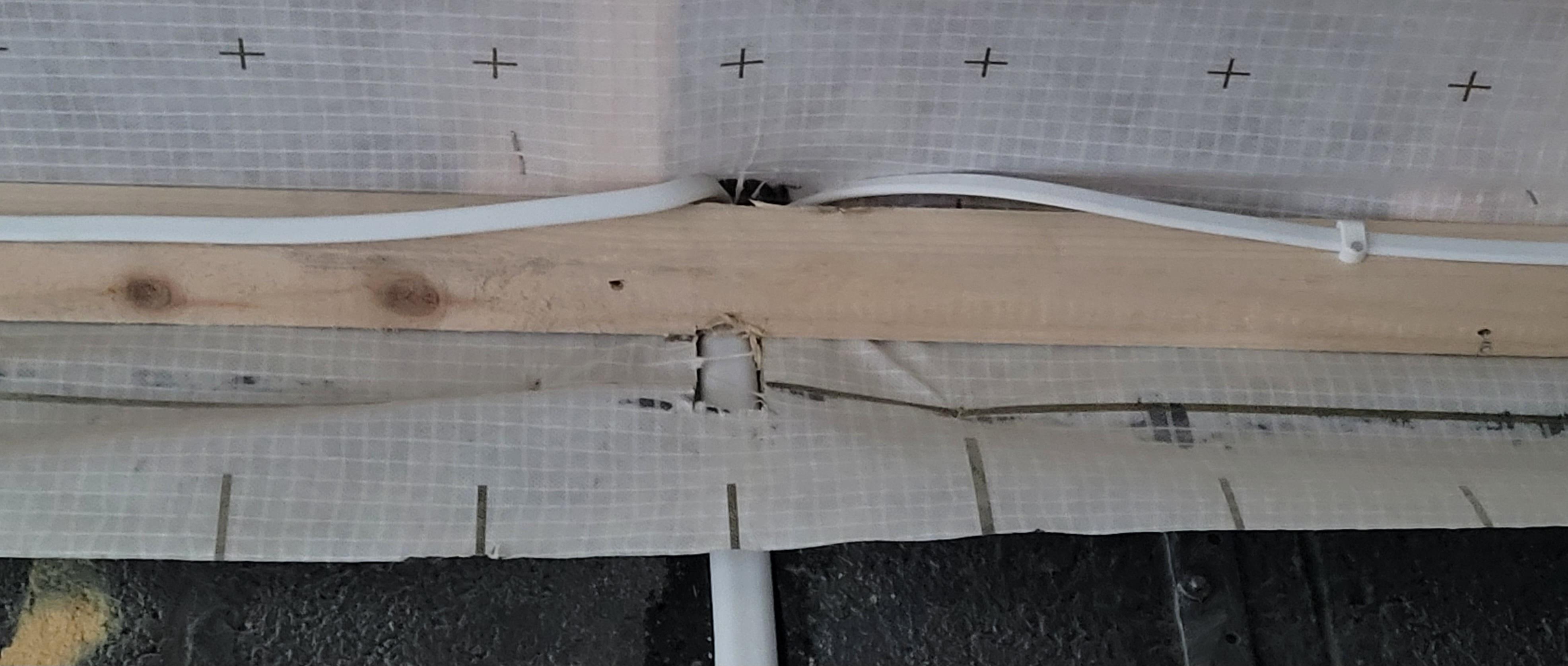

Iceverge Posted March 14, 2024 Posted March 14, 2024 Here's how I did the wires into the attic. The pic is taken looking down from above. A scrap trapezoidal piece of ply screwed to the trusses from below. The membrane cut back and tapes to the ply. It doesn't need to be pretty but it needs to be neat and effective. ONE WIRE for ONE HOLE. No expensive grommets needed, just a squirt of airtight sealant from both sides. The sausage gun can be seen. Note there's plenty of space between the holes. 1
