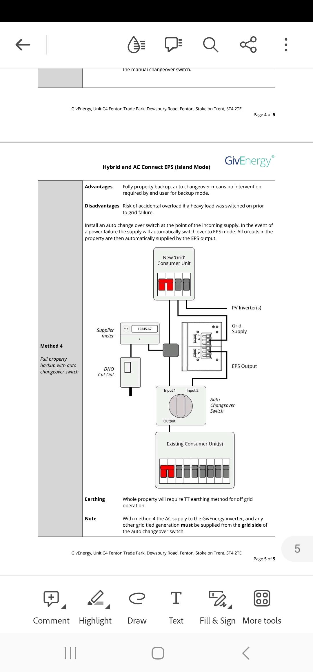

SuperJohnG Posted March 12 Share Posted March 12 I know what you mean, Givenergy instructions give you the pros and cons. E.g. Doc also attached. EPS Configuration v2.pdf Link to comment Share on other sites More sharing options...

Dan21 Posted March 13 Author Share Posted March 13 OK, I get that, but that would mean you only have limited power, say to a power socket, if you want the whole house to work you have to disconnect the incoming main with an ATS or a manual one. Link to comment Share on other sites More sharing options...
ProDave Posted March 13 Share Posted March 13 33 minutes ago, Dan21 said: OK, I get that, but that would mean you only have limited power, say to a power socket, if you want the whole house to work you have to disconnect the incoming main with an ATS or a manual one. And it still would not produce any power as it has no grid to synchronise to. You are just limited to the low power UPS output. Link to comment Share on other sites More sharing options...

SuperJohnG Posted March 13 Share Posted March 13 10 hours ago, ProDave said: And it still would not produce any power as it has no grid to synchronise to. You are just limited to the low power UPS output. It will via the battery. It's also limited by the battery output and storage, its not necessary a low power only output. Link to comment Share on other sites More sharing options...
Dillsue Posted March 14 Share Posted March 14 20 hours ago, Dan21 said: Is there no way around this? I believe there's plenty of systems that will island the house and give several kw of power to the house. I've no personal experience but beleive tesla powerwall does it using their gateway, solaredge now support whole house backup and I think there's lots of others. Whatever you do make sure is certified for UK grid connection and from a reputable manufacturerer- you don't want to be powering the grid when a linesman is trying to fix a fault! Link to comment Share on other sites More sharing options...
