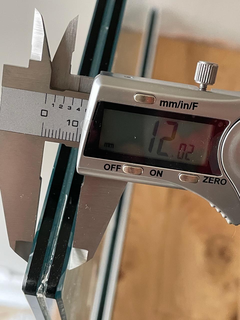

Thorfun Posted March 10, 2024 Posted March 10, 2024 I know it's a strange question but I'm just checking. fitting our balustrades today and the stickers and order form and fittings are all for 13.5mm toughened glass but things weren't going as smoothly as I thought they would and so I thought I'd just measure the glass just in case and it's 12mm thick! so I'm thinking they sent the wrong stuff but maybe it's like wood where 4" x 2" is not actually those dimensions.

bassanclan Posted March 10, 2024 Posted March 10, 2024 Just had a quick google. Your picture is toughened and laminated glass. It seems that 6mm glass + 2mm plastic + 6mm glass makes a piece of glass 12.5-13.5mm thick
Thorfun Posted March 10, 2024 Author Posted March 10, 2024 (edited) 7 minutes ago, bassanclan said: Just had a quick google. Your picture is toughened and laminated glass. It seems that 6mm glass + 2mm plastic + 6mm glass makes a piece of glass 12.5-13.5mm thick it's supposed to be 6/4/6 afaik. Edited March 10, 2024 by Thorfun
bassanclan Posted March 11, 2024 Posted March 11, 2024 Maybe worth measuring as best you can the thickness of each pane of glass. From your photo it looks more like 5+2+5 which would make sense with 12.02 overall thickness
Thorfun Posted March 11, 2024 Author Posted March 11, 2024 1 hour ago, bassanclan said: Maybe worth measuring as best you can the thickness of each pane of glass. From your photo it looks more like 5+2+5 which would make sense with 12.02 overall thickness Yep. I measured a couple of them. One 12.02mm and another 12.09mm. The wife will be speaking to the company today. 1
Thorfun Posted March 11, 2024 Author Posted March 11, 2024 Someone screwed the pooch on this one. Company have gone back to the glass manufacturer and told them to redo the glass to the correct specifications. I think someone is in trouble as that’s not going to be cheap. i’m so glad I noticed as that could’ve been a massive safety issue. lesson learnt to never trust the manufacturer sticker!! 2

craig Posted March 12, 2024 Posted March 12, 2024 (edited) 3 hours ago, SteamyTea said: Where is @craig when he is wanted. He will know right away. Yes, 2 x 6mm glass panes and lamination 1.5mm (easiest way to explain), 13.5mm overall - that glass unit is laminated. Edited March 12, 2024 by craig 2
