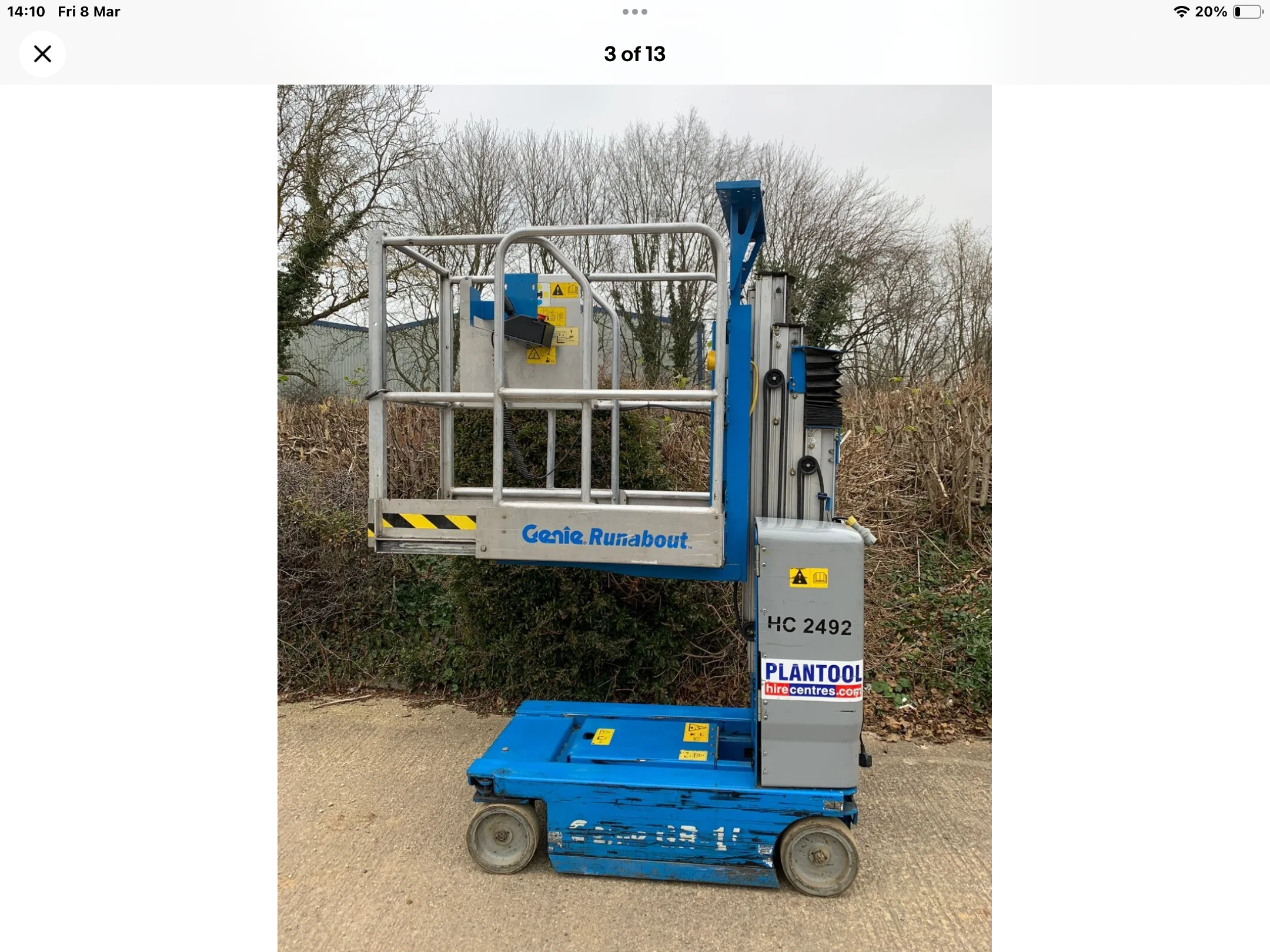

Russell griffiths Posted March 8, 2024 Share Posted March 8, 2024 (edited) Just looked up the one I had genie 150. working height 6m weight 1000kg. straight up n down lift no slew. Edited March 8, 2024 by Russell griffiths 1 Link to comment Share on other sites More sharing options...
saveasteading Posted March 8, 2024 Share Posted March 8, 2024 24 minutes ago, Russell griffiths said: straight up n down lift no slew. Very small wheels for on a hard slab only. Was that ever frustrating? The sliding platform handy though. Link to comment Share on other sites More sharing options...
Russell griffiths Posted March 8, 2024 Share Posted March 8, 2024 (edited) 4 hours ago, saveasteading said: Very small wheels for on a hard slab only. Was that ever frustrating? The sliding platform handy though. Couple of sheets of plywood and I could drive it around the outside of the house. inside it rumbled around nicely on the block n beam. I even lifted a couple of 80kg windows up into place 4m up in the air with it. The windows in this pic Edited March 8, 2024 by Russell griffiths 2 Link to comment Share on other sites More sharing options...

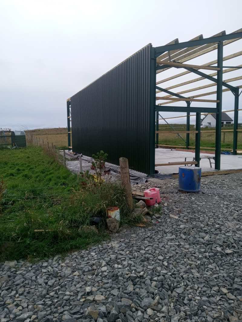

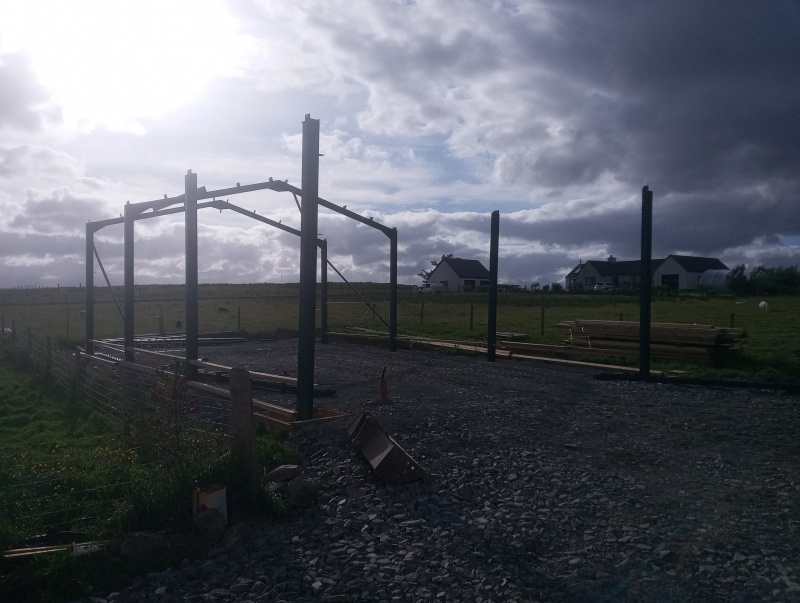

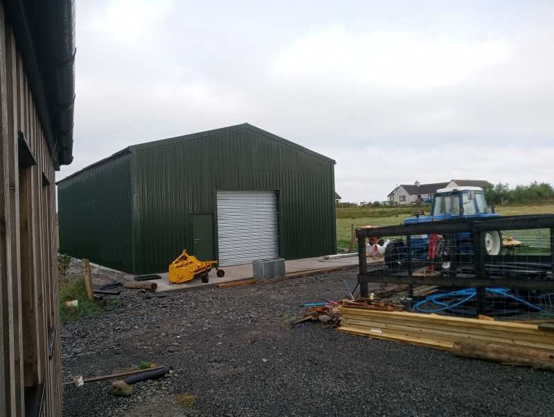

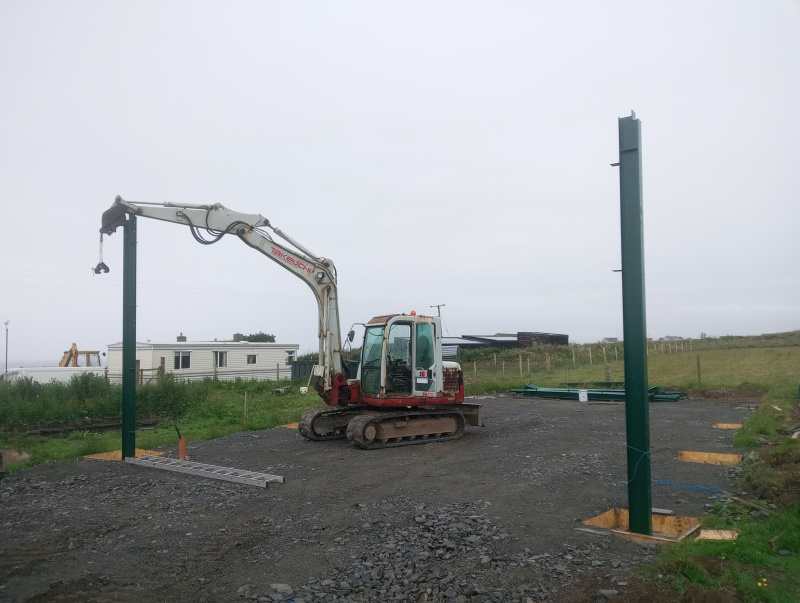

Jenki Posted September 5, 2024 Author Share Posted September 5, 2024 To get back on topic😁. I didn't have 16k to erect, so erected in an more agricultural way. (Ropes, pulleys, harness and caribeners🫣). Wind was the only issue that stopped progress of sheeting on several occasions. Just finishing the electrics, and still have a hard standing to concrete at the front. Apart from some help erecting the rafters, and some help on the last few roof sheets and gutters all this was done by Mandy and I. Not going to blog this due to the methods employed, however, at no point do I think what we were doing was dangerous. Time consuming yes, tedious yes, but primarily safe. For those interested in costs / figures. 218 tonnes of type 1 and type 2 hardcore. 32 cube of concrete. Project cost so far £27k with about 8 cube more concrete needed. 3 Link to comment Share on other sites More sharing options...
saveasteading Posted September 5, 2024 Share Posted September 5, 2024 1 hour ago, Jenki said: To get back on topic😁 I said 28 man days for skilled erectors, without cladding. Ie 4 x 7 days. You? Link to comment Share on other sites More sharing options...
Jenki Posted September 5, 2024 Author Share Posted September 5, 2024 1 hour ago, saveasteading said: I said 28 man days for skilled erectors, without cladding. Ie 4 x 7 days. You? @saveasteading I haven't diarised the times, but we poured the pads end of June, and started the frame July 1st. The frame was complete, purlins and 3 bays of concrete plus the plinth at the rear were complete by the end of July (we did the concrete on consecutive days, 1 bay at a time). I had to work away for a week in July, plus the local agricultural show needed setting up and stripping down plus the cabins were non stop June/July/ Aug, so mostly half days when both of us were available, plus any noisy activity was only done when our customers left so this was quite restrictive, when we had a clear window the wind would have other ideas. 1st side of cladding started 31st July We finished cladding, doors, trims and roof by the end of August. Just some lights and downpipes to finish. plus setting up my workshop, sheep pens - Oh forgot we had to cut, turn and square bail 8 acres of Hay as well. that's all sat in the field waiting for some dry weather to bring it into the barn. 1 Link to comment Share on other sites More sharing options...

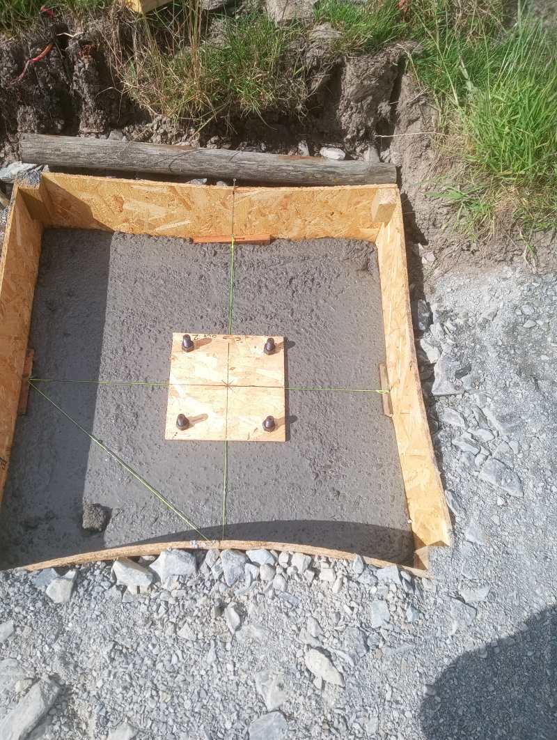

saveasteading Posted September 5, 2024 Share Posted September 5, 2024 (edited) Are the base plates sitting on the concrete pads, or did you shim them? That timber template for bolt positioning and casting in solid is my preferred method on bigger buildings, but I would probably have used threaded rod and epoxy on yours. Edited September 5, 2024 by saveasteading Link to comment Share on other sites More sharing options...
Jenki Posted September 5, 2024 Author Share Posted September 5, 2024 3 hours ago, saveasteading said: Are the base plates sitting on the concrete pads, or did you shim them? That timber template for bolt positioning and casting in solid is my preferred method on bigger buildings, but I would probably have used threaded rod and epoxy on yours. The pads are 1mx1mx 300mm min deep sat on rock, I framed the boxes and filled around with stone to get my level base. I set the top of the forms all level to the bottom of the slab, then just filled the boxes 200mm below that level and inserted the bolts. The bolts and cones came part of the kit. I didn't fancy resin due to the unpredictable wind. The legs were 200mm longer.so I shimmed if needed to get plumb, then when I poured the rear external slab, I filled the boxes at the same time. So the plates are sandwiched in a min of 1/2 cube. As a note, The frame came from South Wales, way cheaper than I could get anywhere up here. I think the croft grant scheme inflates the local prices. Link to comment Share on other sites More sharing options...
