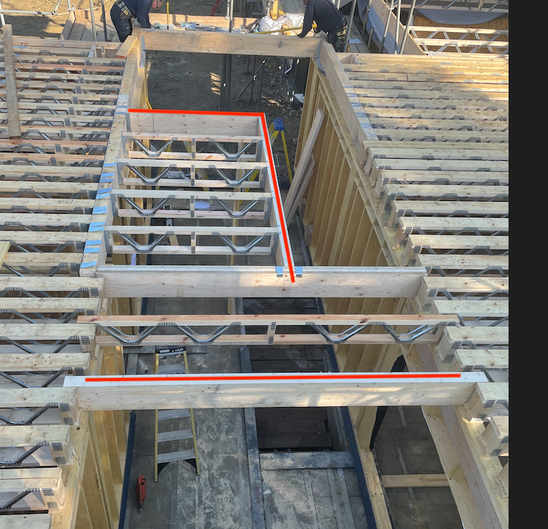

Thorfun Posted February 26, 2024 Author Posted February 26, 2024 (edited) 17 minutes ago, joe90 said: @Thorfun what’s the makeup of the wall you’re fixing too ?,(depth of timber, insulation?’ some timberlok screws only have threads at the end, you need thread the whole depth of the wood IMO to give max security, also how much room in the channel do you have after the glass is fixed? Fixing straight down in to 90mm x 304mm glulams. Was planning on using M10 x 100mm coach screws. I’m not near the profile at the moment but the fixing holes are approximately 300mm apart. plenty of room above the fixing hole for a hex head. here’s the tech spec if you’re interested Edited February 26, 2024 by Thorfun
Thorfun Posted February 26, 2024 Author Posted February 26, 2024 Edit: Fixed straight down through 22mm chipboard flooring in to the timbers.
Thorfun Posted February 26, 2024 Author Posted February 26, 2024 Additional information: red lines show where the channels will be and the timbers they’re going in to. 1

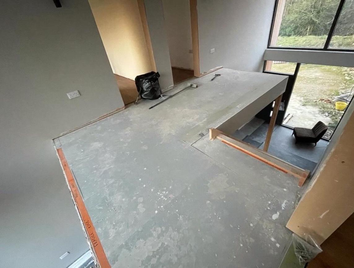

Thorfun Posted February 26, 2024 Author Posted February 26, 2024 Here’s how it is with the 22mm chipboard flooring

saveasteading Posted February 26, 2024 Posted February 26, 2024 1 hour ago, Thorfun said: structural integrity of the timbers. Don't worry about that. Timber is good for this, and Glulam especially so. More important is to drill a very neat hole so that the thread bites into the sides of it. Then when you are screwing it in, you are cutting h threads into the timber and not trying to force it. I cant recall calculating for balustrades. I did though for a basketball net fixed into a timber backing. Think 2 x 2m athletes hanging from it. Coach screws worked fine. I got a couple of hefty guys to hang off it too. The other weakness might be the screw head bursting through an aluminium frame that is being forced. Hence big heads and washers will spread the load. The photos are great help as well as interesting. Very tidy. Is the nearer glulam spiked into the adjacent floor to give it stability?
