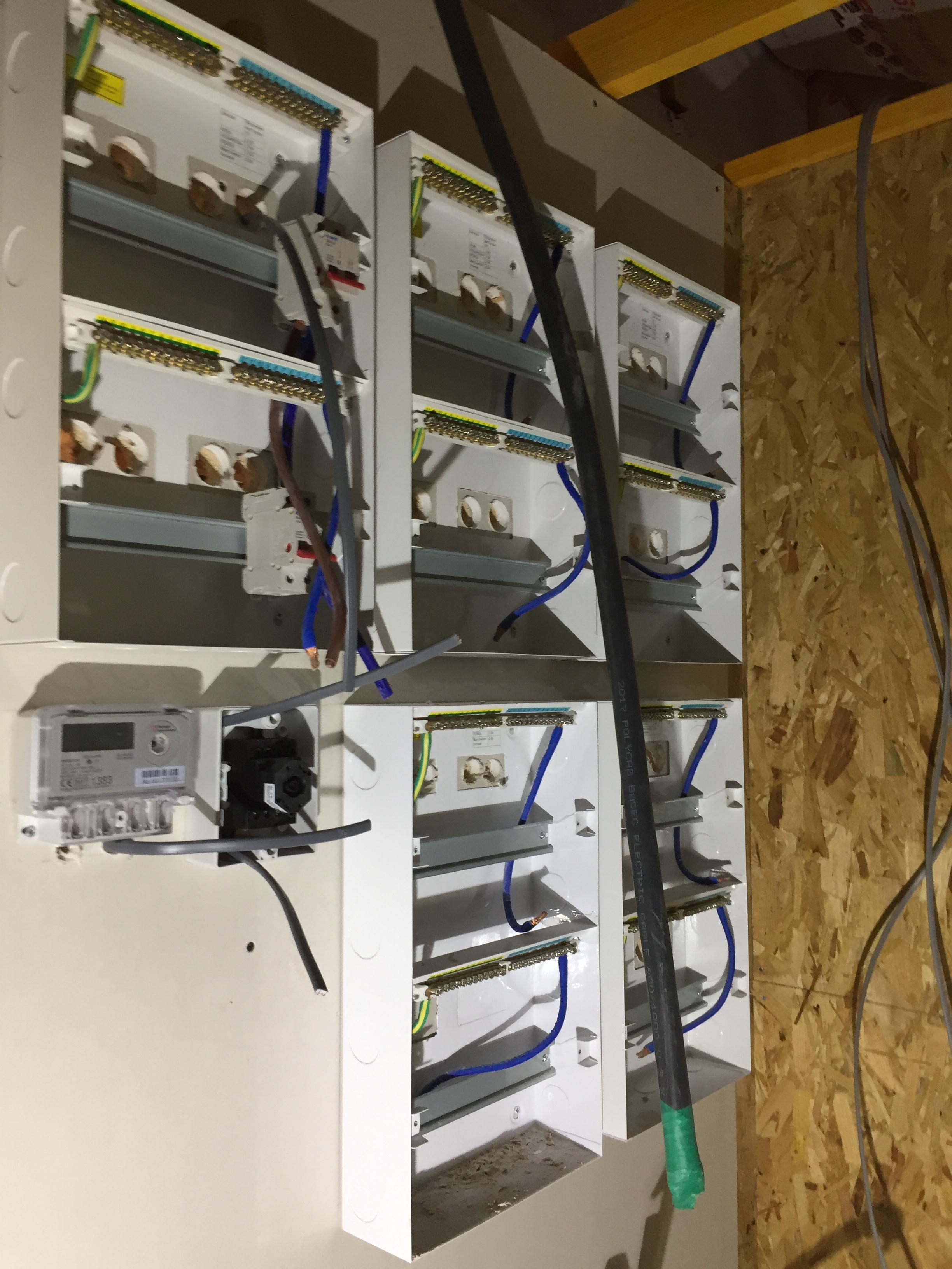

Barney12 Posted September 28, 2017 Posted September 28, 2017 I've got a fused switch at the meter (located on an outside wall). Then SWA from there into the house. Power went live in the house yesterday! Solar connected too. Just the small matter now of connecting up 20 odd radial circuits and 30 odd lighting loads into the FIVE consumer units 1

ProDave Posted September 29, 2017 Posted September 29, 2017 12 hours ago, Barney12 said: I've got a fused switch at the meter (located on an outside wall). Then SWA from there into the house. Power went live in the house yesterday! Solar connected too. Just the small matter now of connecting up 20 odd radial circuits and 30 odd lighting loads into the FIVE consumer units You appear to have 5 double deck CU's, each probably with the capacity for a very minimum of 20 circuits, so that's 100 circuits available. Talk about "room for future expansion" I have seen industrial units with smaller distribution boards. I assume there is access to the other side of that wall still otherwise how will you get the cables into them?
Barney12 Posted September 29, 2017 Posted September 29, 2017 36 minutes ago, ProDave said: You appear to have 5 double deck CU's, each probably with the capacity for a very minimum of 20 circuits, so that's 100 circuits available. Talk about "room for future expansion" I have seen industrial units with smaller distribution boards. I assume there is access to the other side of that wall still otherwise how will you get the cables into them? Yep CU1: 20 RCBO loads CU2: CBUS 8 Ch Dimmer (12 DIN Ways) and 8 MCB's for each load CU3: CBUS 12way relay (12 DIN Ways) and 12 MCB's for each load CU4: CBUS 12way relay (12 DIN Ways) and 12 MCB's for each load CU5: CBUS Controllers/Inputs and a bit of expansion room. Here's a prebuilt unit (not what I've bought) that gives you the idea: https://www.laser.com/product_info.php/item/ART_PB_Dimmer-8ch-Pre_Built_8_channel_dimmer_L5508D1A_enclosure/cPath/168_266/products_id/1687 The metal CU's and RCBO's were from LiVE. The sparks were impressed with them.https://www.liveelectrical.co.uk/ They commented that the boards and RCBO's looked completely identical to Denmans own brand units. Yes, the other side is a cloaks cupboard. Well that's if I don't turn it into a AV cupboard

ProDave Posted September 29, 2017 Posted September 29, 2017 21 minutes ago, Barney12 said: Yep CU1: 20 RCBO loads CU2: CBUS 8 Ch Dimmer (12 DIN Ways) and 8 MCB's for each load CU3: CBUS 12way relay (12 DIN Ways) and 12 MCB's for each load CU4: CBUS 12way relay (12 DIN Ways) and 12 MCB's for each load CU5: CBUS Controllers/Inputs and a bit of expansion room. Here's a prebuilt unit (not what I've bought) that gives you the idea: https://www.laser.com/product_info.php/item/ART_PB_Dimmer-8ch-Pre_Built_8_channel_dimmer_L5508D1A_enclosure/cPath/168_266/products_id/1687 The metal CU's and RCBO's were from LiVE. The sparks were impressed with them.https://www.liveelectrical.co.uk/ They commented that the boards and RCBO's looked completely identical to Denmans own brand units. Yes, the other side is a cloaks cupboard. Well that's if I don't turn it into a AV cupboard That would blow my usual "1 hour per point" estimate right out of the water. Has your electrician tried SBS Trade sales, he sells the Live range of stuff and does some pretty good custom stuff, but strictly trade only?
Barney12 Posted September 29, 2017 Posted September 29, 2017 5 minutes ago, ProDave said: That would blow my usual "1 hour per point" estimate right out of the water. Has your electrician tried SBS Trade sales, he sells the Live range of stuff and does some pretty good custom stuff, but strictly trade only? Thats why I went to a different distro who was happy to supply me. My sparky is labour only. He's also happy for me to do all the first fix grunt. I've known him for a good while and he trusts my workmanship.
