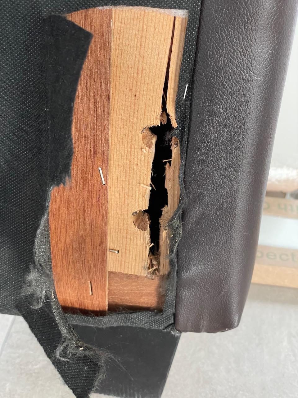

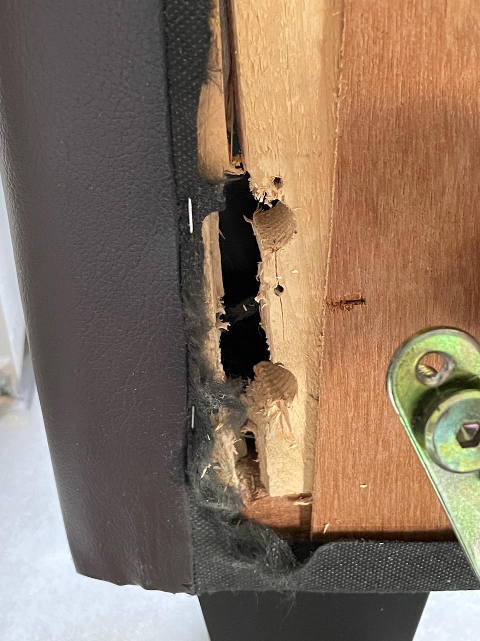

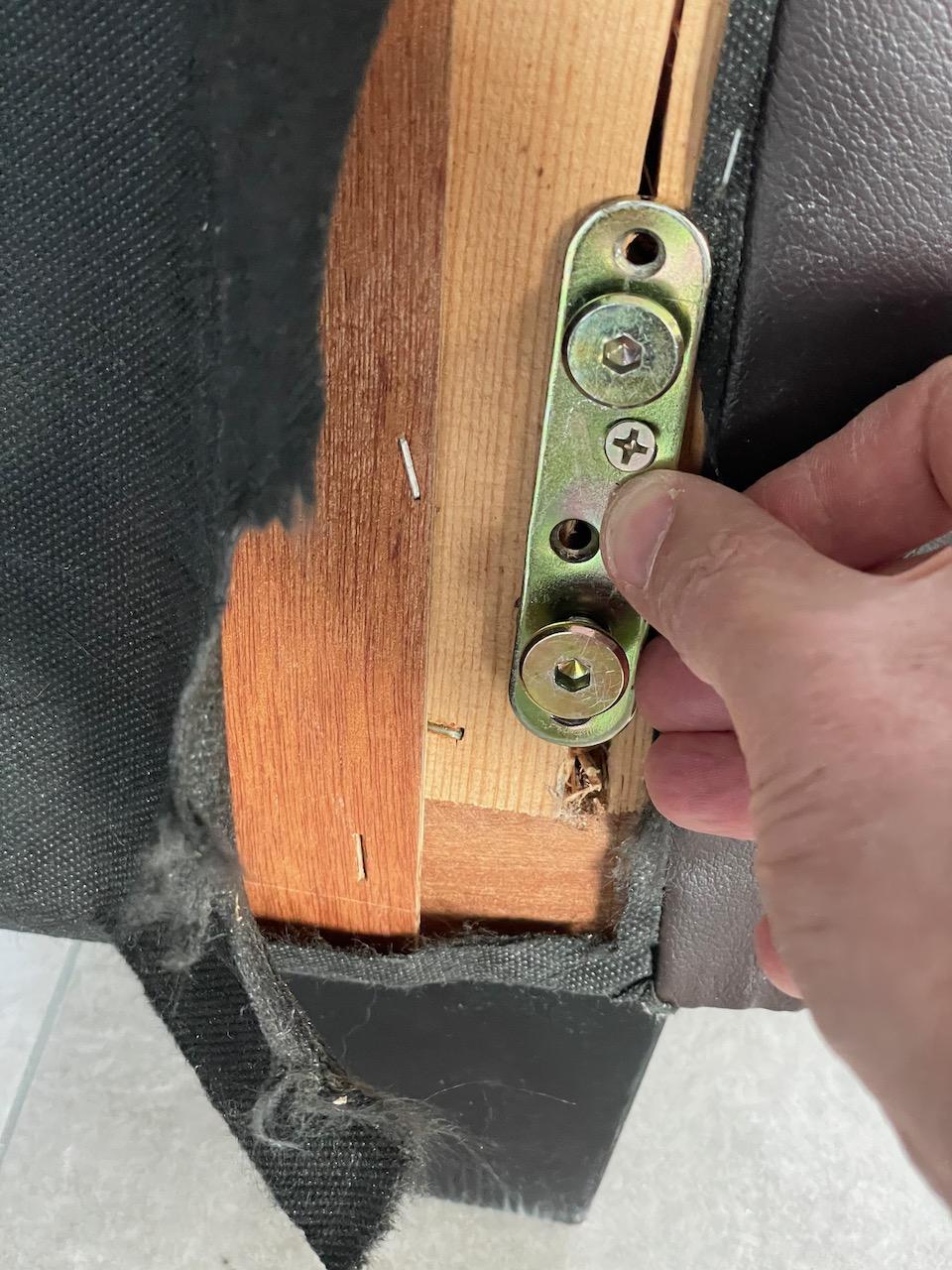

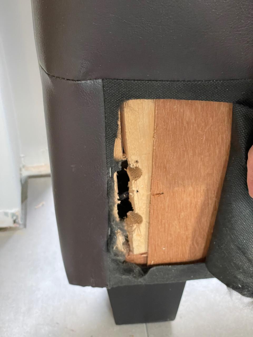

Thorfun Posted February 11, 2024 Posted February 11, 2024 we picked up a bed off the local Facebook group for free for one of our teenagers but it's broken where the side bits attach to the headboard. the wood that the bolt plate screws in to is split. here's some photos. what's the best/easiest way to fix this? I was wondering if there was some kind of resin product that I could inject in to the gap which would allow holes to be drilled for the bolts and could be screwed in to. anyone know of such a product or have any other amazing ideas on how best to fix this please?
ProDave Posted February 11, 2024 Posted February 11, 2024 If you can get the material covering off, I would splice a new section of wood in the damaged location. At least it won't have to be matching wood if you can get the material back on again to cover it. 1
Thorfun Posted February 11, 2024 Author Posted February 11, 2024 On 11/02/2024 at 18:53, ProDave said: If you can get the material covering off, I would splice a new section of wood in the damaged location. At least it won't have to be matching wood if you can get the material back on again to cover it. Expand yeah. I know that's the 'best' way to do it but that means re-upholstering part of the bed where the faux-leather is to the left of the damaged section. I was hoping that would be the last resort! the wife is a dab hand at needlework and stuff but if there was an 'easier' solution I'd rather that! but will definitely consider the new piece of wood route if nothing else comes to mind.

Pendicle Posted February 12, 2024 Posted February 12, 2024 I have used epoxy putty to repair wooden props or furniture pieces, it’s good for jobs where a resin is too fluid for the job and I can’t mask up so the resin would leak before drying. I have been able to screw into once dry but my theatre props and furniture are only being used for a limited amount of time so have not tested in a permanent situation. Although can’t see why it wouldn’t. 1

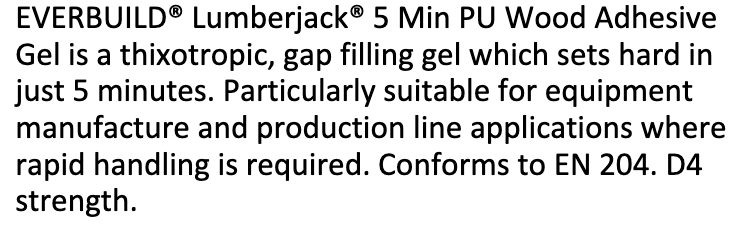

Thorfun Posted February 12, 2024 Author Posted February 12, 2024 On 12/02/2024 at 07:47, SteamyTea said: Lumberjack PU adhesive Glue and clamp. Expand thanks. seems to be exactly what we need but not sure how we can clamp, it's a double bed so the clamp would need to be rather large!
Blooda Posted February 12, 2024 Posted February 12, 2024 Probably over the top but... DeWalt DFC1330000 Polyester Styrene-Free Chemical Anchor Resin 300ml - Screwfix or Ronseal High Performance Wood Filler White 550g - Screwfix To fill the gaps If you have access to a pillar drill and some thin [1 or 2mm thick will do] Mild steel, make a couple of mending plates. on for each side to even up. 1

Thorfun Posted February 20, 2024 Author Posted February 20, 2024 ended up buying this https://www.toolstation.com/toupret-wood-repair-filler/p10260 and it seems to have done the job. screws holding nicely. 1
