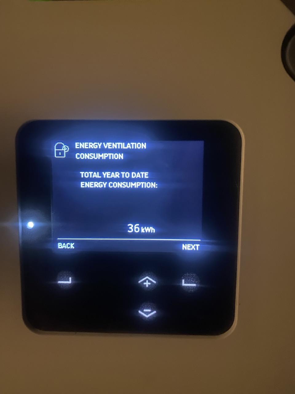

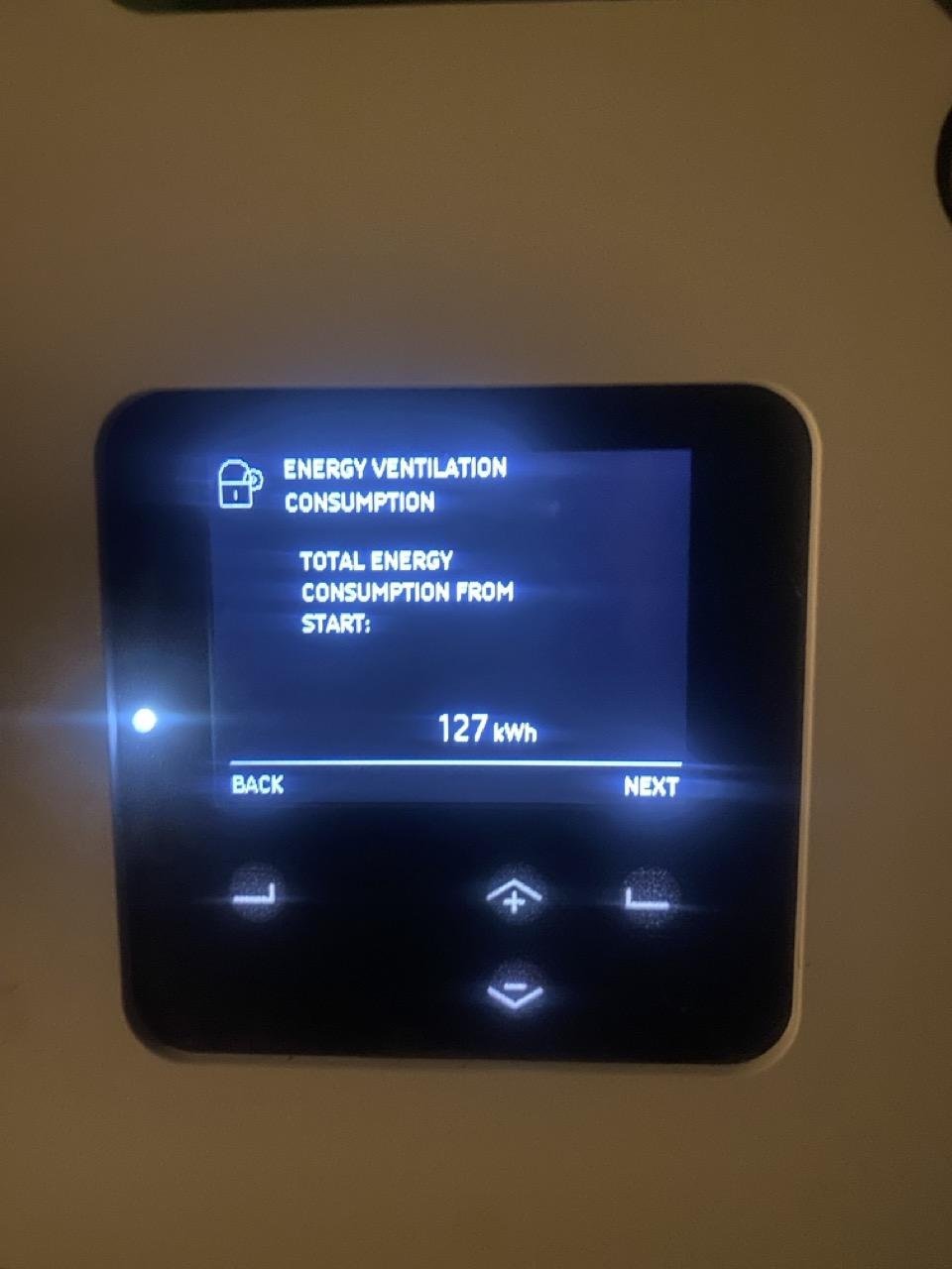

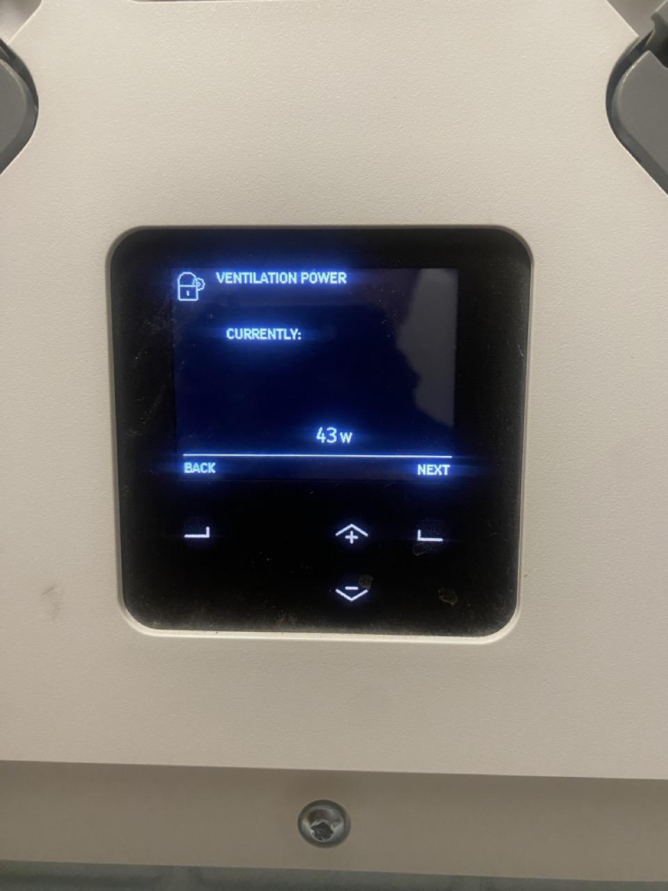

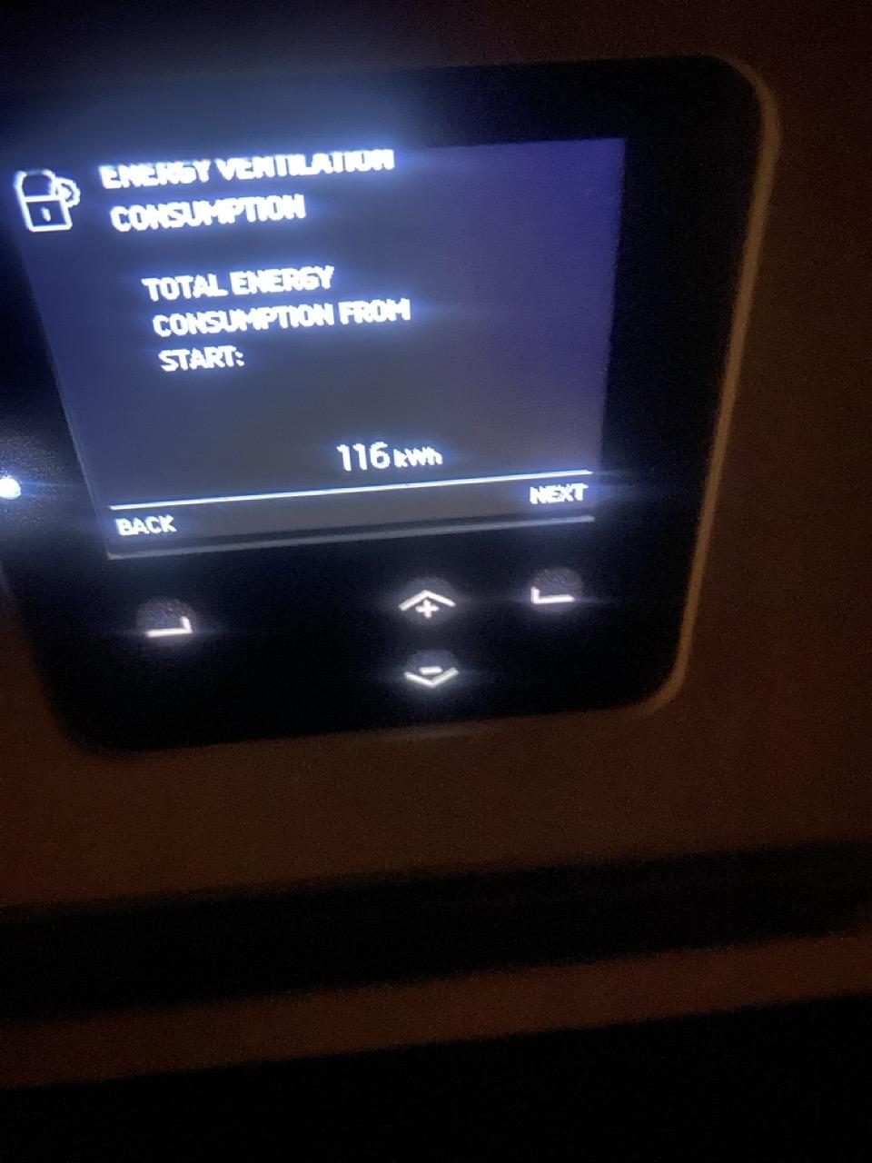

MPH243 Posted February 7 Share Posted February 7 Yes I have the lan C module which was part of the package. It is very good but I did just see how much it is. Just out off interest can you check the usage on the units so we know there usage it is in menu, status and energy also the l/s flow rate. I think your energy use is because the ashp is short cycling with the smaller circuits, I have gone to 1 thermostat as 1 room would call for heat first but did not have enough volume in the system so kept cutting in and out. I only realised because I was outside doing something next to it and it kept cutting in and out. It was using more electric but I can't remember how much. I also have a 8.5kw ecodan. Link to comment Share on other sites More sharing options...

Carpe Diem Posted February 10 Author Share Posted February 10 On 07/02/2024 at 20:41, MPH243 said: Yes I have the lan C module which was part of the package. It is very good but I did just see how much it is. Just out off interest can you check the usage on the units so we know there usage it is in menu, status and energy also the l/s flow rate. I think your energy use is because the ashp is short cycling with the smaller circuits, I have gone to 1 thermostat as 1 room would call for heat first but did not have enough volume in the system so kept cutting in and out. I only realised because I was outside doing something next to it and it kept cutting in and out. It was using more electric but I can't remember how much. I also have a 8.5kw ecodan. I have 2 x Q350's. Currently, they both have 43w being used. Year to date 36kWh. The usage is pretty low compared to what the ASHP is using. Link to comment Share on other sites More sharing options...
MPH243 Posted February 10 Share Posted February 10 That's good at least you know it's not using 130+w each that was mentioned before. It maybe be that like @Conor said and twerk that zone down a bit so it is not coming on so much. Link to comment Share on other sites More sharing options...
