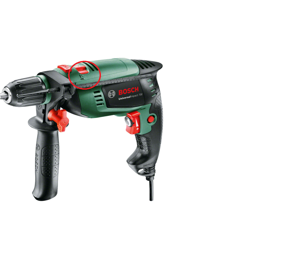

Garald Posted February 6, 2024 Posted February 6, 2024 So, armed with a metal and electricity detector, I discovered that my worst enemy had been fear: I can now drill holes in walls! At first, it all went well. I think here I'm just drilling through sound insulation boards put on the walls separating me from the cabinet of the GP who is never there. Now, however, I'm trying to drill holes to put a coat rack closer to the wall, and I am stumped. In this section, there seem to be two materials: one is easily drillable up to 2cm or so (but holes bored in it seem to become larger); the other one cannot be drilled beyond a few mm. What is the reason? What to do?

Garald Posted February 6, 2024 Author Posted February 6, 2024 (edited) 27 minutes ago, ToughButterCup said: Your drill is an SDS (Slotted Drive Shaft, or SDS +) drill , and the drill bit is SDS rated ? And the drill is set on hammer ? And the drill bit is new, and clean? Uh... my drill is an ordinary Bosch Universalimpact 700W; not sure it has a hammer mode. (I can't find a clear answer online. There is a switch on the top part of the drill, but it's just for switching between screwing screws and drilling.) It's my first time hearing of SDS. I was just using a standard Bosch masonry drill (nearly new though not that clean). Edited February 6, 2024 by Garald
Jenki Posted February 6, 2024 Posted February 6, 2024 Is this the drill ? It has hammer mode. Make sure you buy "quality" Masonry drill bits... and it should drill thought most materials up to 10mm no problem 1
Garald Posted February 6, 2024 Author Posted February 6, 2024 (edited) Right, that's the drill. Ah, I suppose I have always been using hammer mode, even to drill through wood; I've used the other mode only to drive screws into wood. Is that bad? I've been using Bosch drill bits- I thought they were quality? At any rate, you can see my results in the above. Edited February 6, 2024 by Garald
saveasteading Posted February 6, 2024 Posted February 6, 2024 (edited) 1 hour ago, Garald said: Bosch drill bits- I thought they were quality Bosch is one of the reliable brands so that isn't the problem.. I think you may have reached structural concrete or a lump of something very hard. Have you tried different speeds? Fastest is not best. Also don't push to hard as it reduces the banging effect. Failing that, buy or borrow or hire an SDS drill. this isn't especially expensive, but good sds bits cost much more than poor ones. An sds drill bit rattles loosely in the drill and so chips rather than scrapes at the material. And/or try a different type of bit. Tungsten heads sometimes work better on hard materials. Or there are diamond bits, readily available at the merchants. Edited February 6, 2024 by saveasteading
Garald Posted February 6, 2024 Author Posted February 6, 2024 Ah, I was in non-hammer mode all along (and that was enough when I was drilling through wood or plaster). And I already filled the holes I made with plaster! Darn. Is that enough to explain my troubles? Yes, this is a structural wall, either brick or concrete. I've always started slow (speed 1 or at most 2) simply because I'm a bit frightened of what I could do at high speeds (to give you an idea, I don't drive).

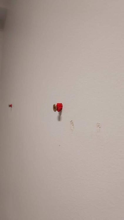

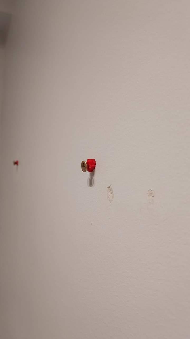

Garald Posted February 6, 2024 Author Posted February 6, 2024 (edited) 6 hours ago, SteamyTea said: Not really as it is an electronic speed controller. When drilling masonry, you are really chiselling it, unlike drilling an elastic material like steel. You really won't come to any harm with a 700W drill and a 7mm drill bit and n 100 year old brick. Victory! Switched to hammer drill mode, used a 4mm drill bit, then a 8mm drill bit, and went all the way in. (At some point I hit a void - probably air inside brick.) No idea why the plugs won't go all the way in. Should I have drilled a second time with the 8mm bit? (That was the recommended size for the plugs, and that's my largest bit.) Also, is it best (as a friend has just told me) to drill at a slight angle downwards? At any rate, I'm surprised and happy, and may let it be for now. Edited February 6, 2024 by Garald 1
