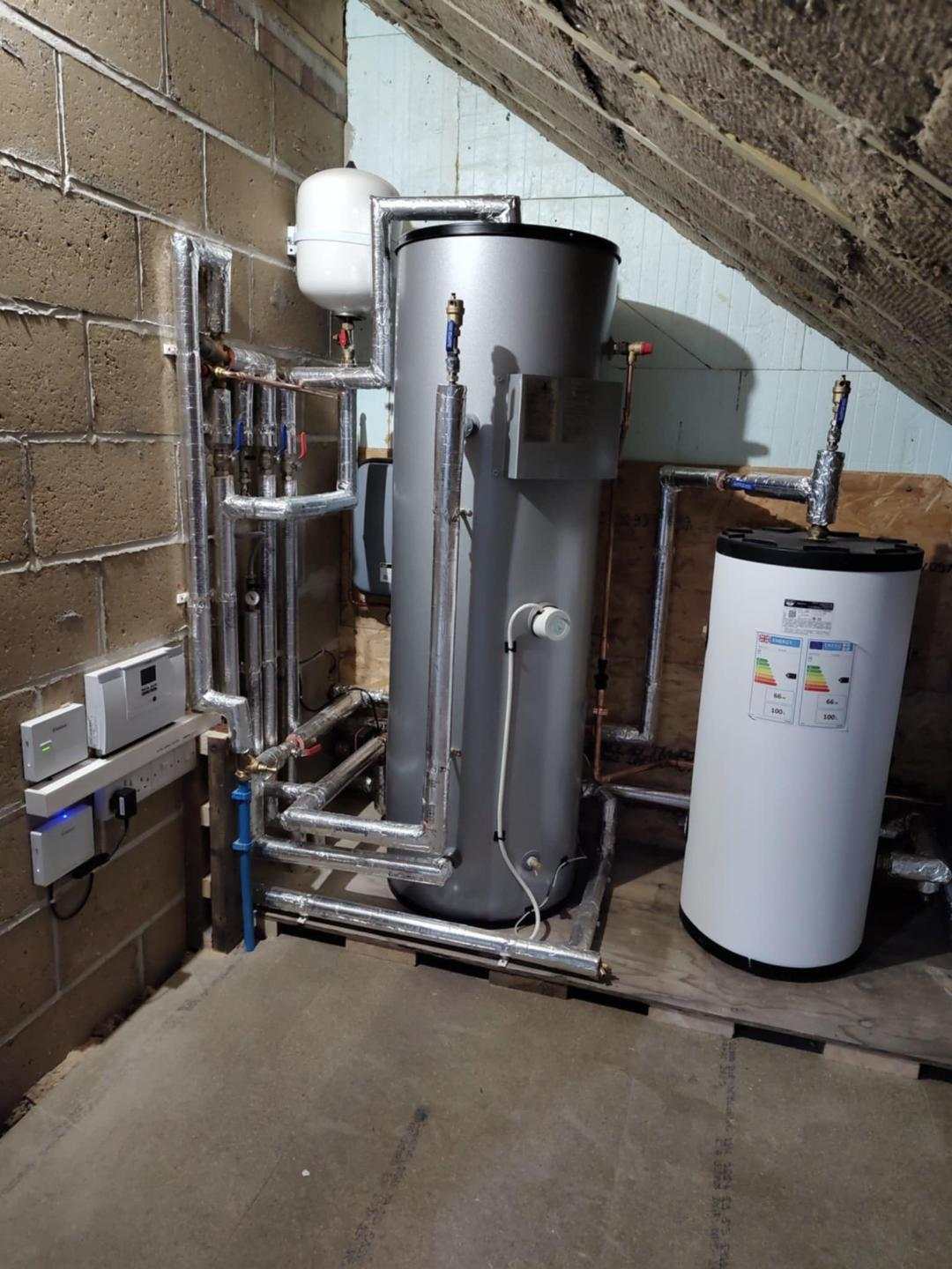

bradders3109 Posted March 8, 2025 Posted March 8, 2025 Just read through the thread to update myself and much of the discussion is a bit above my pay grade.🤔 Back to the heat geek install. We have open loop UFH. Everything run from the Heat Pump with no additional circulation pumps. Weather Compensation active and Heat Curve set to 0.25. Desired temp set to 20 degrees. The good Heat Geek agreed to honour the original quote of £11,054 for the install. Prior to commissioning in early Feb we had very high humidity in the original solid wall part of the house and lots of condensation issues. These have now disappeared and the relative humidity in that area now fluctuates between 32% and 44%. The 20 degree internal temp is rarely met by the UFH and it fluctuates between 18.5 and 19.5 degrees. As mentioned by others on the thread depending on time of day this could feel either cold or warm. When required I boost the temp by lighting the log burner which I like otherwise it would be redundant. Since commissioning the COP just for heating has been Feb 5.9 and so far in March 5.5 which I find a bit confusing since March has been warmer I would have expected a better COP? We have lived without running hot water or heating (stand fast log burner) for four years whilst we have been doing the build. This install has revolutionised our lives. The bad Some of this may be a bit picky but I've included it for completeness. The spark intended to install the heat pump isolator circuit on a type A rcd as he had with all of his previous installs. The Vaillant manual specifies a type B and anything else would invalidate the warranty according to Vaillant technical department. Following a protracted discussion a type B was installed. On day one I walked the install team around the property and explained the build to them. I informed them about the make up of Nudura part of the build, concrete core with rebar at various intervals and polyprolene web within the Nudura. I showed them where to drill in order to miss the rebar and webs. This either didn't sink in or was ignored. They hit both rebar and webs which then took an age to drill through the walls. Some of the pipework was not lagged and I had to do this myself after commissioning. The discharge from the cylinder goes into a soil pipe and the tundish should have had a dry trap seal to prevent foul smells coming back through it. This wasn't done and I've subsequently changed it myself. The condensate does not align with the installed drain and the heating wire and tundish have not been installed? I am awaiting rectification. Hot water thermostat for the cylinder was not fixed in place and loose fitted which resulted in a bit of movement and on one occasion it had fallen out of its housing. Following commissioning the installer informed me that there was a gassing issue with the pump which was causing excessive noise and defrost cycles. He instigated a visit from the Vaillant engineer. The engineer came out and said that there was nothing wrong with the pump. I referred this to Heat Geek and they have decided that there "Heat Geek Elite" installer was wrong and the pump is fine. The concerns I had about the high cost of sundries was perhaps unfounded as there are more components than I expected (see picture). I should say that Heat Geek are just an umbrella organisation and as with all of these things the actual quality of the installers will vary. Disregarding the install issues we are very happy with the outcome and comfort that we now have. This is in danger of turning into war and peace so I'll leave it here. 1
JohnMo Posted March 8, 2025 Posted March 8, 2025 11 minutes ago, bradders3109 said: Since commissioning the COP just for heating has been Feb 5.9 and so far in March 5.5 which I find a bit confusing since March has been warmer I would have expected a better COP? CoP is a mix of energy use whilst running and while in standby. More standby equals lower CoP. If House temp is not working warm enough you need to adjust the WC curve up.
bradders3109 Posted March 8, 2025 Posted March 8, 2025 7 minutes ago, JohnMo said: If House temp is not working warm enough you need to adjust the WC curve up. I'm happy with the internal temp and using the burner when required. 8 minutes ago, JohnMo said: CoP is a mix of energy use whilst running and while in standby. More standby equals lower CoP. This makes sense but I'm not sure how to tell from the app if the unit is cycling more or how to resolve it for increased efficiency?

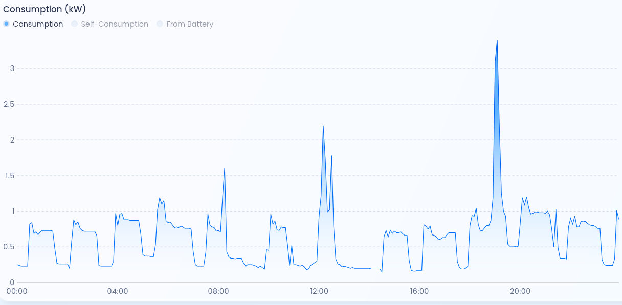

bradders3109 Posted March 8, 2025 Posted March 8, 2025 Looking at my consumption from yesterday it looks like a cycle lasts about 95 minutes with 70 minutes being on and 25 minutes being off.
SteamyTea Posted March 8, 2025 Posted March 8, 2025 17 minutes ago, bradders3109 said: Looking at my consumption from yesterday Your consumption is in kW, which is power. Your actual consumption will be the area under the graph i.e. sum of power multiplied by time.
bradders3109 Posted March 8, 2025 Posted March 8, 2025 (edited) 13 minutes ago, SteamyTea said: Your consumption is in kW, which is power. Perhaps not worded particularly well but the graph shows cycles or approx 95 minutes. Edited March 8, 2025 by bradders3109
