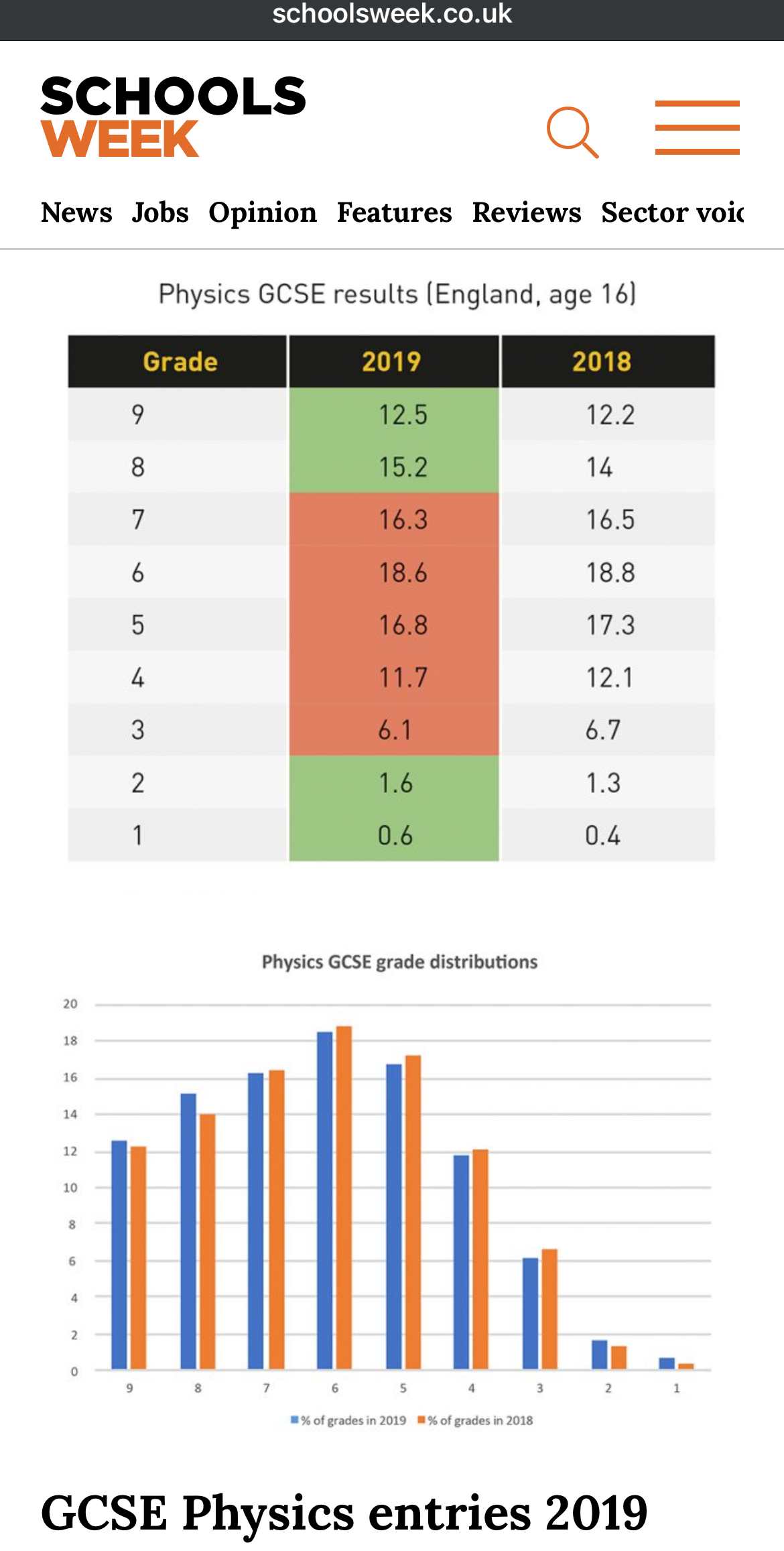

Adsibob Posted December 29, 2024 Author Posted December 29, 2024 (edited) On 28/12/2024 at 17:27, SteamyTea said: The physics/science is taught at GCSE level (remember me putting those exam papers up), so no real excuse for anyone not to understand how they work. Expand Of course there is an excuse. The education in this country is pants. Here are results for two random years (which are likely to be representative of other years given COVID hadn’t hit these results): Given c. 43% got a 7 (which I think is a C in old money), the other c. 57% of students got less than a C. A grade C isn’t even that good, given grades A*, A and B are better. When hiring a heating engineer would you prefer him to have aced his physics exam, or merely passed it? Moreover, the level of teaching is so poor in most schools with so much focus on passing exams and league tables that unless the student carries on with the subject at A-Level, for something as technical as physics, it’s usually forgotten quite quickly. Edited December 29, 2024 by Adsibob
S2D2 Posted December 29, 2024 Posted December 29, 2024 On 29/12/2024 at 18:48, Adsibob said: I’d be interested to understand why it’s more comfortable. Expand Like a smell you notice a change in temperature more, e.g. cold kitchen in the morning or radiant heat as you walk past a hot radiator. With little variance you forget the heating is on, it's just comfortable all the time so is ignored by your brain. 2
SteamyTea Posted December 29, 2024 Posted December 29, 2024 On 29/12/2024 at 19:00, Adsibob said: The education in this country is pants Expand While there are problems in education (I have been out of it for a decade now), I don't think that the basics curriculum and assessments are particularly bad, or of too low a standard. The structural lack of investment in education is the real problem, and it is not just financial investment. It goes wrong way too early in a child's learning to be put right later. It also does not stop they day you leave school. 1
