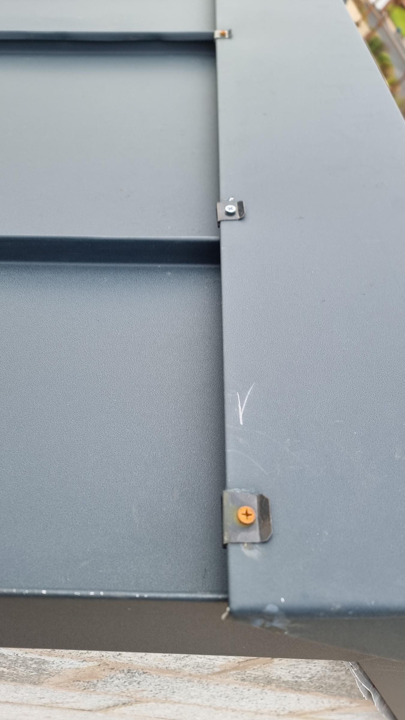

Mr Blobby Posted February 1, 2024 Posted February 1, 2024 (edited) It looks like the metal roofers wanted to save a few quid on screws when installing my very expensive metal roof. Am I right to be a bit naffed off? Edited February 1, 2024 by Mr Blobby
IanR Posted February 1, 2024 Posted February 1, 2024 Is that to hold the capping on? Is it an approved (by manufacturer) fixing method? What metal is the roof. I'd not be happy with visible fixings, or holes drilled through the coated panel, or rusting hardware.
nod Posted February 1, 2024 Posted February 1, 2024 Should be stainless fixings That will annoy the he’ll out of you

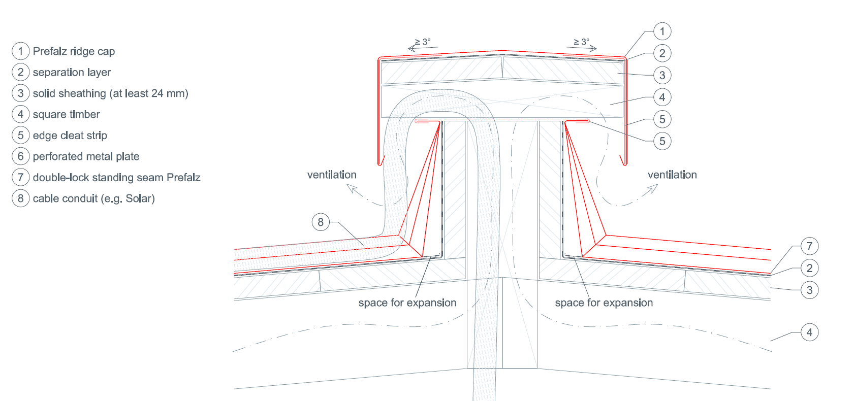

Mr Blobby Posted February 1, 2024 Author Posted February 1, 2024 7 minutes ago, IanR said: Is that to hold the capping on? The ridge vent, yes. 8 minutes ago, IanR said: What metal is the roof. Aluminium. Prefa. 17 minutes ago, IanR said: Is it an approved (by manufacturer) fixing method? I don't think so. https://uk.prefa.com/fileadmin/user_upload/_EN/Downloads/Technische_Zeichnungen/Details_Roof_PREFALZ_PREFA.pdf I'm pretty sure its not like this... 18 minutes ago, IanR said: I'd not be happy with visible fixings, or holes drilled through the coated panel, or rusting hardware. Me neither. In fairness, it's hard to see the fixings unless on the roof but I can see the rusty screws from the scaffold easy enough because of the colour difference.
Mr Blobby Posted February 1, 2024 Author Posted February 1, 2024 11 minutes ago, nod said: Should be stainless fixings That will annoy the he’ll out of you It annoys the hell out of me already. And all to save a tenner on screws. Its so obvious that screws here should be stainless that you shouldn't have to check. Which is difficult anyway. How do you know for sure if a screw is stainless before it starts rusting?

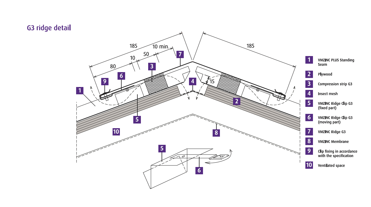

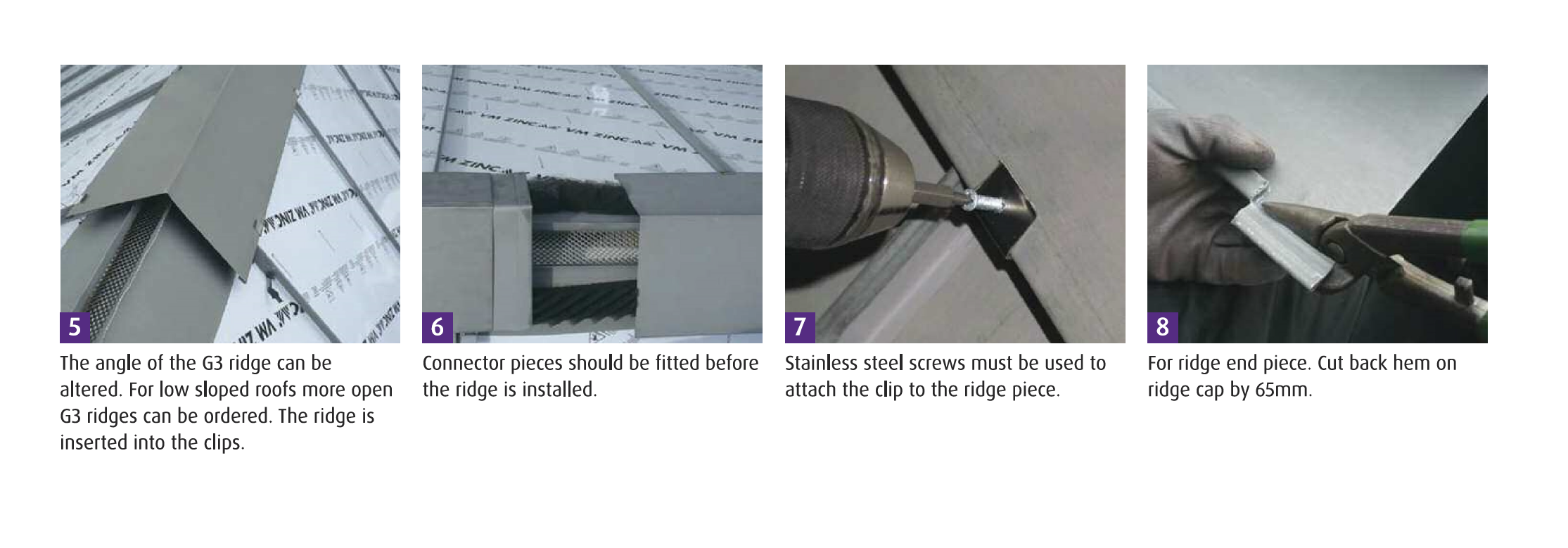

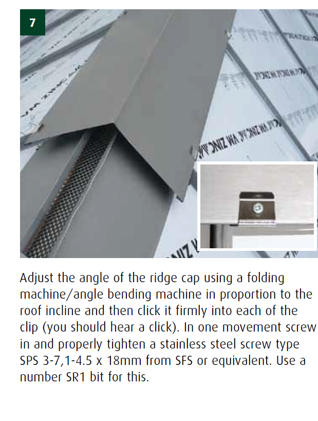

Mr Blobby Posted February 1, 2024 Author Posted February 1, 2024 (edited) So I found the ridge construction and its the G3 standard ridge construction for zinc roofs. Which I'm ok with. In theory. Looking at the G3 roof installation, I recognise this as exactly how our roof was installed. The G3 ridge detail is described very nicely here https://www.nealroofing.com/wp-content/uploads/2018/10/Ridge-Installation.pdf This is the bit I like best at square 7. Stainless Steel screws Must be used. I think our metal roofer will be replacing the screws soon. That'll learn him to try and save a few quid. Edited February 1, 2024 by Mr Blobby 1
IanR Posted February 1, 2024 Posted February 1, 2024 7 minutes ago, Mr Blobby said: This is the bit I like best.... square 7 in the directions in the link above. Stainless Steel screws Must be used. I think our metal roofer will be replacing the screws soon. It is an Approved method, although you need to confirm it's OK for Aluminium. I thought Stainless and Aluminium touching was to be avoided due to galvanic corrosion. Mine is clinched on to hidden clipping brackets.
Mr Blobby Posted February 1, 2024 Author Posted February 1, 2024 (edited) 27 minutes ago, IanR said: It is an Approved method, although you need to confirm it's OK for Aluminium. I thought Stainless and Aluminium touching was to be avoided due to galvanic corrosion. Mine is clinched on to hidden clipping brackets. You're quite right about the galvanic corrosion. What are the options here then if not stainless steel screws? Aluminium screws look like the only choice. At least it will be easy to check with a magnet if the right screws are being used 😆 I have a bad feeling that standard VMZ stainless steel clips may have been used to fix the aluminium panels. There are some spares kicking around on site to check. Interestingly enough, however, the prefa site lists stainless steel fixings for the aluminium panels. I'll email Prefa for some guidance. Edited February 1, 2024 by Mr Blobby

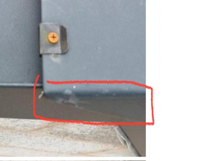

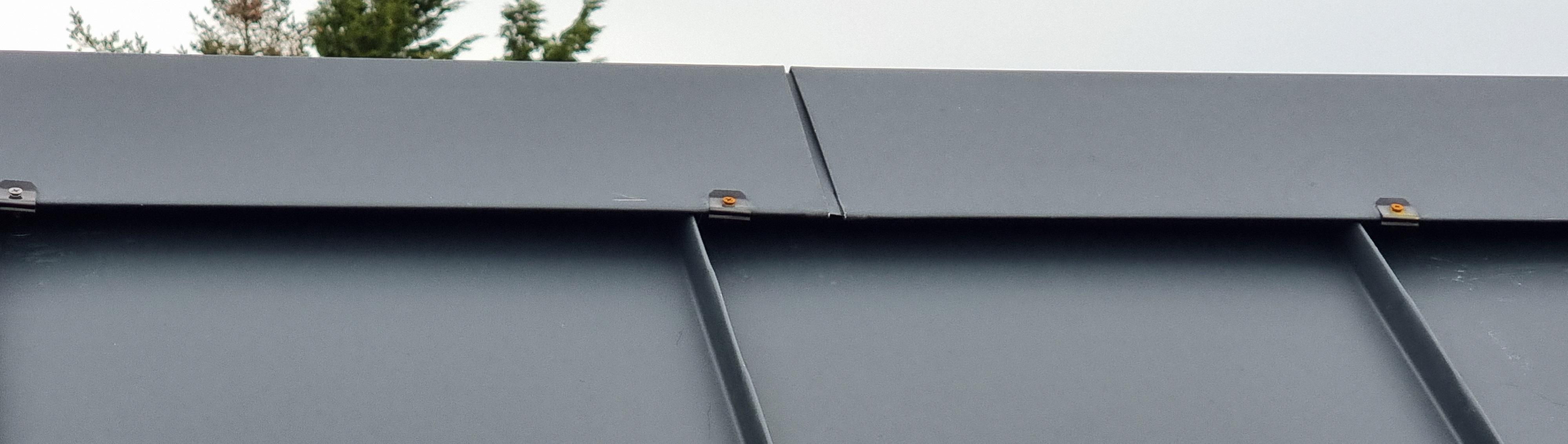

Kelvin Posted February 1, 2024 Posted February 1, 2024 You can’t see a single fixing on mine as it’s all hidden. You already have several rusty screws that will stain the roof below them so they must be the wrong type of fixings. That gap in the ridge would also annoy me.
Kelvin Posted February 1, 2024 Posted February 1, 2024 You can generally use steel fixings to fix large bits of aluminium as you see it in the car industry. However there will often be something between the fixing and the aluminium plus a substance like Duralac.
Mr Blobby Posted February 1, 2024 Author Posted February 1, 2024 (edited) 12 minutes ago, Kelvin said: You already have several rusty screws that will stain the roof below them so they must be the wrong type of fixings. That gap in the ridge would also annoy me. Agreed, definetely the wrong screws. Yes the gap in the ridge annoys me too. Totally avoidable had they tried to do it properly. Edited February 1, 2024 by Mr Blobby
saveasteading Posted February 1, 2024 Posted February 1, 2024 As well as being stainless, I'd think they should be self-tapping with a fairly large diameter or chunky thread. I'm surprised the manufacturer doesn't specify it. Also, check the centres these clips should be at. This detail is very vulnerable to wind and I'd expect fixings at 300cc or so if you don't want it to disappear some windy night.

saveasteading Posted February 1, 2024 Posted February 1, 2024 40 minutes ago, Mr Blobby said: You're quite right about the galvanic corrosion I'm assuming that the clips are steel, for strength, and the screw tightens steel to steel. The steel screw to aluminium ridge contact will be miniscule but without a washer it might get wet. A tiny washer would be ideal. A squidge of silicon would help but not long term.

Mr Blobby Posted February 1, 2024 Author Posted February 1, 2024 25 minutes ago, saveasteading said: As well as being stainless, I'd think they should be self-tapping with a fairly large diameter or chunky thread. I'm surprised the manufacturer doesn't specify it. Also, check the centres these clips should be at. This detail is very vulnerable to wind and I'd expect fixings at 300cc or so if you don't want it to disappear some windy night. On the VMzinc directions (that appear to be the way my aluminium roof was installed) there are screw details that mean nothing to me...

saveasteading Posted February 1, 2024 Posted February 1, 2024 SFS is the manufacturer, 18mm the length. The cladder can get them from any good specialist supplier ( cladding or fixing.

Mr Blobby Posted February 1, 2024 Author Posted February 1, 2024 I'm glad my scaffolding is still up 🤪 41 minutes ago, Kelvin said: What’s going on here? Damn, they could gave pushed that peice in to close that annoying gap 🤪
nod Posted February 1, 2024 Posted February 1, 2024 2 hours ago, Mr Blobby said: It annoys the hell out of me already. And all to save a tenner on screws. Its so obvious that screws here should be stainless that you shouldn't have to check. Which is difficult anyway. How do you know for sure if a screw is stainless before it starts rusting? Cost
Nestor Posted February 1, 2024 Posted February 1, 2024 Looks very similar to Tata Colorcoat Urban roof I installed myself. The ridge was fixed with the supplied colour coded rivetts at regular intervals and connector piece also had sealant applied when the ridges butted up flush. Those clips look awful and the gap in the ridge is not acceptable.
Kelvin Posted February 1, 2024 Posted February 1, 2024 It also looks badly scratched in places which shows a general lack of care when installing it. Have you paid for all of it?
