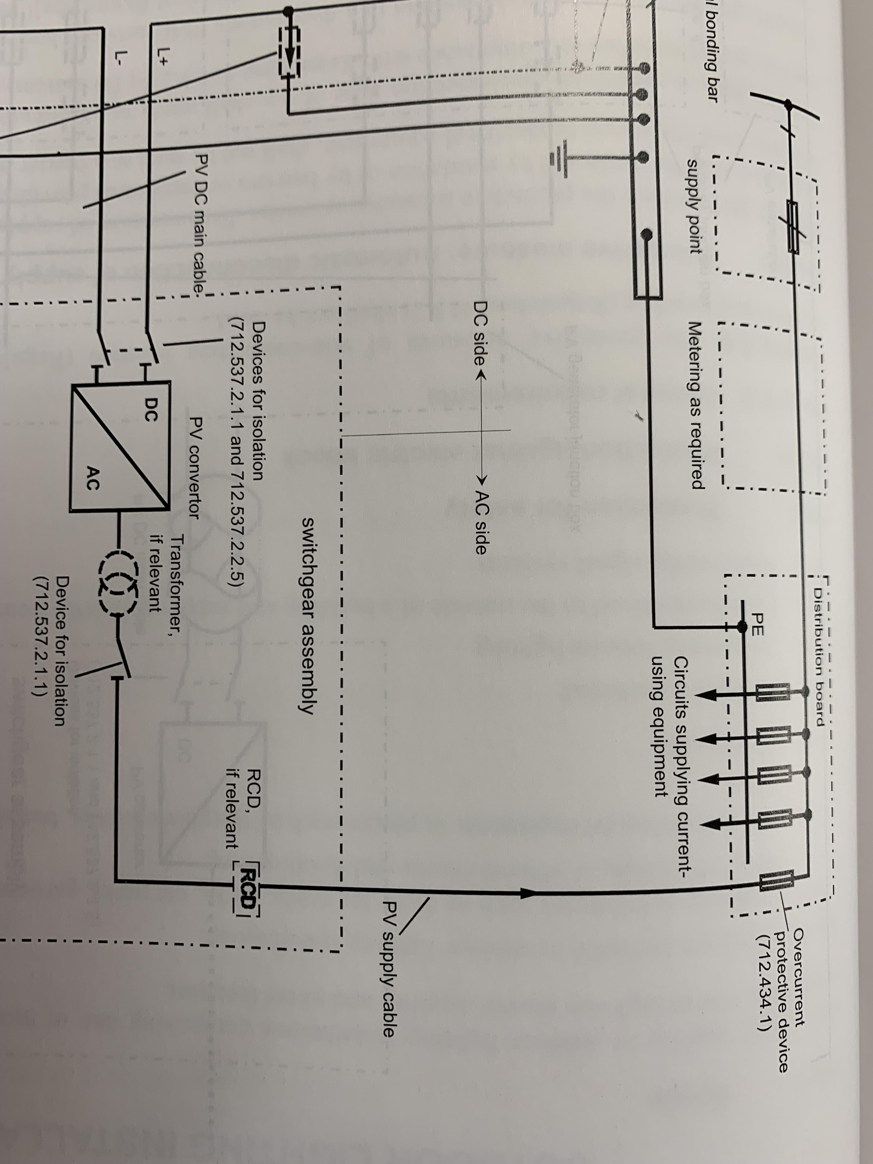

Catford Bags Posted January 31, 2024 Share Posted January 31, 2024 (edited) Hi All - just starting to plan a DIY 4KW (ish) groundmount system. This may not be the only question that I post on here... My current plan is put the panels 60m from the house beside an existing shed. The shed is supplied with electricty via a buried underground cable. The cable comes out of the consumer unit in the house, is trenched under the garden then has a t junction - one half supplies the sockets and lighting in the shed via a small consumer unit, the other half used to supply a static caravan but is now capped off in an exterior box. The AC armoured cable is BS5467 (600/1000v). 3 core 10 mm. CSA. i'm not a spark. My question is - Could my design incorporate the existing cable to transport electicity from the consumer unit in the shed (which would contain my proposed inverter and battery) back to the house ? IE - can I avoid having to trench another cable. Many thanks in advance for any thoughts. Edited January 31, 2024 by Catford Bags Link to comment Share on other sites More sharing options...

TonyT Posted January 31, 2024 Share Posted January 31, 2024 I lost my post, so if it was my house, I wouldn’t stress, I would have suitable labels, isolators in place, double pole RCD protection, not shown in the regs snapshot above but that’s perfect world, engineering decisions have to be made. etc but it’s your spark doing the install that needs to sign it off. How are you going to measure the current on the taiks via a CT? Link to comment Share on other sites More sharing options...

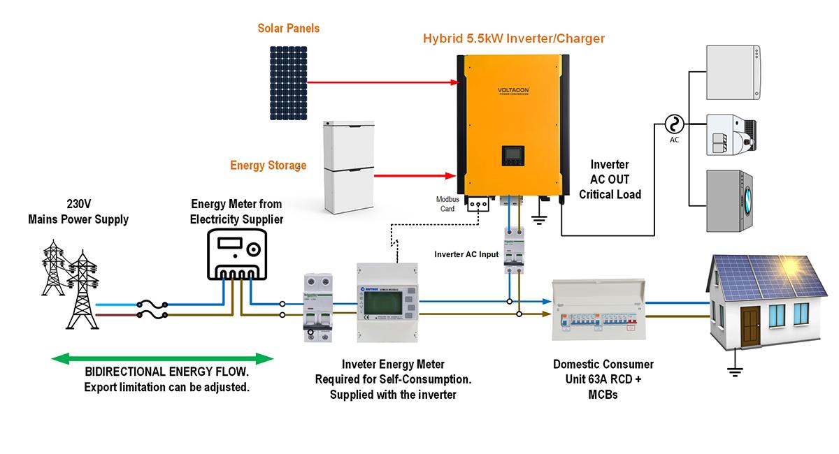

Alan Ambrose Posted January 31, 2024 Share Posted January 31, 2024 (edited) There was a similar thread on here recently. From brief research, I came to the same conclusions as above - the majority of people run DC back to an inverter near the house CU, with the inverter not so very far away from the CU that a current clamp can't monitor the overall DNO supply. Lastly, I think the power can't go from the outbuilding into the house CU via the RCD/MCB that it is currently hanging off. First, it'll make the house CU live even when the CU isolator switch is operated - which is 'not great'. Also, the house CU may very well have the wrong RCD - it needs a more grown-up one (forget which, type B maybe) for the inverter. (FFS there are 6 or 7 RCD types these days!) A question for @ProDave - why do we generally put outbuilding CU's hanging off an MCB/RCD in the house CU rather than straight from the DNO supply (i.e. in a similar fashion and 'parallel' to the to the house CU)? Edited January 31, 2024 by Alan Ambrose Link to comment Share on other sites More sharing options...
Dillsue Posted January 31, 2024 Share Posted January 31, 2024 2 hours ago, Alan Ambrose said: the majority of people run DC back to an inverter near the house CU, with the inverter not so very far away from the CU that a current clamp can't monitor the overall DNO supply. The OP is trying to avoid running another cable out to the outbuilding. If the existing is used for the PV DC therell be no AC supply to the outbuilding 2 hours ago, Alan Ambrose said: I think the power can't go from the outbuilding into the house CU via the RCD/MCB that it is currently hanging off. First, it'll make the house CU live even when the CU isolator switch is operated - which is 'not great'. That's the way all grid tied inverters are connected as they shutdown when they loose their grid connection. Link to comment Share on other sites More sharing options...
Alan Ambrose Posted February 1, 2024 Share Posted February 1, 2024 (edited) >>> The OP is trying to avoid running another cable out to the outbuilding. Yeah, I am saying I think that's unrealistic. >>> That's the way all grid tied inverters are connected as they shutdown when they loose their grid connection. That strikes me as iffy. I much prefer the layout for non-grid tied e.g. I think that set-up needs a bit of work too - presumably you would want the 'critical loads' on their own little CU. I guess the outbuilding supply could come off the house CU or (better in my view) before it. And I don't see an RCD on there for the inverter. I see some RCDs and RCBOs are bi-directional. Also, in most cases, there's clearly some work to do re earth protection. Edited February 1, 2024 by Alan Ambrose Link to comment Share on other sites More sharing options...

HughF Posted February 2, 2024 Share Posted February 2, 2024 The ‘grid’ port on the Sunsynk is bi-directional apparently. Separate output for critical loads, and separate generator input. It’s no outback, but it seems to do the job. Link to comment Share on other sites More sharing options...

Bramco Posted February 3, 2024 Share Posted February 3, 2024 27 minutes ago, Dillsue said: I guess it would need to be so it could power the critical loads/charge the battery from from the grid when there's no PV?? On the Sunsynk, critical loads are a separate connection - there are 3 ac connections on the Sunsynk Ecco inverters: grid which is bidirectional, critical loads and one for a generator/wind turbine. We've just fitted one of the 5kW inverters with 3 of the 5.1kWh batteries and are very happy with it - so far..... The instructions for setting up how the power flows are a bit crap though, took a few tries before we go all the right boxes ticked. We have a 6.5kWp solar ground mounted array (with planning permission, we're green belt, so had to apply). Our sparky also advised a DC cable for the array to the garage which is about 60m distance. So as per @JohnMo's post above 4 core armoured cable. Simon Link to comment Share on other sites More sharing options...

sharpener Posted February 22, 2024 Share Posted February 22, 2024 One thing no-one has mentioned is that an ESS inverter should be protected by an RCD which it does not share with any other circuits. Several of the systems upthread do not comply with this. Link to comment Share on other sites More sharing options...

Dillsue Posted February 29, 2024 Share Posted February 29, 2024 Having an RS485 connected energy meter monitoring the import/export is the std way that Solaredge do charging/export limitation. I don't know if Givenergy have that option or rely on a CT directly connected to the inverter. If they rely on a direct CT connection then either the CT signal would likely travel a reasonable distance or they'll be limiting the use of their inverters by needing them to be mounted near to the incoming supply. You should be able to get that info from Givenergy?? Link to comment Share on other sites More sharing options...
Alan Ambrose Posted February 29, 2024 Share Posted February 29, 2024 I see GivEnergy do have a modbus current clamp, so you just need to ask them which of their inverters it'll run with: https://www.tradesparky.com/solarsparky/accessories/meters/givenergy-em115-meter-with-ct Link to comment Share on other sites More sharing options...
Dillsue Posted February 29, 2024 Share Posted February 29, 2024 11 hours ago, Catford Bags said: https://midsummerwholesale.co.uk/pdfs/giv-hy-5-0-gen-3.pdf Data sheet says that's got an RS485 interface to an energy meter and the battery, so you'd be able to use your cat 5 cable to run RS 485 between an energy meter on the incoming supply and an inverter in the shed. With a base voltage of 240vac ish you're not likely to have volt rise issues at your inverter based on your calcs 1 Link to comment Share on other sites More sharing options...
