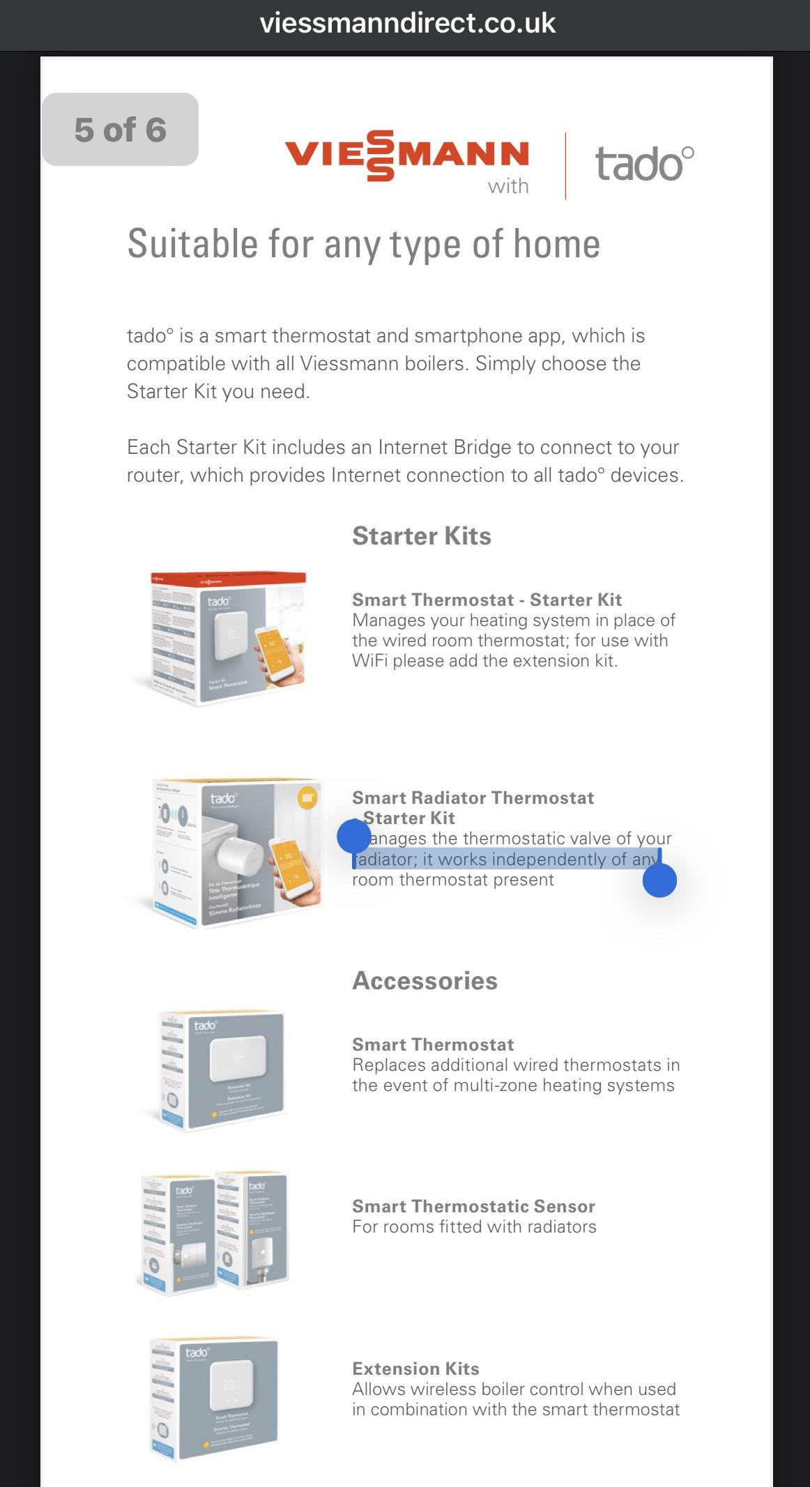

Adsibob Posted January 31, 2024 Author Posted January 31, 2024 I still find it incredible that I spent so much money on a complete lie. This is from a shop specialising in Veissman kit:
TonyT Posted January 31, 2024 Posted January 31, 2024 And they aren’t lying, they aren’t telling you it’s the best way to control your equipment though, just sell you more stuff like any good retailer.
JohnMo Posted February 1, 2024 Posted February 1, 2024 On 31/01/2024 at 22:50, Adsibob said: spent so much money on a complete lie. Expand What lie they don't say anything really except it smart - smart just means internet connected. Highlighted bit says a radiator valve doesn't takk to anything.

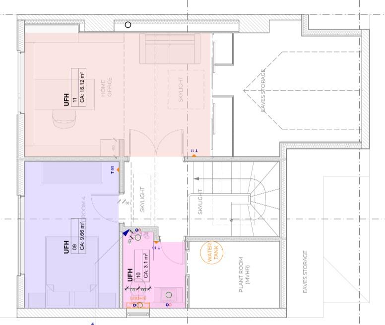

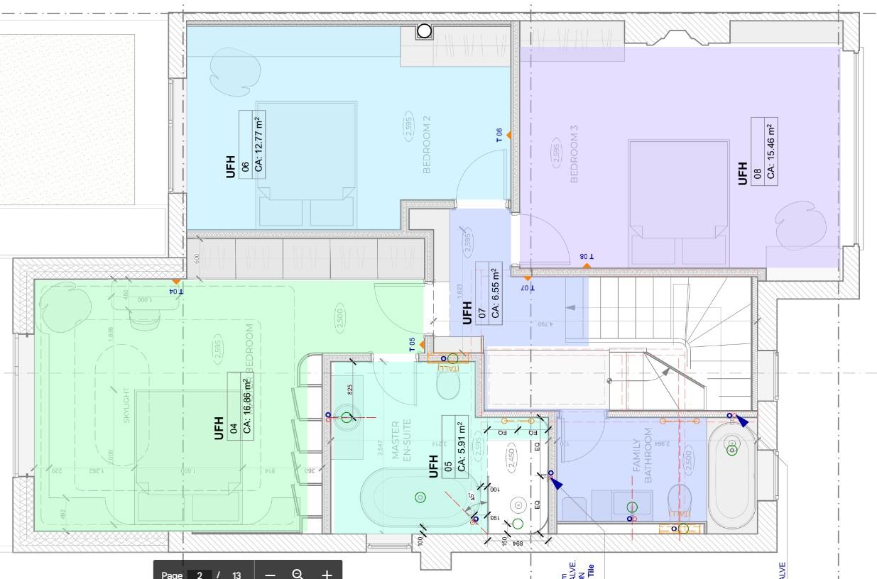

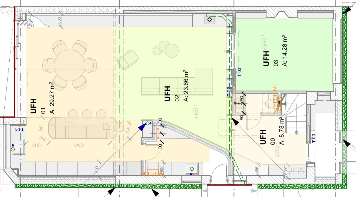

SimonD Posted February 1, 2024 Posted February 1, 2024 (edited) @Adsibob can you describe the zone setup you have in more detail please? I'm particularly interested in the UFH setup and zoning, where this is and how you manage the spaces with UFH, but also the radiator circuits. I haven't kept up with your retrofit but generally speaking, I'm guessing you have brick walls with added insulation (where? IWI, EWI cavity?), upgraded floor insulation and roof insulation. What I'd like to understand is the level of heat loss in relation to the thermal mass of the building. (Yes, I've used dreaded thermal mass, and in terms of figures, thermal mass = Building element volume x Volumetric Heat Capacity). Also, which rooms experience significant solar gain and how are those rooms generally used? Your stove will also play a role here as you don't want that interfering too much with heating through the rest of the house, as you've mentioned. What I'm getting at here is that I don't always think that whole house weather compensation is the right answer for everyone and every house. With well planned zoning, you can get good results. The problem is the control of this, especially with a mixture of UFH and radiators because they'll behave so differently, particularly where you've got thick coverings. But in terms of controls, I do think that using load compensating combined with weather compensating controls can be used to good effect for improved efficiencies in a zoned situation. In this instance we need to figure out the best way to approach this, and as you've mentioned, whether it it is more efficient than the existing Tado arrangement without modulation. In terms of the difference between load compensation and weather compensation, it is just a different approach to ensuring the heat input to the house matches its heat loss. With weather compensation, it uses outdoor temp (and sometimes other inputs) matched to a curve a closely matched to corresponding heat loss of the house.With load compensation, it does this by measuring actual reference room temperature to target temperature and the better load compensating controls will learn how the room responds to heat input/loss over to time to control heat output of the boiler. As I've been thinking about your system and earlier comments about the low loss header, I wonder whether your installer confused the use of low loss header versus a buffer. Their functions can be the same but from a control perspective, they are different. If you're running a system with lots of zoning, then you use a buffer, not a low loss header and the low loss header can't replace it, because its function is different. So my thoughts are drawn to thinking about whether a buffer can be installed in place of the LLH together with a 4 pipe system for DHW and then turn down your flow temperature on the the boiler. Then, only if necessary look at replacing the tado which I'm guessing has lots of smart TRVs installed through your house too? Just a strawman though at the mo. Edited February 1, 2024 by SimonD
Adsibob Posted February 1, 2024 Author Posted February 1, 2024 On 31/01/2024 at 23:44, TonyT said: And they aren’t lying, they aren’t telling you it’s the best way to control your equipment though, just sell you more stuff like any good retailer. Expand Well, I think they are stretching the interpretation of “compatible”. I’d hardly describe it as “compatible with all Veissman boilers” when there is actually very limited functionality compared with other fully functional thermostats.

Adsibob Posted February 1, 2024 Author Posted February 1, 2024 (edited) On 01/02/2024 at 09:35, SimonD said: can you describe the zone setup you have in more detail please? I'm particularly interested in the UFH setup and zoning, where this is and how you manage the spaces with UFH, but also the radiator circuits. I haven't kept up with your retrofit but generally speaking, I'm guessing you have brick walls with added insulation (where? IWI, EWI cavity?), upgraded floor insulation and roof insulation. Expand I have pasted below the plans of my house which show the different zones. Under each plan I have noted details of the construction, as these aren't always accurately set out on the diagram. GROUND FLOOR (4 zones) There are 4 zones on the ground floor shown above, each with its own overpriced and misrepresented piece of junk tado thermostat. When you look at the above ground floor plan, the two thirds of the ground floor to the right is original construction, solid brick walls, upgraded externally with 40mm of EWI Kingspan Kooltherm K7 and a layer of silicone render on top of that (shown in green). There is a mistake in the plan in that the rear extension forming the third of floorspace to the left of the plan, show the EWI extending all along the flank wall, but in actual fact only about half of that extension wall is covered in EWI and render, the rest is brick. We have 2G windows throughout. The rear extension has large sliding doors which are West facing, and there is also a large 2G window above the kitchen sink that is west facing, so plenty of afternoon/evening sunshine. Whereas the front of the house is east facing so gets morning sun. The original house was a 1930s semi, with the Northern side (top of diagram) being attached to the adjacent building. Funnily enough, they have had their front elevation done with the same EWI we have, using our builder after they saw ours. But only the front. Our front room (UFH zone 03) rarely needs any heating. I think part of the reason is the neighbour's EWI, but the other reason is that room, as well as UFH zone 00 is raised upper ground floor (about 210mm higher), with much more concrete under the 100mm PIR floor insulation, onto which the UFH pipes are tacked. FIRST FLOOR (5 zones) The hallway and family bathroom are the same zone. Orientation is same as described above, so UFH zone 7 is getting morning solar gain, whereas zones 04 and 05 are getting evening solar gain. Zone 04 also has a fairly large skylight. Not much solar gain for the ensuite bathroom or family bathroom, as windows are small. The entirety of the external walls of the first floor are covered with the same EWI buildup as described above, despite this not being shown on the drawing. SECOND FLOOR (three zones) This is a loft conversion so largely a modern construction, but the side walls and front wall (top and botoom and right) are mostly original construction from the 1930s, with only the dormer cheeks being new. There is a combination of wood fibre insulation and PIR backed plasterboard in the roof build-up, but it still only just passed building regs as we didn't have space to put more in. We went for wood fibre to increase decrement delay. The three skylights in the roof give quite a bit of solar gain. Our adjoining neighbour has also done a loft conversion, so we get protection along the northern wall, which is all adjoined by their house. On the eastern wall (right) and parts of the southern wall (bottom) we have the same EWI. The house is VERY airtight. I haven't done a test, but the detailing was pretty good and builder was good about using Tescon Vana tape on all windows and doors. CONTROL/ZONING So as you can see, I have a whopping 12 UFH zones, each with their own Tado. Then there is a 13th zone, just to control the two towel rads we have on the first floor. These are simply switched on and off by a command to alexa to switch on a smart plug. I have the Tado extension kit to control the HW cylinder in the attic space. There are four UFH manifolds in total: two on the ground floor (one for zones 00 and 03 which are on the upper ground floor; and one for lower ground zones 01 and 02) one on the first floor one on the second floor Edited February 1, 2024 by Adsibob
