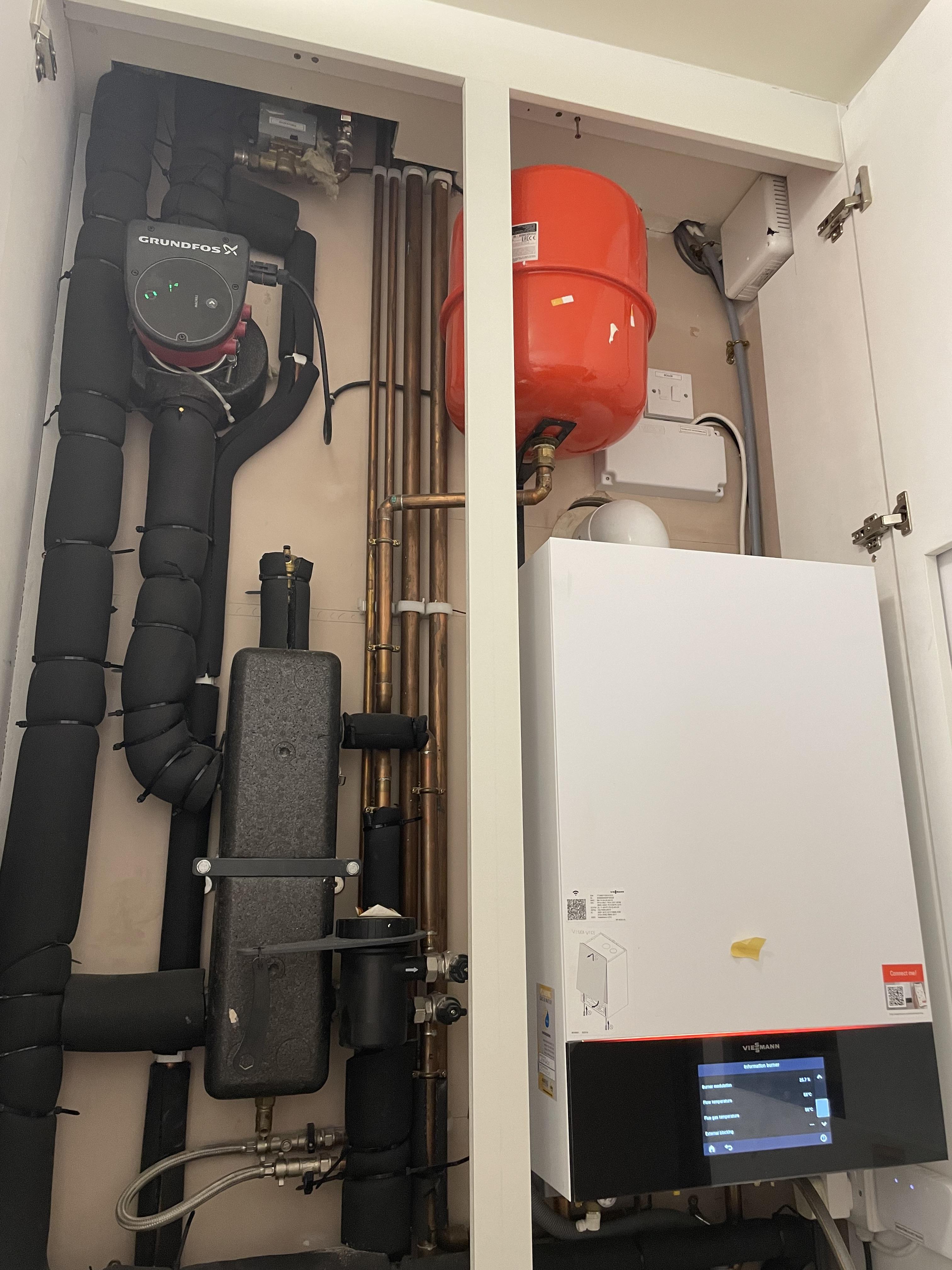

Adsibob Posted January 30, 2024 Author Posted January 30, 2024 (edited) On 30/01/2024 at 23:48, marshian said: The question is really how far away from the boiler is the LLH I assume that shares it's feed with the flow and return for the tank!!! Potentially you can split the system at that point Expand Right next to each other. Here is a as photo, boiler on the right, LLH is the anthracite polystyrene clad box immediately to the left of the magma clean, which is immediately to the left of the boiler. Edited January 30, 2024 by Adsibob
Adsibob Posted January 30, 2024 Author Posted January 30, 2024 On 30/01/2024 at 23:49, marshian said: Absolutely I mean at the boiler Expand Any idea how I find that info? Playing around in the display, I found readings for burner modulation, flow temp and flue gas temp, but not return temp.
marshian Posted January 30, 2024 Posted January 30, 2024 On 30/01/2024 at 23:52, Adsibob said: Right next to each other. Here is a as photo, boiler on the right, LLH is the anthracite polystyrene clad box immediately to the left of the magma clean, which is immediately to the left of the boiler. Expand So the two vertical 22mm copper pipes that are together and uninsulated go to your HW tank? If that is the case then as @SimonD said you can convert to separate feed for HW and CH pipework wise relatively easily Control wise I'm not in a position to advise but you are in London right? I'd be asking "Urban Plumber" to quote for the changes
