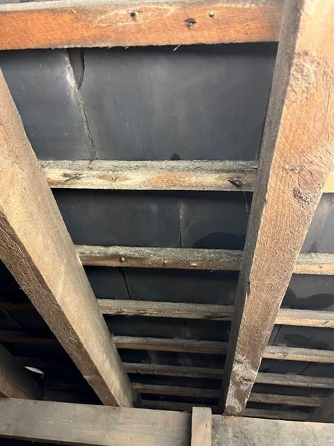

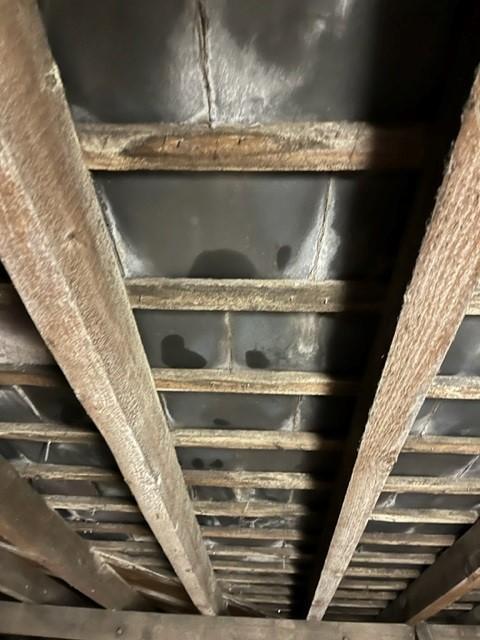

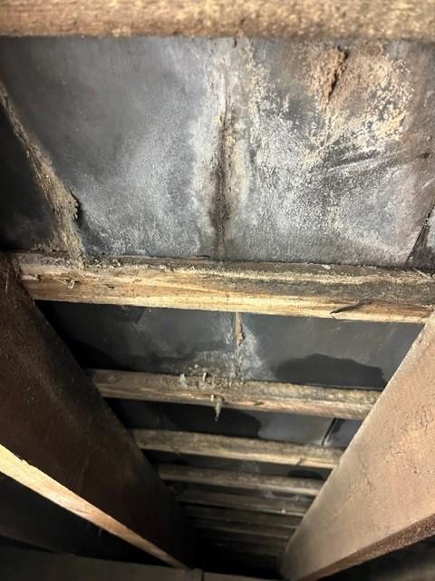

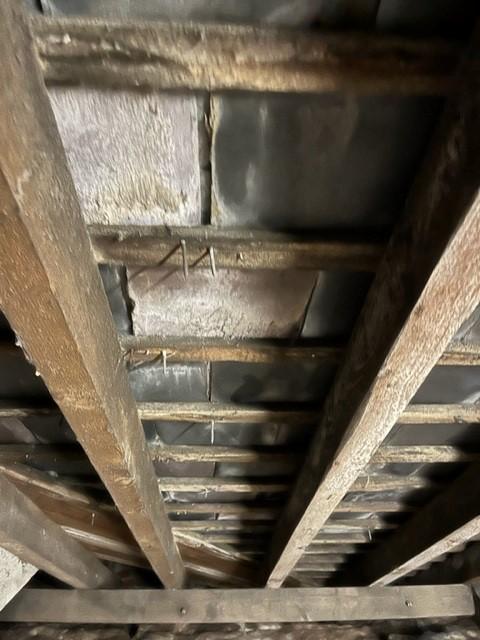

Willl Posted February 28, 2024 Author Posted February 28, 2024 Thanks all! Is it possible to tell from the above images if these slates could be reused? Will
markc Posted February 28, 2024 Posted February 28, 2024 (edited) 14 minutes ago, Willl said: Thanks all! Is it possible to tell from the above images if these slates could be reused? Will Just about any slate can be reused, but, there will be breakages, lots of sorting, cleaning, swearing and throwing them into a heap … and then wishing you hadn’t bothered. Edited February 28, 2024 by markc
Mr Punter Posted February 28, 2024 Posted February 28, 2024 19 minutes ago, Willl said: Thanks all! Is it possible to tell from the above images if these slates could be reused? Will I think you may be able to save a few to use on a shed or porch. Your other option is to remove them yourself and carefully stack them. Slates cost less than £2 each.
