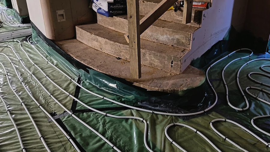

bmj1 Posted January 25, 2024 Posted January 25, 2024 Solid concrete staircase sitting directly onto the beam and block oversite, bypassing our insulation. Is this a cause for concern ? Anything I should do to rectify ? W
JohnMo Posted January 25, 2024 Posted January 25, 2024 It is an issue, no ideal of a practical way to fix - your stair will be sucking heat away from the house for ever more.
nod Posted January 25, 2024 Posted January 25, 2024 1 hour ago, JohnMo said: It is an issue, no ideal of a practical way to fix - your stair will be sucking heat away from the house for ever more. Plus 1 Probably not your fault Your Architect needs Shooting 1
joe90 Posted January 25, 2024 Posted January 25, 2024 1 hour ago, nod said: Your Architect needs Shooting Yes.
bmj1 Posted January 25, 2024 Author Posted January 25, 2024 @nod @JohnMo @joe90 - thanks, good to know. The plan was to clad the step with engineered wood. Do I need to worry about moisture coming up through the concrete and damaging the wood ? We're beam and block, and DPC is in place underneath, so I'm hoping should be okay, but figured I would ask the question
bmj1 Posted January 25, 2024 Author Posted January 25, 2024 1 hour ago, nod said: Plus 1 Probably not your fault Your Architect needs Shooting To be fair, architect didn't detail this way, was the builder thinking he knew better...
joe90 Posted January 25, 2024 Posted January 25, 2024 (edited) 11 minutes ago, bmj1 said: To be fair, architect didn't detail this way, How did the architect detail it? And why didn’t the builder do what the architect designed. 11 minutes ago, bmj1 said: was the builder thinking he knew better... Well he is not an architect and does not know better. Edited January 25, 2024 by joe90
bmj1 Posted January 26, 2024 Author Posted January 26, 2024 32 minutes ago, joe90 said: How did the architect detail it? And why didn’t the builder do what the architect designed. Well he is not an architect and does not know better. Architect detailed screed first with all GF partitions and staircase on top of the screed
joe90 Posted January 26, 2024 Posted January 26, 2024 3 minutes ago, bmj1 said: Architect detailed screed first with all GF partitions and staircase on top of the screed Then I would ask the builder why he didn’t follow the drawings (which is what you are paying him to do!) and what is he going to do to rectify the thermal bridge. I would not put up with that fault caused by the builder. 1
Russdl Posted January 27, 2024 Posted January 27, 2024 That’s not good, it’s been bugging me ‘what would I do’? I think I’d consider supporting the existing staircase. Chopping off the bottom to or three stairs. Completing the floor as designed and then re forming the bottom steps. How that would work in reality I don’t know but leaving ‘as is’ would be dire I reckon. 2
Andehh Posted January 27, 2024 Posted January 27, 2024 (edited) Could you/I would wrap a few layers of Armaflex tape around the form of it to seperate screed from stairs? Few mm will help provide a degree of seperation, will help reduce the problem of it. Use thicker underlay for your flooring. Wood as you plan for, with a carpet runner maybe? (I don't like wood stairs, with the wrong socks on far too slippy) Reality is you're gunna have to suck it up and move on, else face serious serious cost, headache and heartache trying to fix when EVERYONE will roll their eyes and think you're OCD. The £canceled screed alone cost will be worth more then 10 years of that thermal bridging, let alone piss off factor, delays and cost for whatever bodges you try and introduce to fix. You can't win them all! Building houses is not a zero sum game. Just double down efforts elsewhere to try and offset it, move on and forget about it. Edit.. Damp won't come up as the block and beam has dpc and is ventilated to keep it dry anyway. Edited January 27, 2024 by Andehh

Mr Punter Posted January 27, 2024 Posted January 27, 2024 There is a cold bridge but not the end of the world. It may be worth a bit of insulation over the UFH pipes where they run down the corridor if it is not too late.
