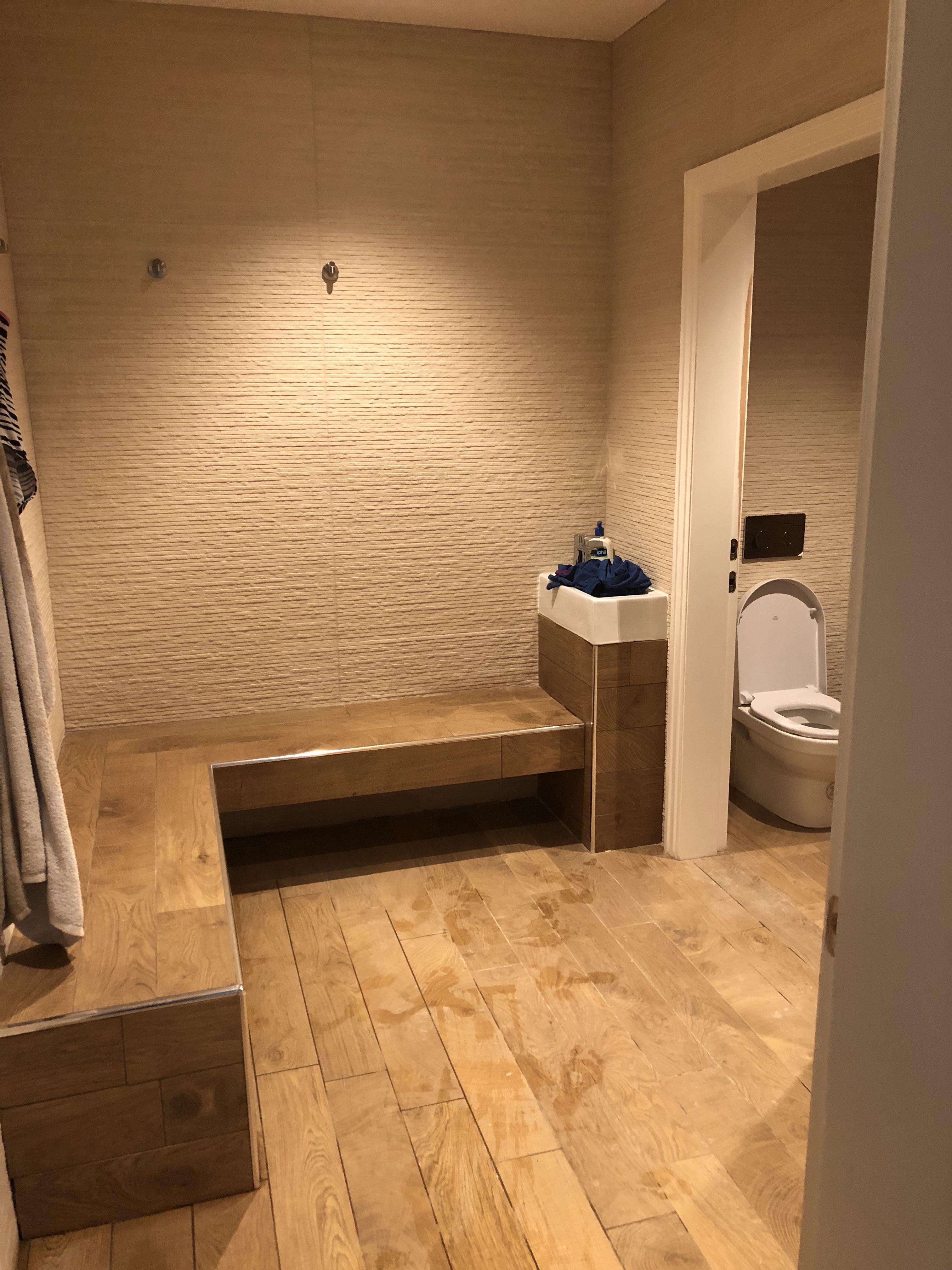

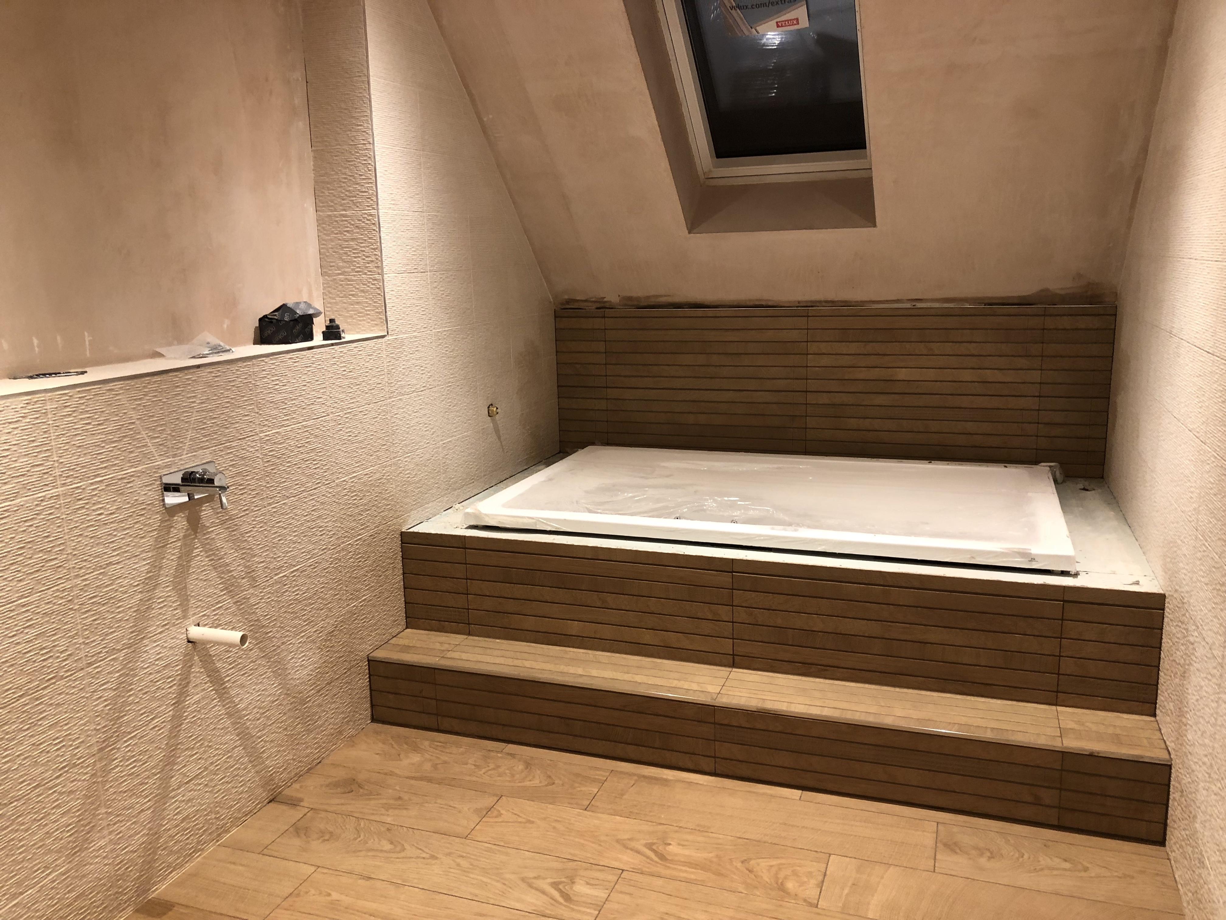

AliG Posted January 23, 2024 Posted January 23, 2024 Have some of these Porcelanosa wood effect tiles which we really like. A different look to the tiles you have shown. They are quite a bit more expensive at low £30s per sq metre + VAT if I remember correctly.
crispy_wafer Posted January 24, 2024 Author Posted January 24, 2024 15 hours ago, AliG said: Have some of these Porcelanosa wood effect tiles which we really like. A different look to the tiles you have shown. They are quite a bit more expensive at low £30s per sq metre + VAT if I remember correctly. Very nice.
