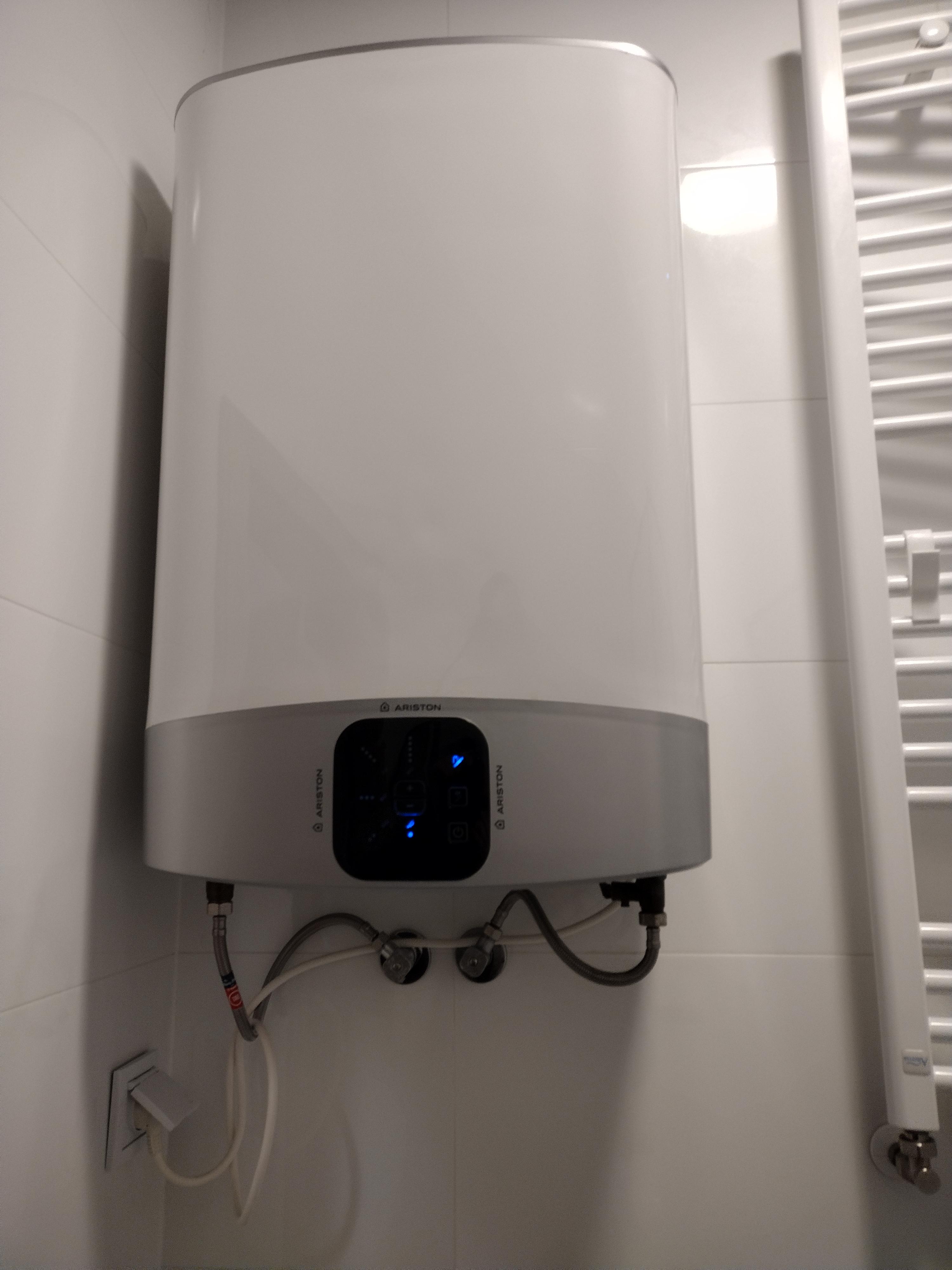

JamesPa Posted January 19 Share Posted January 19 As fitted in an an apartment in Poland. Perfect surely for a 1-2 person flat. I'm posting this in view of the many discussions about the challenges of dhw with ashp. Sometimes I think we make things too complex! Link to comment Share on other sites More sharing options...
SteamyTea Posted January 19 Share Posted January 19 Apart from the size, what makes it different from this Link to comment Share on other sites More sharing options...
JohnMo Posted January 19 Share Posted January 19 Often thought, point of use heat, almost on demand, with some nominal local storage was a good solution. 1 Link to comment Share on other sites More sharing options...
SteamyTea Posted January 19 Share Posted January 19 Just now, JohnMo said: with some nominal local storage Called a buffer tank isn't it? Link to comment Share on other sites More sharing options...
JohnMo Posted January 19 Share Posted January 19 Just now, SteamyTea said: Called a buffer tank isn't it? Maybe, but it's actually a small UVC, but normally below a nominal size, that doesn't require G3 regs Link to comment Share on other sites More sharing options...

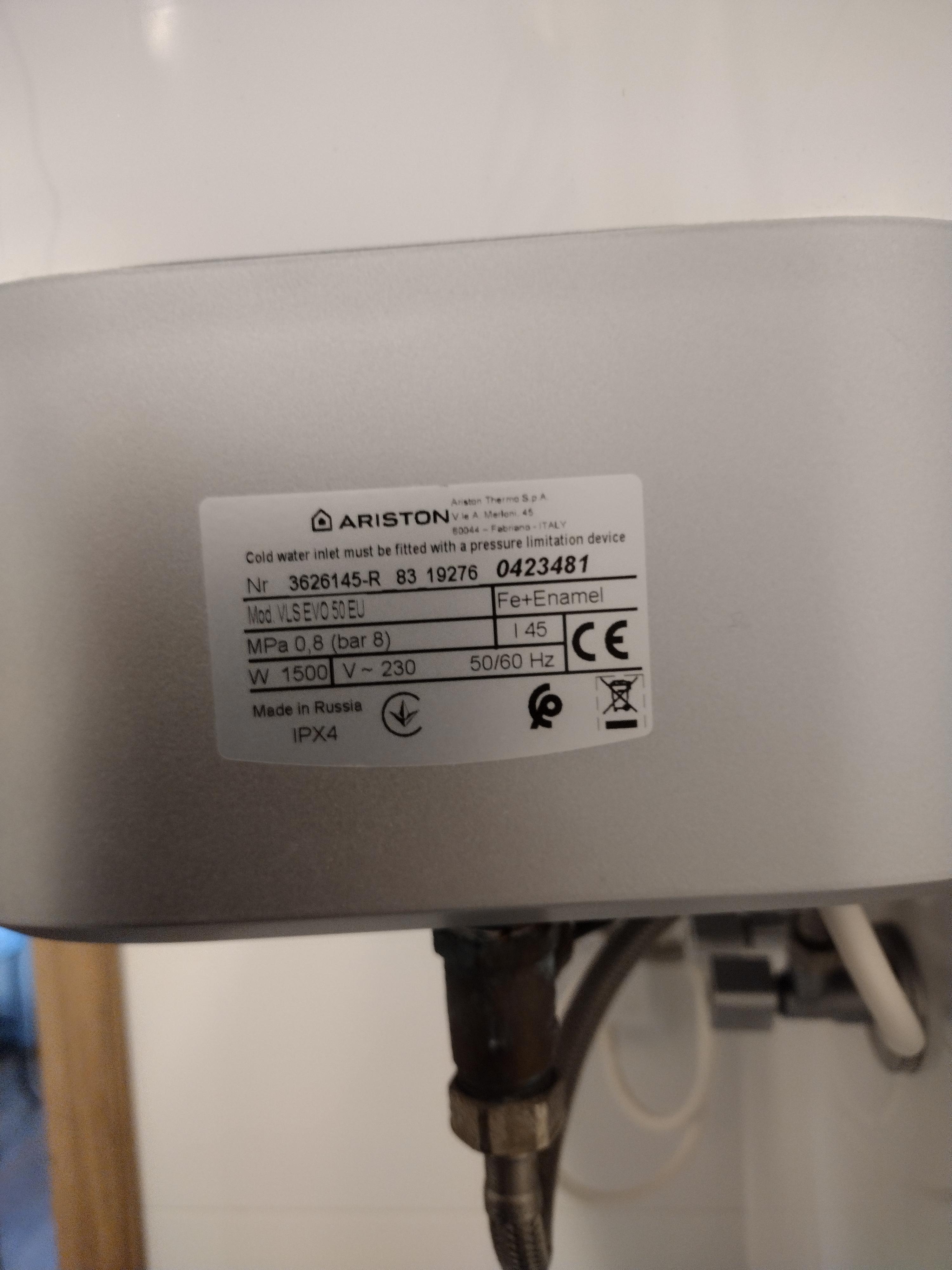

JamesPa Posted January 19 Author Share Posted January 19 4 minutes ago, JohnMo said: Maybe, but it's actually a small UVC, but normally below a nominal size, that doesn't require G3 regs The model pictured is actually 50l which I believe would require G3 in the UK. There is what looks like a prv on the cw inlet (just about visible in the photo), which vents to the tiled floor of the bathroom. Ariston do bigger ones as well, the one in the picture is the size of a combi. I guess my point is that others seem to be able to find solutions to things we make extraordinarily difficult. Link to comment Share on other sites More sharing options...
SteamyTea Posted January 19 Share Posted January 19 4 minutes ago, JamesPa said: I guess my point is that others seem to be able to find solutions to things we make extraordinarily difficult. I have often said that for every law that says we must do some, we have another law that makes it illegal. Link to comment Share on other sites More sharing options...

ProDave Posted January 19 Share Posted January 19 2 hours ago, JamesPa said: I'm posting this in view of the many discussions about the challenges of dhw with ashp. ASHP, heat pump unvented hot water tank, heated to 48 degrees. What challenges are you thinking of? 1 Link to comment Share on other sites More sharing options...
JamesPa Posted January 19 Author Share Posted January 19 (edited) 8 hours ago, ProDave said: ASHP, heat pump unvented hot water tank, heated to 48 degrees. What challenges are you thinking of? In a retrofit for a small house or flat: locating the tank, running the primary feeds to the tank and most problematic of all, the (totally ott) g3 vent which is a real problem even in my much larger retrofit, even more so if you follow the building regs as regards notching and drilling (which I guess many dont). Easy in a 200 sq m newbuild, a real pita in a retrofit which is >90 percent of the market that we need to tackle. More to the point the dhw is a significant part of the ashp retrofit cost and disruption because of how difficult the industry has choosen to make it. Edited January 19 by JamesPa Link to comment Share on other sites More sharing options...
JamesPa Posted January 19 Author Share Posted January 19 (edited) 9 hours ago, Simon Cook said: Yeah this is very common in parts of Europe but only for showering. what do you have for heating the apartment? Radiators, not sure the source of the hot water for the rads. It's not mine, I'm just staying there. I posted it to point out that there other ways to deal with one of the current disincentives to ashp retrofits, if only we would get out of our box and learn from others. Edited January 19 by JamesPa 1 Link to comment Share on other sites More sharing options...
