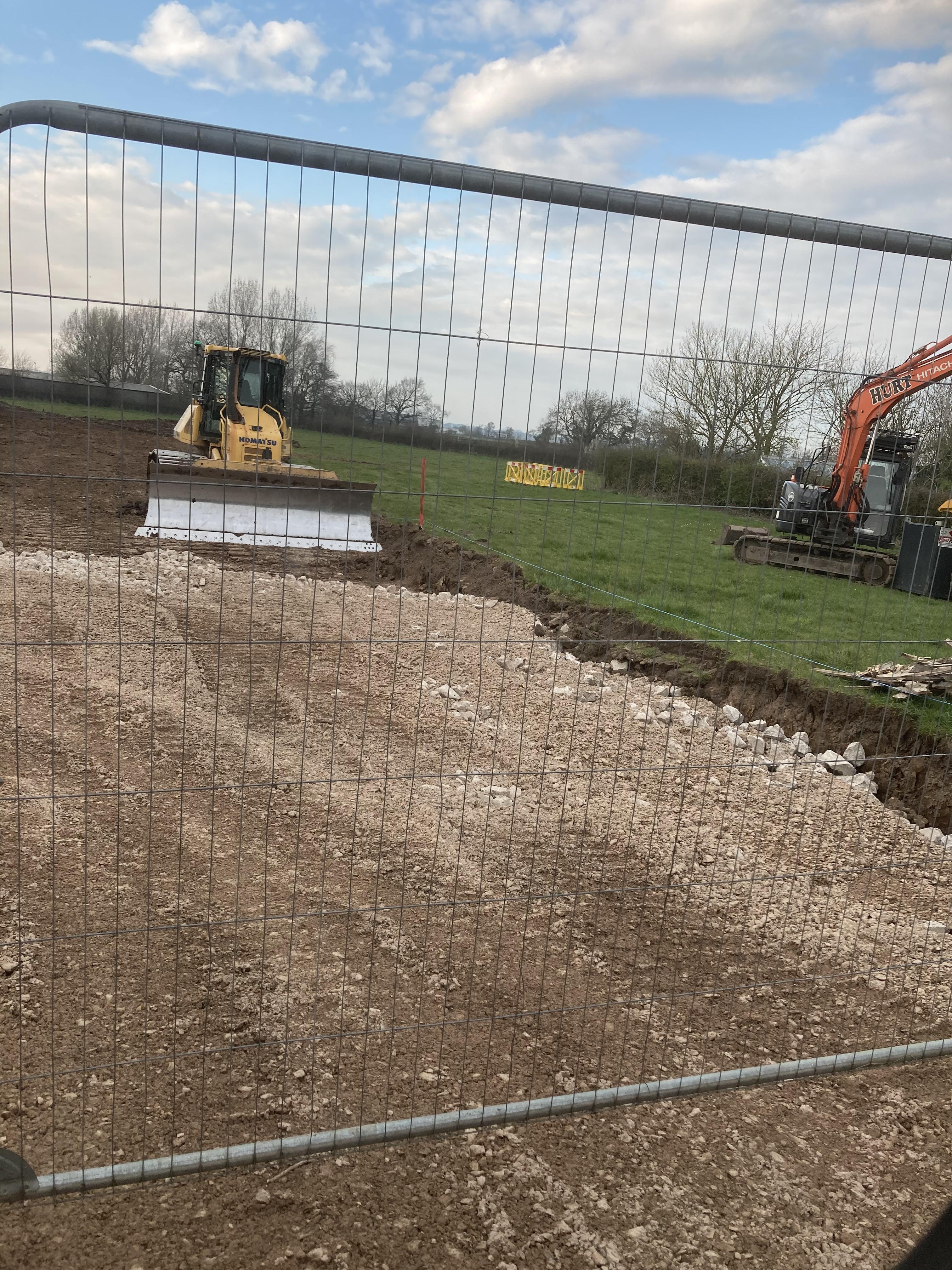

nod Posted January 13 Share Posted January 13 Nothing to stop you We stripped the top soil on our field and buried all the spoil and put the top soil back over it Link to comment Share on other sites More sharing options...
WannabeBob Posted January 13 Author Share Posted January 13 Thanks Nod. That should save us a bit! Might not fit all the spoils from the basement dig out but reckon every bit helps Link to comment Share on other sites More sharing options...
saveasteading Posted January 13 Share Posted January 13 There's a magic height for fill of 4 feet at which planning matters can kick in. Or if you are in a conservation area. Otherwise it is good practice to avoid muck away. Where else would it be going? A much more effective way to reduce cost is to not have a basement. 1 Link to comment Share on other sites More sharing options...
nod Posted January 13 Share Posted January 13 3 hours ago, WannabeBob said: Thanks Nod. That should save us a bit! Might not fit all the spoils from the basement dig out but reckon every bit helps Thanks We saved about 19k on spoil Mostly Clay - 1500 3 day hire for the dozer 900 for fuel Still a good saving Link to comment Share on other sites More sharing options...
SteamyTea Posted January 13 Share Posted January 13 3 hours ago, nod said: stripped the top soil on our field and buried all the spoil and put the top soil back over it I think that order is the important bit, from an ecological point of view. The only thing to be careful is if it is clay subsoil, water runoff could be a problem. 1 Link to comment Share on other sites More sharing options...
nod Posted January 13 Share Posted January 13 30 minutes ago, SteamyTea said: I think that order is the important bit, from an ecological point of view. The only thing to be careful is if it is clay subsoil, water runoff could be a problem. Ours was all bolder Clay Hence the expense I payed a deep six inch drain across the field 100 meters With four chambers each with land drains running from them that seems to work ok 1 Link to comment Share on other sites More sharing options...
SteamyTea Posted January 13 Share Posted January 13 2 minutes ago, nod said: Hence the expense I payed a deep six inch drain across the field 100 meters With four chambers each with land drains running from them that seems to work ok At least you thought about it and put a remedy in. I wonder how many people just spread clay and then wonder why they get some localised flooding. Link to comment Share on other sites More sharing options...
