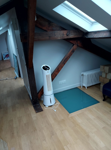

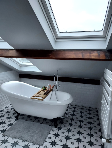

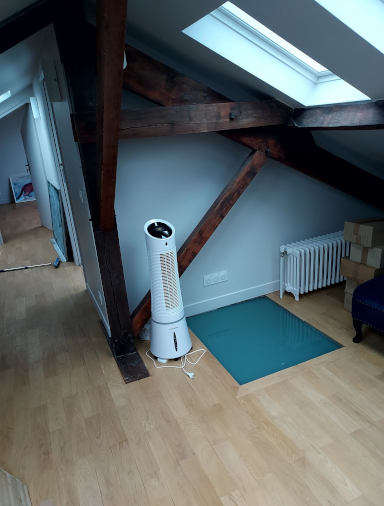

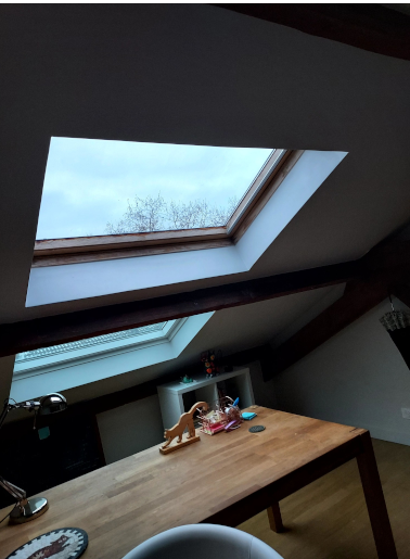

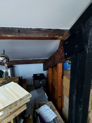

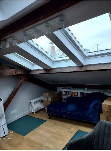

Garald Posted January 10, 2024 Posted January 10, 2024 (edited) I just got an inexpensive thermal camera (HIKMicro E01, from Amazon) - and it's -2C outside, so I just had a load of fun. Here is a series of thermal pictures, with "normal" pictures of the same places to go with them, and some comments. Please tell me if I am misinterpreting things or if I am missing clues. (For context: I am at the end of a renovation carried out by what I believe to be a competent contractor, with plenty of help from here.) My aims right now are: - to evaluate the work that has been done - to see what I can have fixed easily - to know what issues remain that could be fixed in a further renovation a few years down the road. All right, let us get started. I apologize for the mess - I am still unpacking and assembling a few things. Keep in mind that the temperature->color mapping is different in each picture. 1. Attic entrance You can see the metal instruction in the wall insulation as clear as in an X-ray. (I believe I've posted pictures here of when it was being installed.) Is this a problem? 2. Home office 1 Skylights: i wanted many, and thought of heat loss as a worthwhile sacrifice. At least they are new (U=1.1-1.3 or thereabouts). Something funny seems to be happening in the edges and corners. This seems all right, but... A corner here seems very cold. Again: - the bit of ceiling immediately next to the wooden beams sems cold, - more seriously, the short walls are cold, where not covered by bookcases. The obvious solution is more bookcases. (I think somebody here said we were going way off a tangent when we started discussing the thermal properties of bookcases, but apparently they are real.) If there has to be an air gap of 2 to 3cm, that's actually better. However, I would need to let the electricity sockets show through the back, and I don't know how to do that (without calling a carpenter). 3. Bathroom I have nothing to say on the bathroom, save what I've already said - fairly cold short walls (and I would have expected the skylights' frames to be less cold: these are new skylights). Maybe others can find things to remark upon? 4. Second home-office/bedroom One of the skylights is old (with a wooden frame), from before the renovation, and it shows. Edited January 10, 2024 by Garald 2

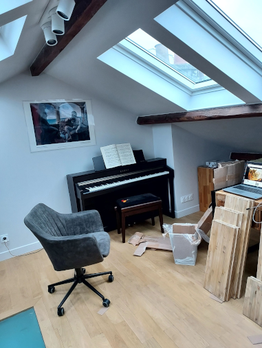

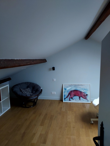

Garald Posted January 10, 2024 Author Posted January 10, 2024 (edited) For the record, what is behind the low walls (called "short walls" in the above - I was falling asleep) is blown-in cellulose. I thought the R there would be at least as high as in the orher walls in the house (and, in particular, the other walls in the attic, where there is a few cm of cellulose plus a reflecting insulator). That's why I am surprised the low walls are colder. Edited January 10, 2024 by Garald
ProDave Posted January 10, 2024 Posted January 10, 2024 Can you explain the short walls more? Are these essentially the top of the outside walls of the house with the roof sitting on top of them? Or does the roof slope right down to floor level and these are partition walls with a triangle corner of loft space behind them? Could it be the blown in celulous has slumped, or was never filled completely so there are voids at the top. Overall I don't think it looks bad.

Garald Posted January 10, 2024 Author Posted January 10, 2024 2 hours ago, ProDave said: Can you explain the short walls more? Are these essentially the top of the outside walls of the house with the roof sitting on top of them? Or does the roof slope right down to floor level and these are partition walls with a triangle corner of loft space behind them? The latter. 2 hours ago, ProDave said: Could it be the blown in celulous has slumped, or was never filled completely so there are voids at the top. Right - shouldn't I talk to the contractor about it? Is it normal for these short walls to be colder than the rest?
Garald Posted January 10, 2024 Author Posted January 10, 2024 Just double-checked - the short walls are colder at the top than at the bottom, and that would seem to suggest that the blown-in cellulose has slumped, or that not enough was filled in. On the other hand, it's also the case that there necessarily has to be less cellulose near the top (that's how triangles work!). What to do? I can think of two options: - Take this up with the contractor, getting into a fight in the hope he reopens the short walls and puts in more cellulose? - Inform the contractor (in case he can think of an easy fix) and put on thermal wallpaper (but is that a scam?).
Conor Posted January 10, 2024 Posted January 10, 2024 (edited) The cold lines on the roof, dwarf wall junctions, and around the reveals will be the timbers, higher thermal conductivity that the filled void. Not much you can do about that other than fitting insulated plasterboard, at a large cost, inconvenience and looks like you can ill afford a loss of headroom. Edited January 10, 2024 by Conor

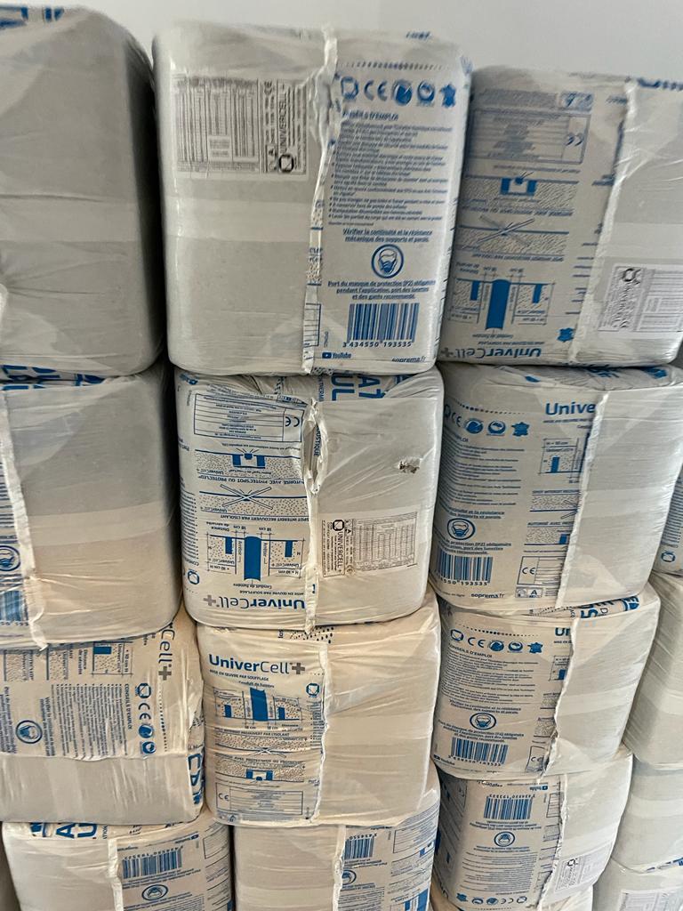

Garald Posted January 19, 2024 Author Posted January 19, 2024 (edited) I can ask the contractor the next time I manage to get hold on him. Here are some pictures and a video he sent me at the time of the build. One moment... Edited January 19, 2024 by Garald
Garald Posted January 19, 2024 Author Posted January 19, 2024 738cea63-0534-47c5-821a-6ae3af62801d.mp4

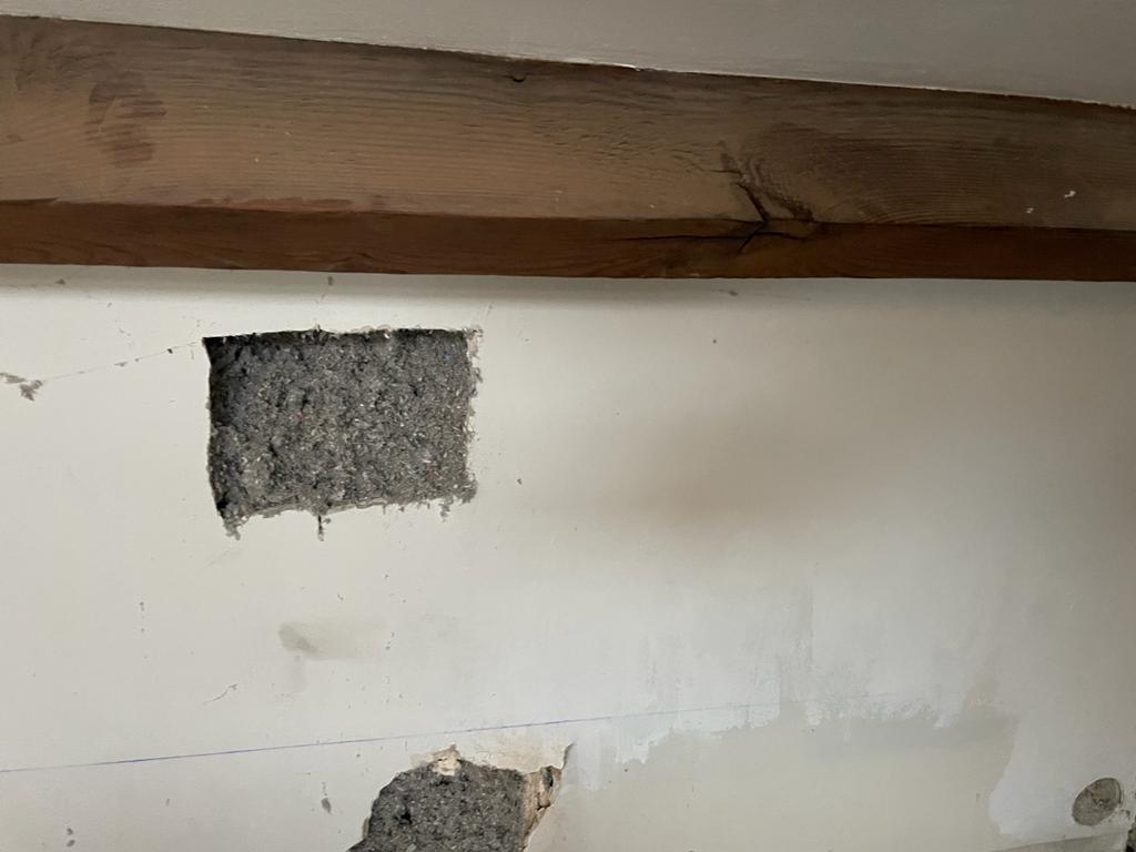

Iceverge Posted January 19, 2024 Posted January 19, 2024 Looks like it's just behind the plasterboard which is fine Cut a 80 X 20mm hole horizontally near the top of the wall in the plasterboard. If you can't see any cellulose shove your phone in with the video and flashlight on and have a look. JUST DON'T DROP YOUR PHONE!!!!!!!
Garald Posted January 19, 2024 Author Posted January 19, 2024 1 hour ago, Iceverge said: Looks like it's just behind the plasterboard which is fine Cut a 80 X 20mm hole horizontally near the top of the wall in the plasterboard. If you can't see any cellulose shove your phone in with the video and flashlight on and have a look. JUST DON'T DROP YOUR PHONE!!!!!!! Hm, it's a bit of a pity, since everything is painted thrice over already. OTOH, if I am going to get some of that Italian cork+plasterboard anyhow, I might as well. But how do I cut a hole in the plasterboard? (I could try to locate the hole that appears in the pictures, but it seems to have been hidden carefully.)
Iceverge Posted January 19, 2024 Posted January 19, 2024 1 hour ago, Garald said: could try to locate the hole that appears in the pictures, but it seems to have been hidden carefully.) Go elsewhere, you'll be lightly to hit screws etc there. 1 hour ago, Garald said: But how do I cut a hole in the plasterboard Its not too hard. Bang a screwdriver through it and use a bread knife if you don't have any tools. Otherwise a 20mm hole saw would do nicely.
Garald Posted January 19, 2024 Author Posted January 19, 2024 10 minutes ago, Iceverge said: Go elsewhere, you'll be lightly to hit screws etc there. Its not too hard. Bang a screwdriver through it and use a bread knife if you don't have any tools. Otherwise a 20mm hole saw would do nicely. And how do I cover it up? In the way I said?
Andehh Posted January 19, 2024 Posted January 19, 2024 Honestly, the time cost and stress will out weigh the slump in insulation you'll find. Once all is said and done, whatever improvements you make will take 10 years to pay off.... Probably more. If you are hell bent on it, it a good sized central hole, so that when you find a gap in the insulation you can fix it via the same hole. Reality is.... You'll never notice the difference before and after. Ignorance. Is. Bliss. 1
