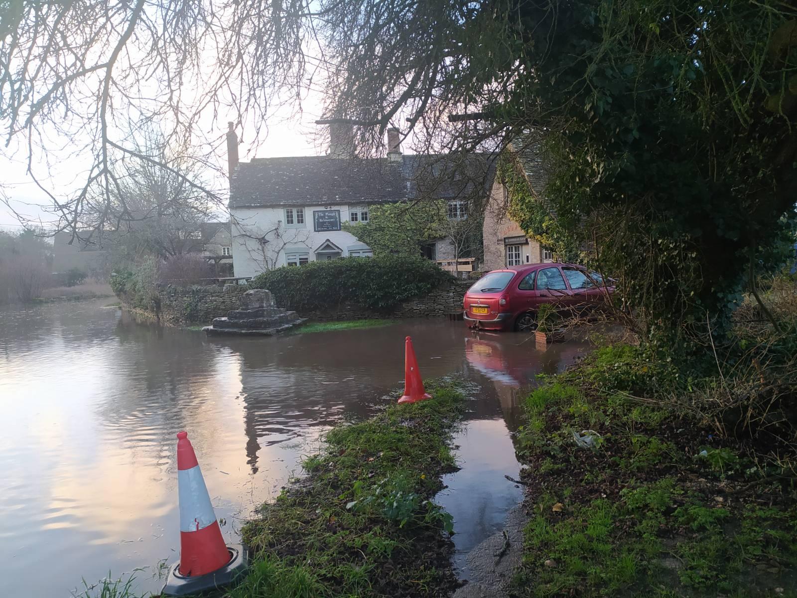

@SteamyTea  - There's certainly plenty of water around at the moment 🙂 Attached a view of the road from the front gate yesterday!  Fortunately gone down today.
Even when there's a drought the water table has never dropped too far to affect the water flow from the borehole, I guess its more like an underground river we've tapped into.   Filters are clean there's no issues with flow rate and the heat exchanger, which stops the dirty water reaching the heat pump, is regularly reverse flushed.

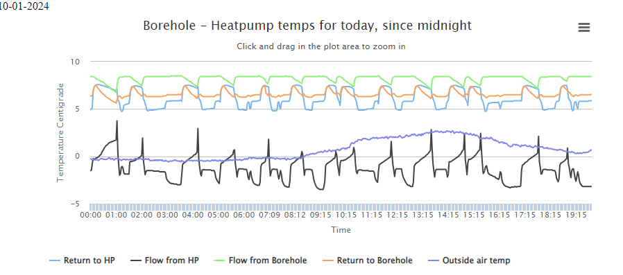

This might help, there are temp sensors on each port of the heat exchanger plus an outside air temp one (darker blue).  I think it shows the glycol circuit (black and pale blue) extracts up to 9 C  which seems very effective, any thoughts? :-
@MKF The graph’s useful, shows the right sort of behaviour from a on/off type of gshp.  While the water loop has about a 2C delta, the glycol loop shown has a 7C delta - indicates the glycol loop could do with a higher flow rate.  For comparison, we have a DT of about 2C input to output of our glycol circuit.  Roughly every 4C drop costs a 10% COP hit.
Given the glycol out of the heatpump is often below zero, is there ice on the pipes?

That's a really useful observation, thanks very much @RobLe,  there's no ice, pipes are well insulated. Now I just have to work out how to increase the flow rate..
