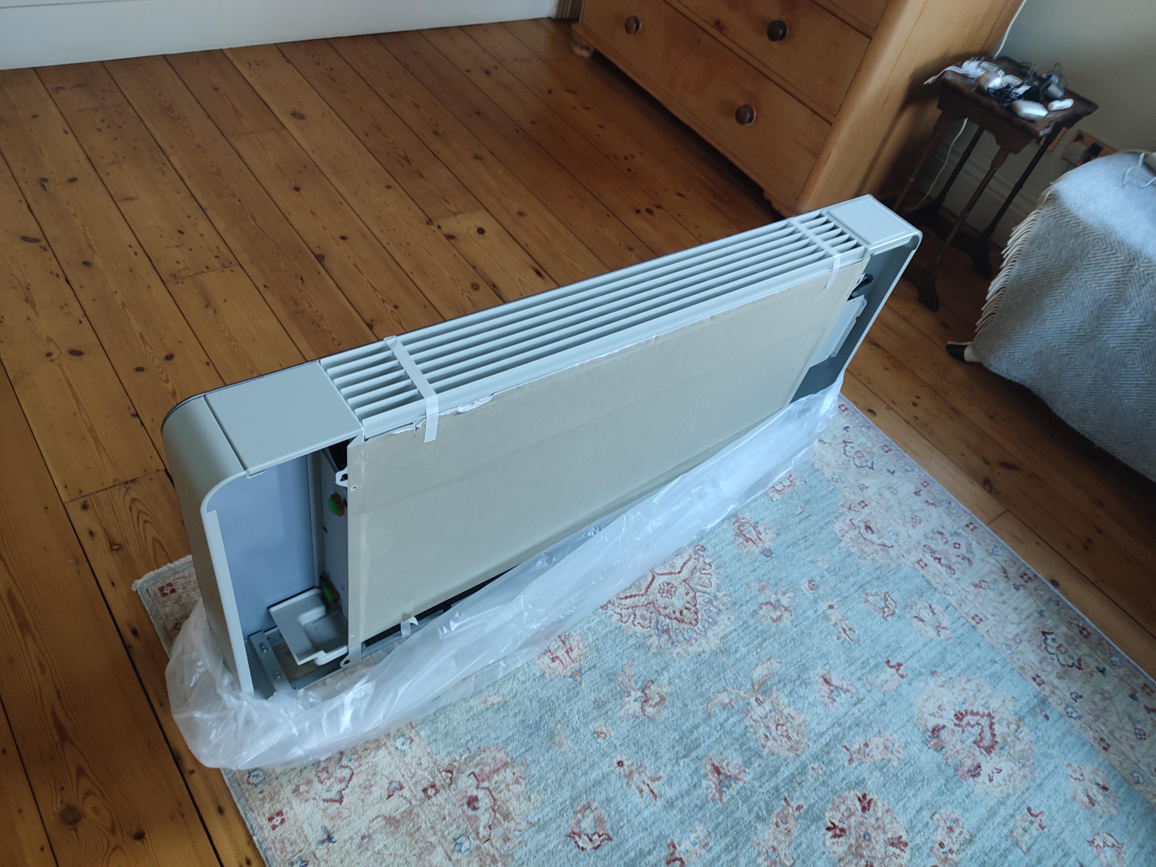

Beelbeebub Posted January 8 Author Share Posted January 8 OK, unit arrived. Well packed. It's a bit of a beast (fs800) slightly over 1200mm wide (a bit wider than spec) and abut under 600mm high. Pretty thin - 120mm as advertised - about the same a k22 rad. Build quality seems good. One interesting thing is the ends are about 150mm wide each and are mostly fresh air. They are for making the hydraulic and electrical connections. But it strikes me most rads have the valves exposed on the side anyway. It's sort of expected so doesn't look odd to most people. So they coukd make a unit with the same performance, but a nominal. 900mm wide (the width of the actual core) and have the inlet and outlet at each side on the bottom, like normal rads. If the ditxhd the fancy glass front for a pressed steel flat front it would d be a pretty standard looking rafiator, just able to provide the same output at a much lower flow. The smiths powerad looks sort of ideal but it's price is a but high and performance wasn't as good on paper. Let's see how it performs. 3 Link to comment Share on other sites More sharing options...
joth Posted January 8 Share Posted January 8 4 hours ago, Beelbeebub said: So they coukd make a unit with the same performance, but a nominal. 900mm wide (the width of the actual core) and have the inlet and outlet at each side on the bottom, like normal rads. The extra shroud is to hide the condensation drip tray isn't it? It generally doesn't look very attractive, esp after residual water has pooled in and then evaporated off it. They really should publish dimensions including the cover though! Thanks for sharing keep us updated. Link to comment Share on other sites More sharing options...
JamesPa Posted January 8 Share Posted January 8 7 hours ago, Beelbeebub said: If the ditxhd the fancy glass front for a pressed steel flat front it would d be a pretty standard looking rafiator, just able to provide the same output at a much lower flow. I don't suppose this comes off? I have dismissed this unit precisely because of the fancy glass front. Otherwise it looks a good match to what I need assuming I eventually get over my planning hurdle. Link to comment Share on other sites More sharing options...
Beelbeebub Posted January 8 Author Share Posted January 8 3 hours ago, JamesPa said: I don't suppose this comes off? I have dismissed this unit precisely because of the fancy glass front. Otherwise it looks a good match to what I need assuming I eventually get over my planning hurdle. Glass front in held on by screws. The original manuf has images of alternative covers. I suppose there is nothing to stop a handy person making their own. Might try it, I'm not 100% sold on the grey look. Might work well in a swanky city flat or Mia I glass cube but not so well in my parent spare room. 😁 Link to comment Share on other sites More sharing options...
