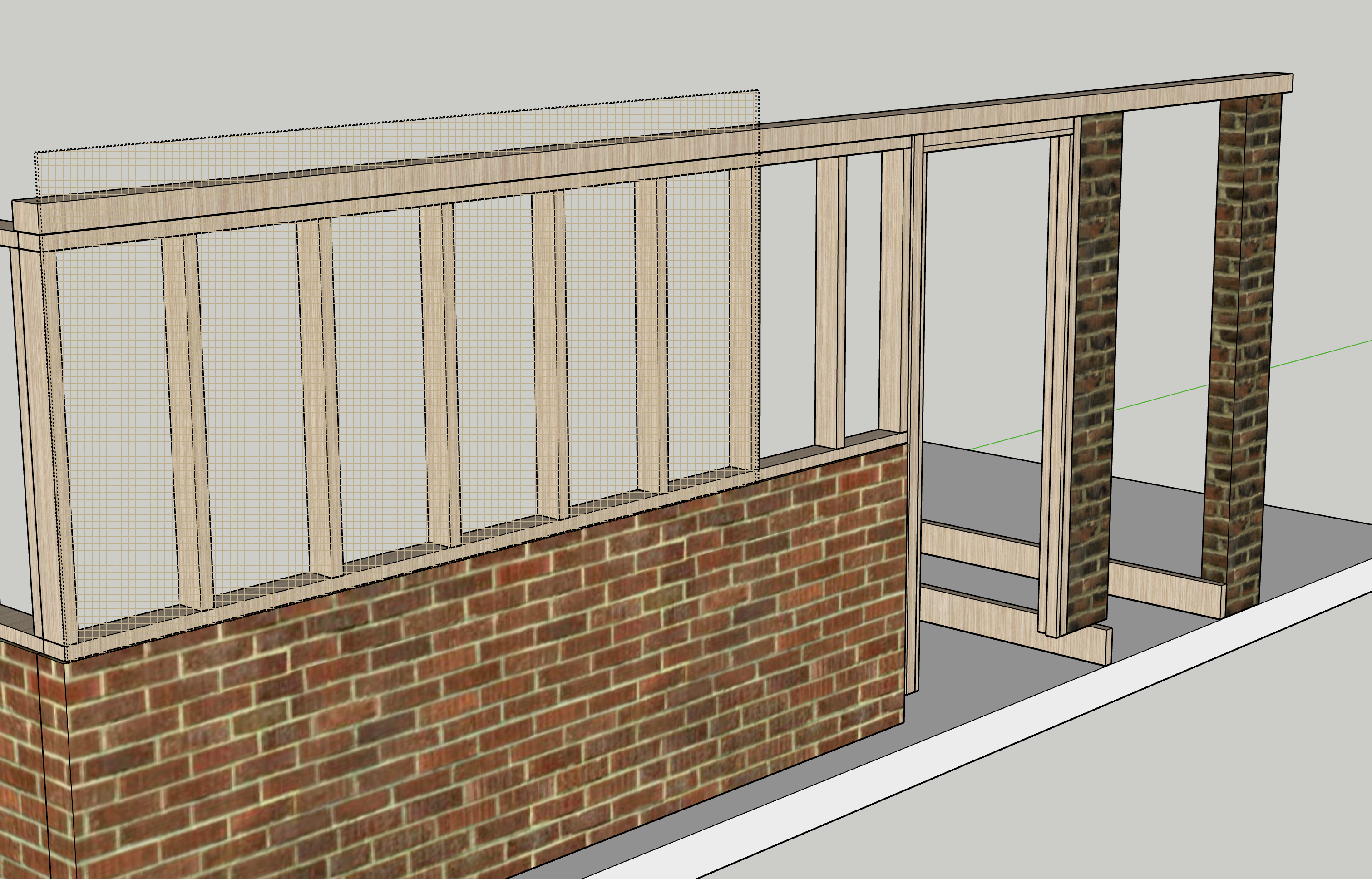

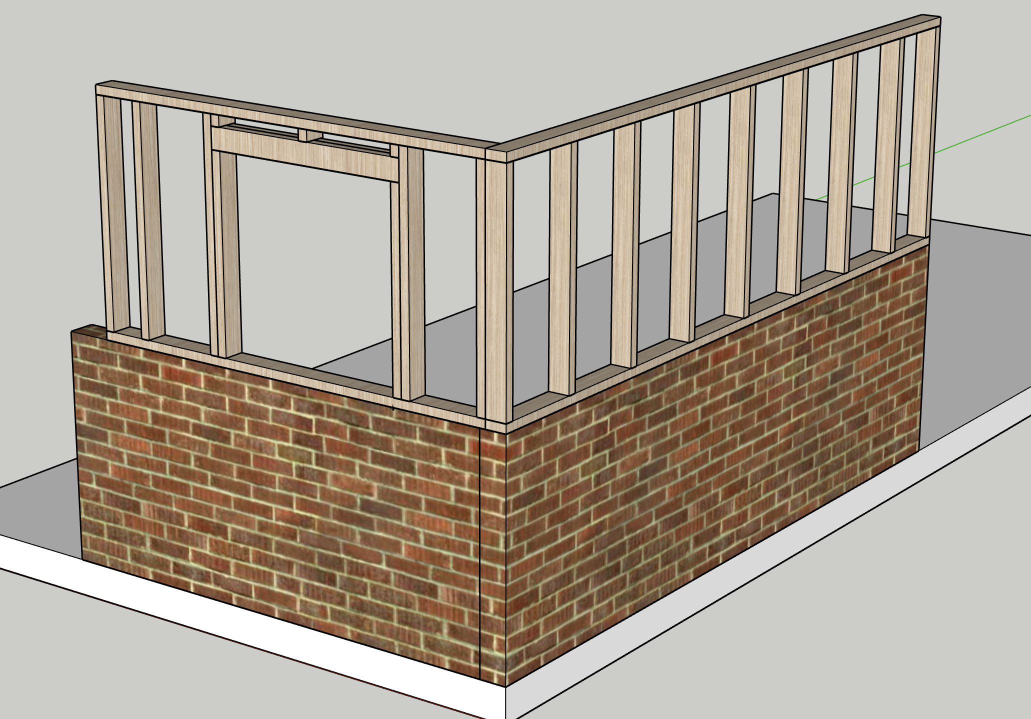

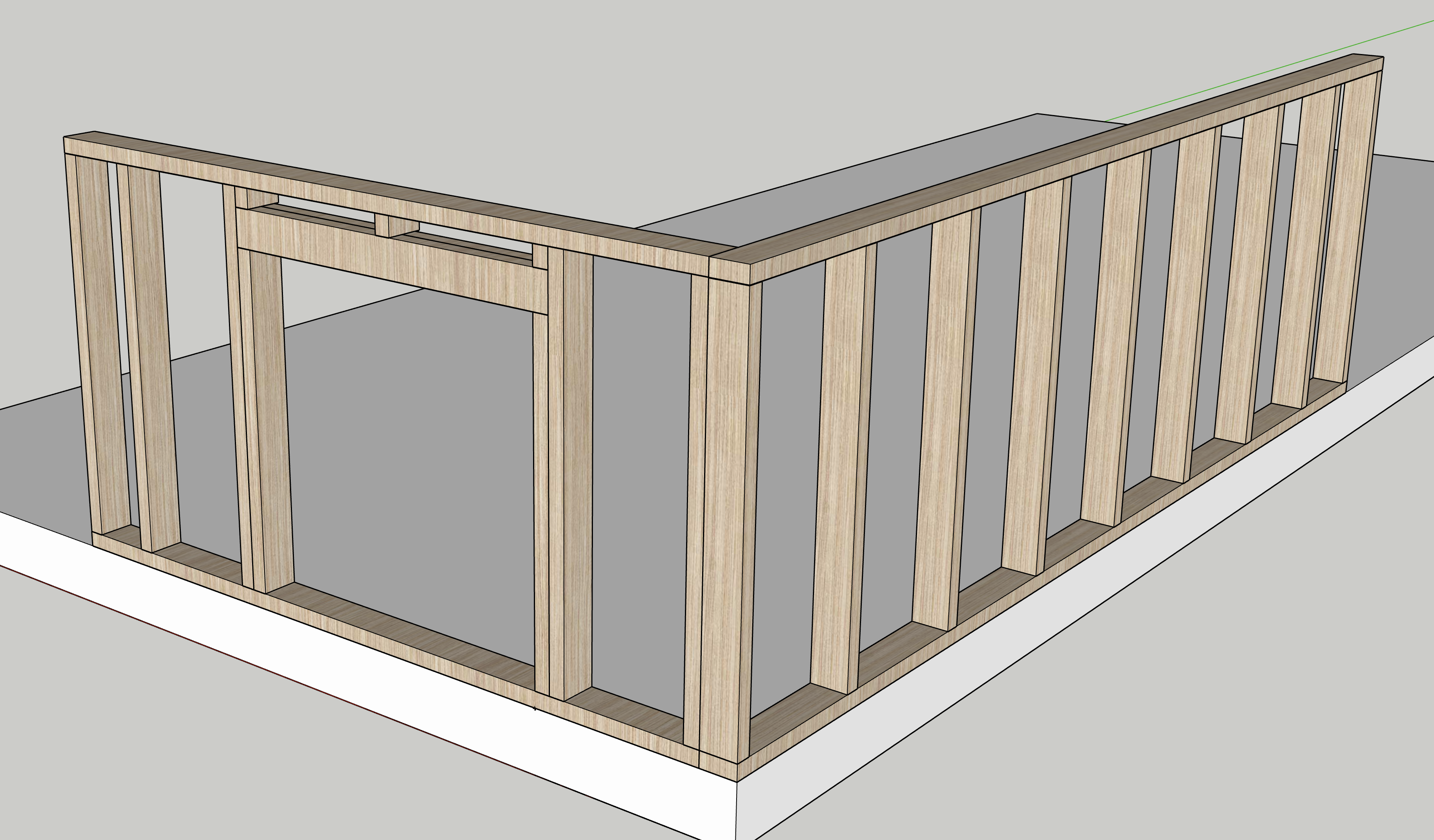

ColdOutside Posted December 29, 2023 Posted December 29, 2023 Hi, I have an existing lean to outbuilding, sloped slate roof chased into third party large stone wall and then 3 sides coming off it made of half brick and wood construction. The wood is currently rotten but 1m height brick wall seems solid with underfelt etc so going to strip roof and rebatten and reroof and then replace the wood framing. First time using sketchup but the attached will sit on existing brick wall. Anyone see any issues? Using 16" centers but gable a little more made up to offset window slightly. Footprint is 3190mm x 1920mm.
ColdOutside Posted December 29, 2023 Author Posted December 29, 2023 The reason for only 2 sides is back long wall is stone as above but bottom end is a self contained brick built outdoor loo with door between last stud and loo. As such I think this is the only framing I need to do bar the awkward triangle bit above the gable window (bit advanced for my sketchup skills)
ColdOutside Posted December 29, 2023 Author Posted December 29, 2023 (edited) I'm actually planning to rain screen the entire building, so as I'm putting 11mm OSB onto the stud only, would it be wise to inset the stud wall be 11mm on both sides so that the clad battens go top to bottom without an 11mm spacer on the brickwork? Edited December 29, 2023 by ColdOutside

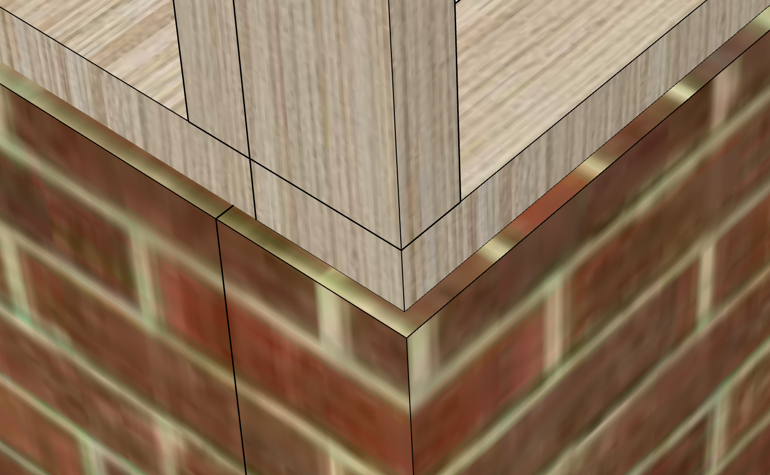

Russell griffiths Posted December 29, 2023 Posted December 29, 2023 That sketch is very basic. It could be that’s just how you have drawn it up. For instance look at the corner and work and work out how your internal wall covering will be fitted the way it is drawn you do not have a stud to fix to, externally you do but internally you don’t. You normally do a two stud corner to turn a 90 degree, or if you want to insulate it you do what’s called a California corner. Setting it in 11mm sounds like a plan, don’t forget a weather barrier to the outside under the battens. And some sort of insect barrier to the batten area.
ColdOutside Posted December 29, 2023 Author Posted December 29, 2023 Can you confirm how it's basic? Only missing noggins, right? Roof structure not required as making good with what's there. You're right about the missing stud on this nearside corner for the internal OSB. I forgot to add really. I was planning on doing a 90 degree stud so the gable wall can fix onto and also the internal OSB. Would there be a cold spot in the corner as I plan to use 90mm solid insulation so this will not wrap around the 90 degree stud?

Russell griffiths Posted December 29, 2023 Posted December 29, 2023 California corner, allows insulation into the corner, if that’s what you need. Frame not connected at top plate, so either a double top plate or the plate holding the roof up will do. Without seeing the rest of it it’s hard to tell, probably immaterial if it’s just a bit of an out building it’s probably fine.
ColdOutside Posted December 29, 2023 Author Posted December 29, 2023 (edited) So I'm slotting the frame under the existing top plate which holds the roof joists, hence why I've not done a double as it runs the whole length of outbuilding. I'm trying to do stuff properly, but I am a complete novice so welcome as much advice as possible. It's an old lathe workshop that I'm turning into an office. Edited December 29, 2023 by ColdOutside

ProDave Posted December 29, 2023 Posted December 29, 2023 Your "2*4" will actually be 195 * 47mm Be careful. OSB sheets are available in 8ft by 4ft or 2400mm by 1200mm. As far as I know (someone tell me if otherwise) plasterboard is only available in 1200mm wide not 4ft, and usually in 2400mm long not 8ft (though can be bought in longer sheets) 16" is 406mm. So over 3 studs that will be 1218mm. By the second or definitely third sheet of plasterboard the joints will miss the studs.

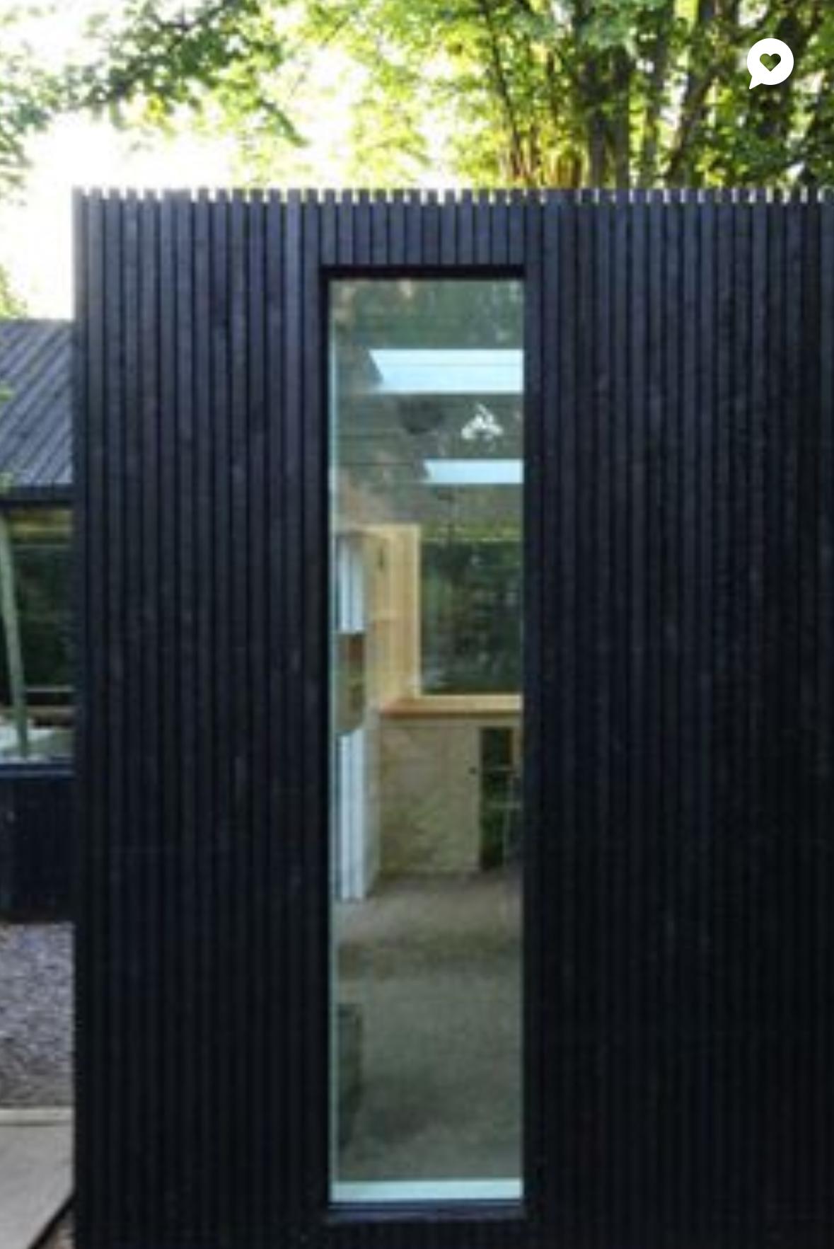

ColdOutside Posted December 30, 2023 Author Posted December 30, 2023 I was actually half opting to save costs as less clad material in theory, due to gaps. 1 roll of this — https://www.ecologicalbuildingsystems.com/product/solitex-fronta-quattro ~£400 70mm clads * 85 — https://www.timberulove.co.uk/products/siberian-larch-charred-cladding-battens-a-grade-22mm-thickness-square-edge/?attribute_dimensions=20+mm+x+70+mm+x+3000+mm+-+£13.73 ~ £1.1k £1,5k total for clad, plus the little extras. Can the above look be done cheaper? Think it's roughly 20sqm.
Mr Punter Posted December 30, 2023 Posted December 30, 2023 1 hour ago, ColdOutside said: Can the above look be done cheaper? Think it's roughly 20sqm. Yes, you could do it in natural slate. Won't fade or warp and will last longer than most of us.
ColdOutside Posted December 30, 2023 Author Posted December 30, 2023 Not sure natural slate would really resonate with a black timber vibe.
