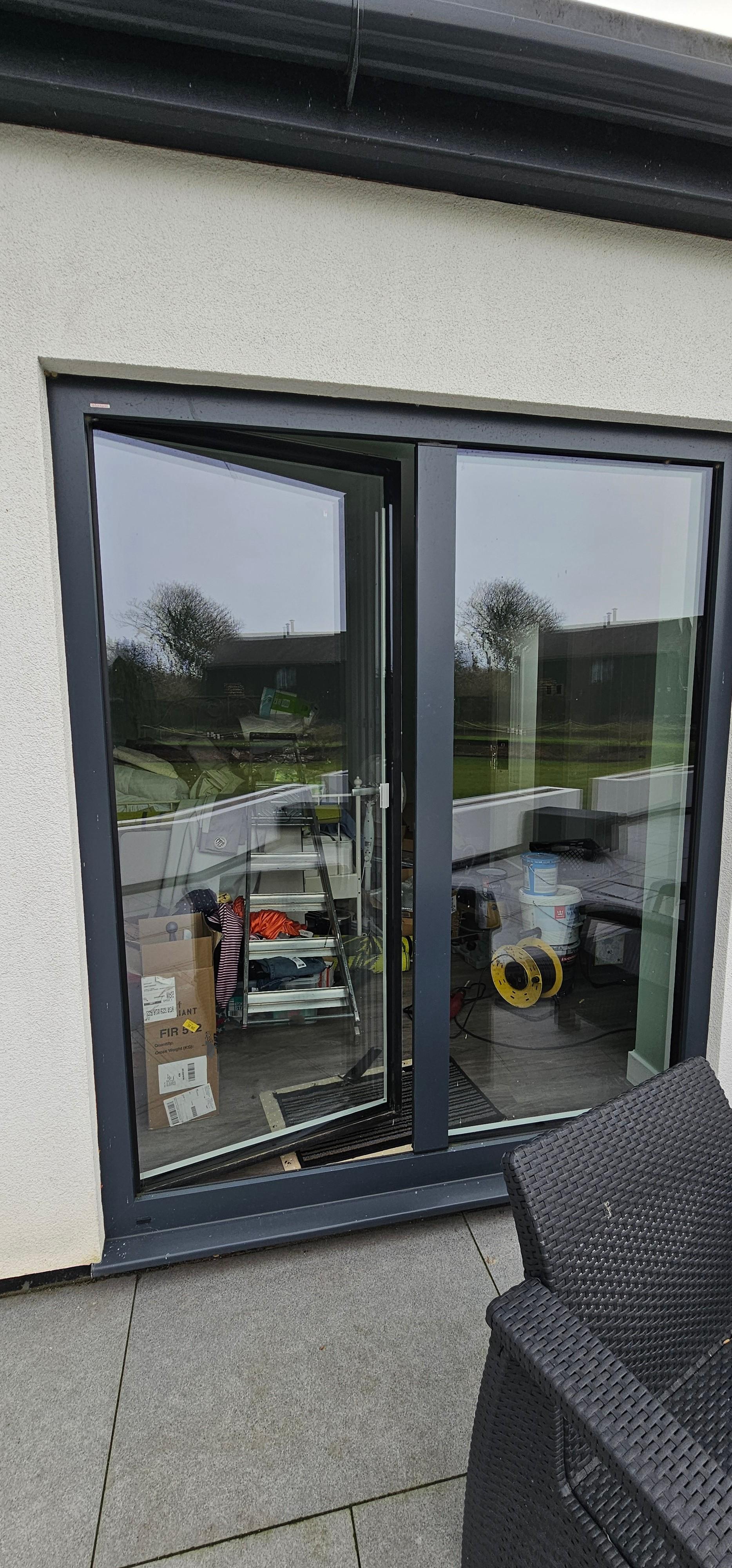

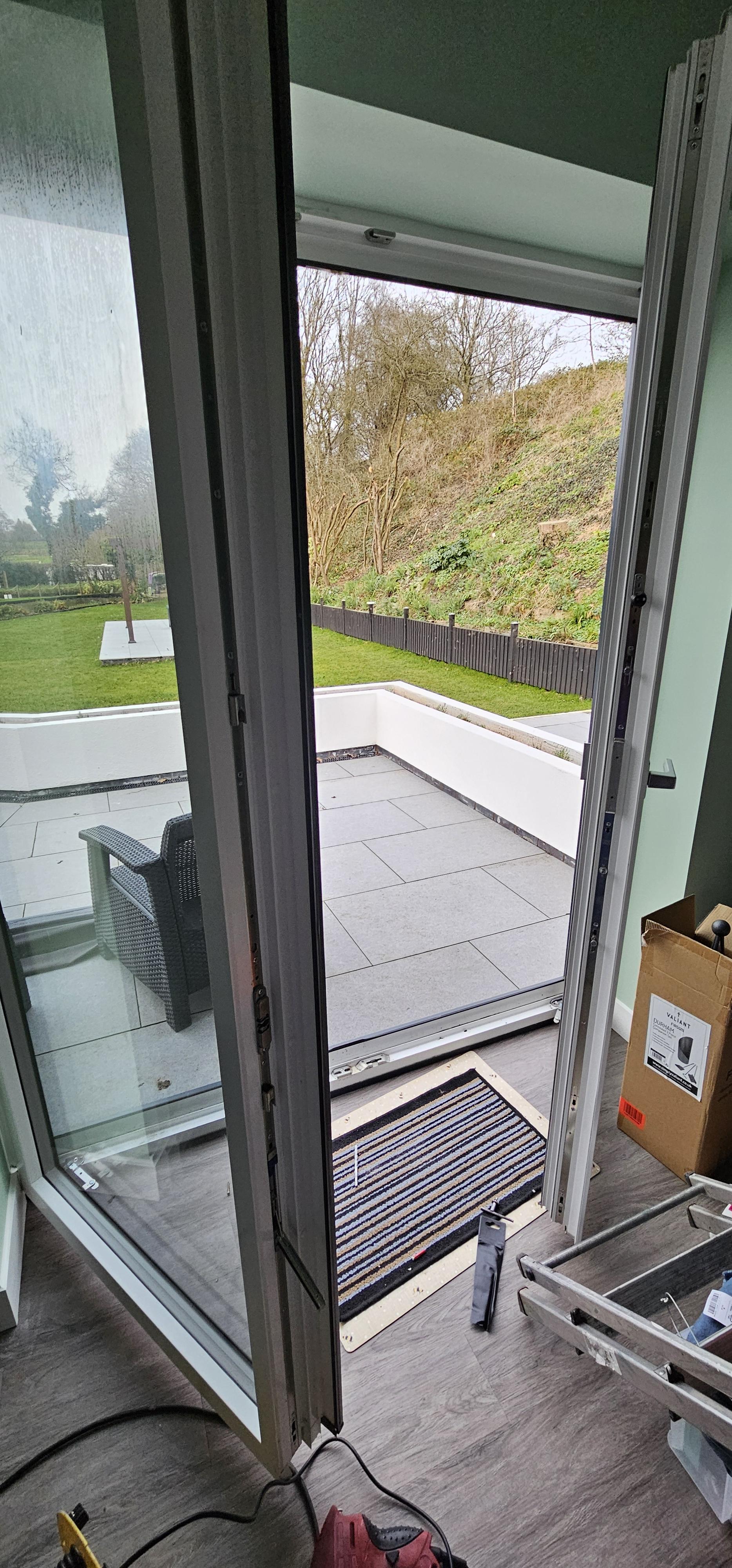

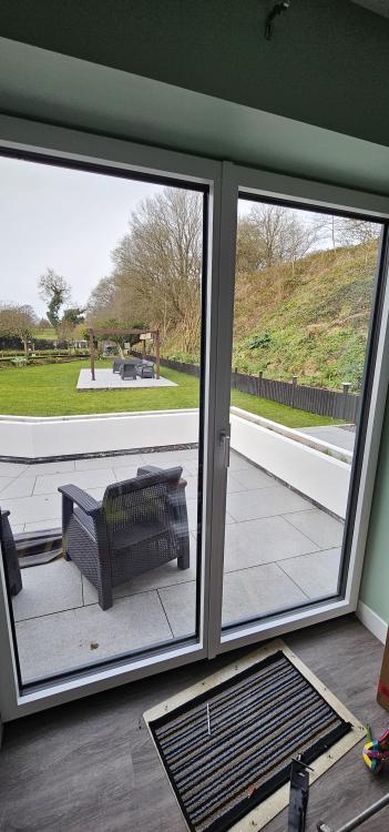

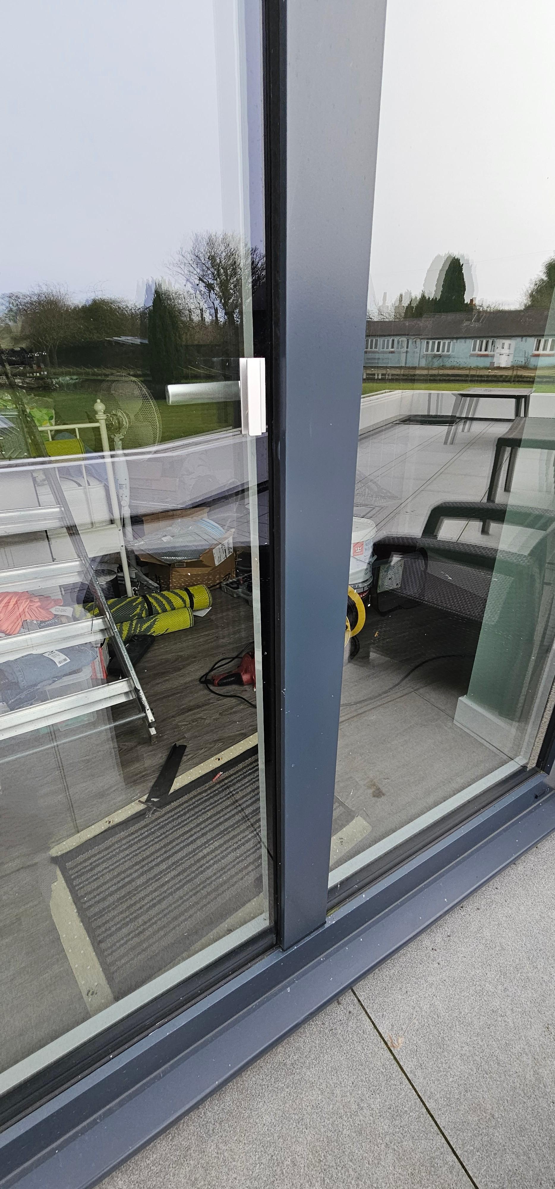

canalsiderenovation Posted December 26, 2023 Posted December 26, 2023 Righty, here's a conundrum. We have a bedroom/ensuite in our house which we are thinking of doing as an Airbnb. The bedroom door has a key lock on it which means access to the rest of the house can be prevented. It also has a window/door onto the patio. In essence this can be a separate entrance so is ideal for guests. The issue we have is that when we had it fitted (Internorm) they didn't do anything that could be locked. From inside the bedroom the right side as you look at the photo can be operated like a tilt and turn window so you can either use it as a window or door and the left side has a catch to open that side and both open inwards. From outside there is a little catch to open and close the door so if you just left the bedroom you can shut the door and then go back in but there is no way of locking it. Obviously if we had guests they would want to secure the room (even though we would likely only do Airbnb when we were around). Is there any way of retrofitting something, ideally without drilling into the frame?

craig Posted December 31, 2023 Posted December 31, 2023 (edited) This is essentially a balcony window, it has standard window hardware and not a multipoint locking system. I'm rather surprised they said they didn't have anything as it's basically a French door, you'll have a lever to open the secondary window. A French door is the same thing, just slightly bigger frames on the sashes. It can be changed, it's a bit of a ballache but it can be done but it does mean you need new sashes and someone with a bit of knowledge on how to do it. I can gaurantee they'll say it can't be done but it can. Edited December 31, 2023 by craig 1
canalsiderenovation Posted January 3, 2024 Author Posted January 3, 2024 On 31/12/2023 at 17:41, craig said: This is essentially a balcony window, it has standard window hardware and not a multipoint locking system. I'm rather surprised they said they didn't have anything as it's basically a French door, you'll have a lever to open the secondary window. A French door is the same thing, just slightly bigger frames on the sashes. It can be changed, it's a bit of a ballache but it can be done but it does mean you need new sashes and someone with a bit of knowledge on how to do it. I can gaurantee they'll say it can't be done but it can. John Knight glass rung me today and said they couldn't do anything, infact they said they would have to take the whole thing out and replace it! I'm going to try Internorm directly. 1

Mr Punter Posted January 3, 2024 Posted January 3, 2024 We have quite a few inward opening tilt turns and it would be useful to have an external handle / lock, but I think the only option is replace whole unit. You can't just chisel out a triple glazed ali sash. 1

canalsiderenovation Posted January 5, 2024 Author Posted January 5, 2024 Some success, Internorm directly have responded (I have their Techinal Managers details after he came and sorted some issues with a fingerprint sensor on our front door) and they say it can likely be done, that said they are just waiting for JK to provide the specific order details of the original item to double and then we can get a quote from Internorm (will involve a visit from their Service Department). 3
craig Posted January 7, 2024 Posted January 7, 2024 I know it can be done and it will not compromise the existing frame, we’ve done this ourselves a few times (with Internorm and Gaulhofer). I know you’ll get the answers you’re looking for but the cost to do so may be the stumbling block.
