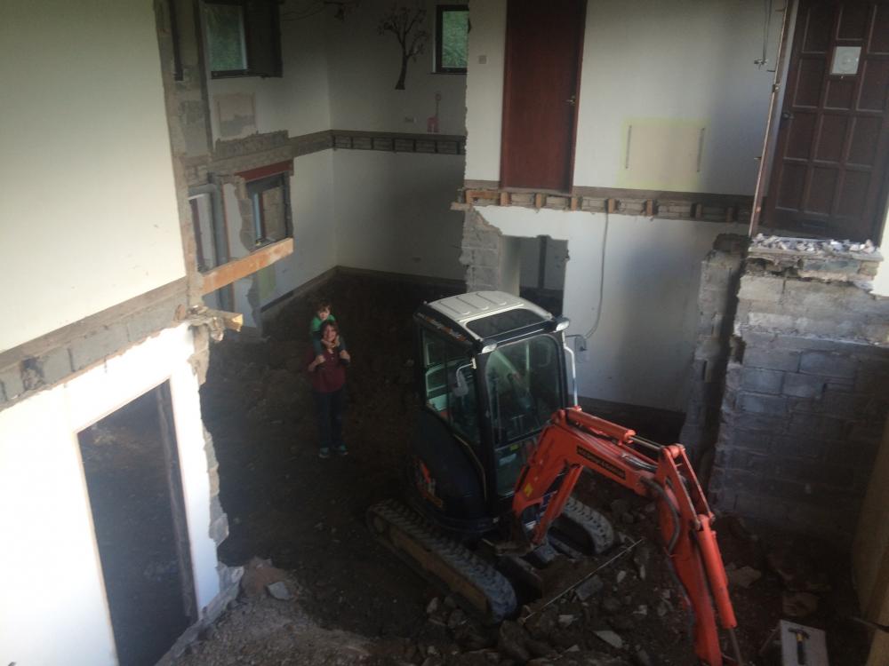

Lesgrandepotato Posted September 17, 2017 Posted September 17, 2017 Interesting. We had to pay full council tax for the entire renovation as the property was not eligible for a payment holiday. Does this look inhabitable?
Jeremy Harris Posted September 17, 2017 Posted September 17, 2017 3 minutes ago, Lesgrandepotato said: Interesting. We had to pay full council tax for the entire renovation as the property was not eligible for a payment holiday. Does this look inhabitable? I think your problem is that the property was already on the valuation list, and so had already been deemed an hereditament. Not sure how you can undo this after the event, but I seem to remember reading somewhere that there might be a way to have a property taken off the list. The snag then is that it would need to be revalued by the VOA on completion, and they may well put a higher value on it that it has now.
ProDave Posted September 17, 2017 Posted September 17, 2017 If it's on the list in your name and you extend it, then the valuation and banding does not change until it changes ownership so you night be better off just paying it at the old rate. If as pointed out you get it off the valuation list, then you can be sure it will be in a higher band when it is re listed later on. Our static van is on the list now. If we suddenly moved out to live back in our old house, I can't see any way to get that off the list short of removing it from the site so that is stuck on the valuation list now until the new house is complete.

Triassic Posted September 18, 2017 Posted September 18, 2017 On 17/09/2017 at 15:35, Lesgrandepotato said: Interesting. We had to pay full council tax for the entire renovation as the property was not eligible for a payment holiday. Does this look inhabitable? I think you were done! from the South Lakes Council web site.. Uninhabitable and vacant properties Two classes of 'local' discount have been available since 1 April 2013. We have set this discount at 100%. uninhabitable property that requires, or is undergoing, major works to render it habitable, or is undergoing structural alteration. This discount will apply for a maximum period of 12 months (as long as the property remains unoccupied and unfurnished)
Lesgrandepotato Posted September 18, 2017 Posted September 18, 2017 Yep - I think we were, the property had received a payment holiday in the past with another owner and apparently this means we cannot have a payment holiday...
