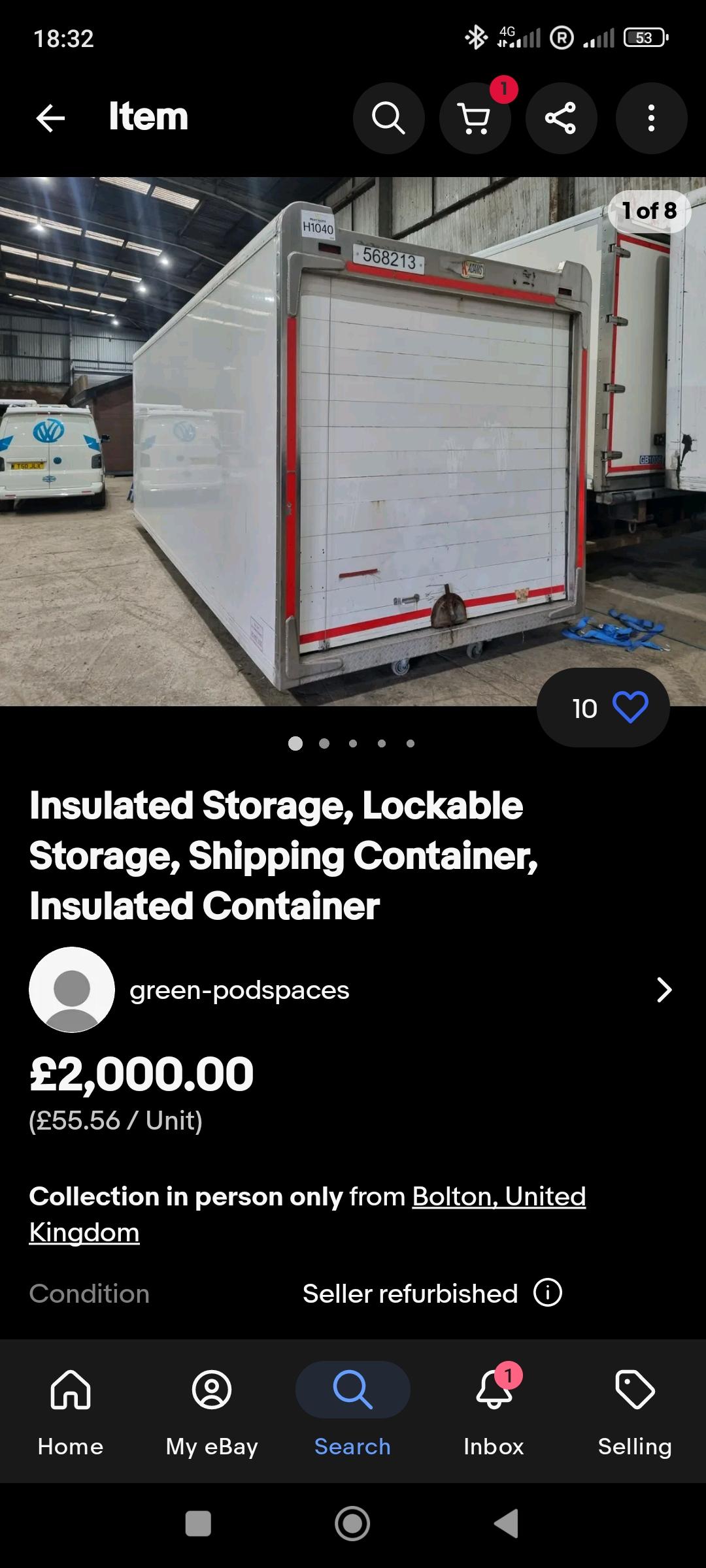

Iceverge Posted December 11, 2023 Share Posted December 11, 2023 For a building that is lightly to be occupied constantly I would be cautious if containers. I had a brief look a out 8 years ago. Some of the paints are carcinogenic and the insect repellent used for the flooring is pretty toxic too. Have you considered an old refrigerated body from a truck. Already insulated and used for food so quite safe. 2 Link to comment Share on other sites More sharing options...
Chris HB Posted December 11, 2023 Author Share Posted December 11, 2023 4 hours ago, Iceverge said: For a building that is lightly to be occupied constantly I would be cautious if containers. I had a brief look a out 8 years ago. Some of the paints are carcinogenic and the insect repellent used for the flooring is pretty toxic too. Have you considered an old refrigerated body from a truck. Already insulated and used for food so quite safe. I did briefly look at ex-refrigerated containers which I guess are similar? Link to comment Share on other sites More sharing options...

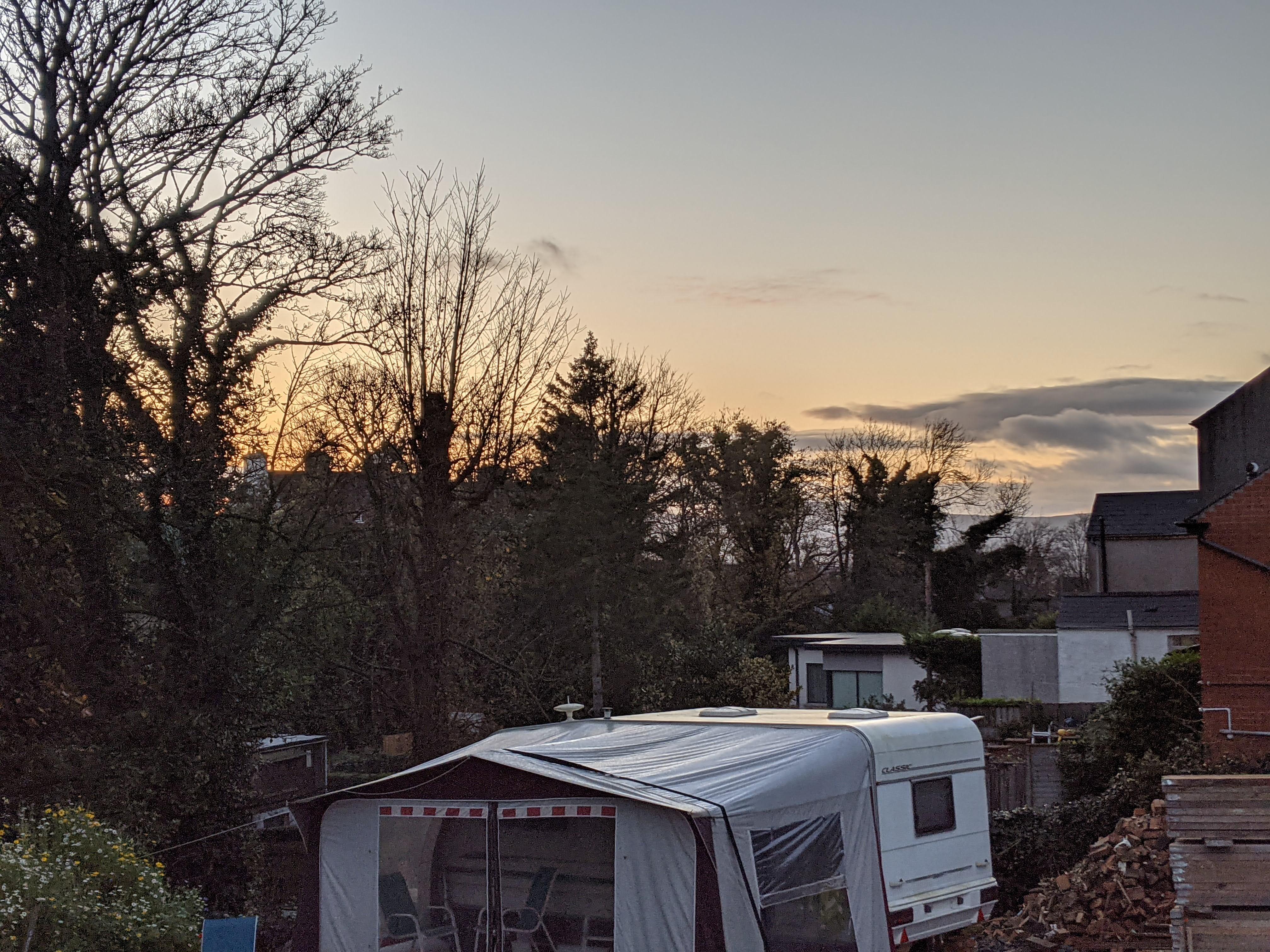

Conor Posted December 11, 2023 Share Posted December 11, 2023 (edited) Would not recommend for office space. Metal box. No phone or WiFi. Get a container for storage, and a second hand touring caravan for office. We sold ours on two years later and only a £400 loss. Having a fridge and cooking area to yourself is invaluable on a muddy, cold wet site in he middle of winter. Ours had an awning so good for the summer and drying wet gear. Edited December 11, 2023 by Conor 1 Link to comment Share on other sites More sharing options...
joe90 Posted December 11, 2023 Share Posted December 11, 2023 24 minutes ago, Conor said: Would not recommend for office space. Metal box. No phone or WiFi. Get a container for storage, and a second hand touring caravan for office. We sold ours on two years later and only a £400 loss. Having a fridge and cooking area to yourself is invaluable on a muddy, cold wet site in he middle of winter. Ours had an awning so good for the summer and drying wet gear. +1, and you can use the container next to the caravan to shield it from the worst wind direction, jack up the caravan on blocks so it does not rock and chain it down. 1 Link to comment Share on other sites More sharing options...

Chris HB Posted December 11, 2023 Author Share Posted December 11, 2023 56 minutes ago, joe90 said: +1, and you can use the container next to the caravan to shield it from the worst wind direction, jack up the caravan on blocks so it does not rock and chain it down. I had thought about your and @Conor suggestion about a caravan, I have seen a static used like this and that had some serious strapping on it to try and keep it in place! Link to comment Share on other sites More sharing options...

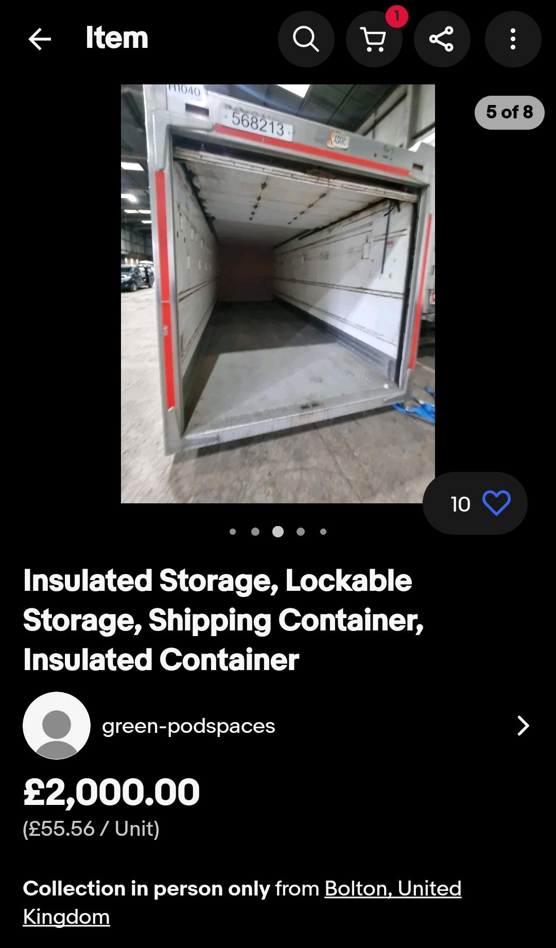

Iceverge Posted December 12, 2023 Share Posted December 12, 2023 (edited) That's the one. Frame a uPVC window/door 1m inside the roller door when you want to use it as an office and you'll have a lockable sheltered porch. Edited December 12, 2023 by Iceverge 2 Link to comment Share on other sites More sharing options...
Chris HB Posted December 12, 2023 Author Share Posted December 12, 2023 3 hours ago, Iceverge said: That's the one. Frame a uPVC window/door 1m inside the roller door when you want to use it as an office and you'll have a lockable sheltered porch. Thanks @Iceverge that looks interesting. So I would just need to find someone willing/able to get in from Bolton to the Isle of Lewis then… Link to comment Share on other sites More sharing options...
saveasteading Posted December 12, 2023 Share Posted December 12, 2023 2 hours ago, Chris HB said: from Bolton to the Isle of Lewis By default it fits on a flatbed. So it's just the cost! Perhaps find if your local haulier can fit in a delivery the other direction. 1 Link to comment Share on other sites More sharing options...
