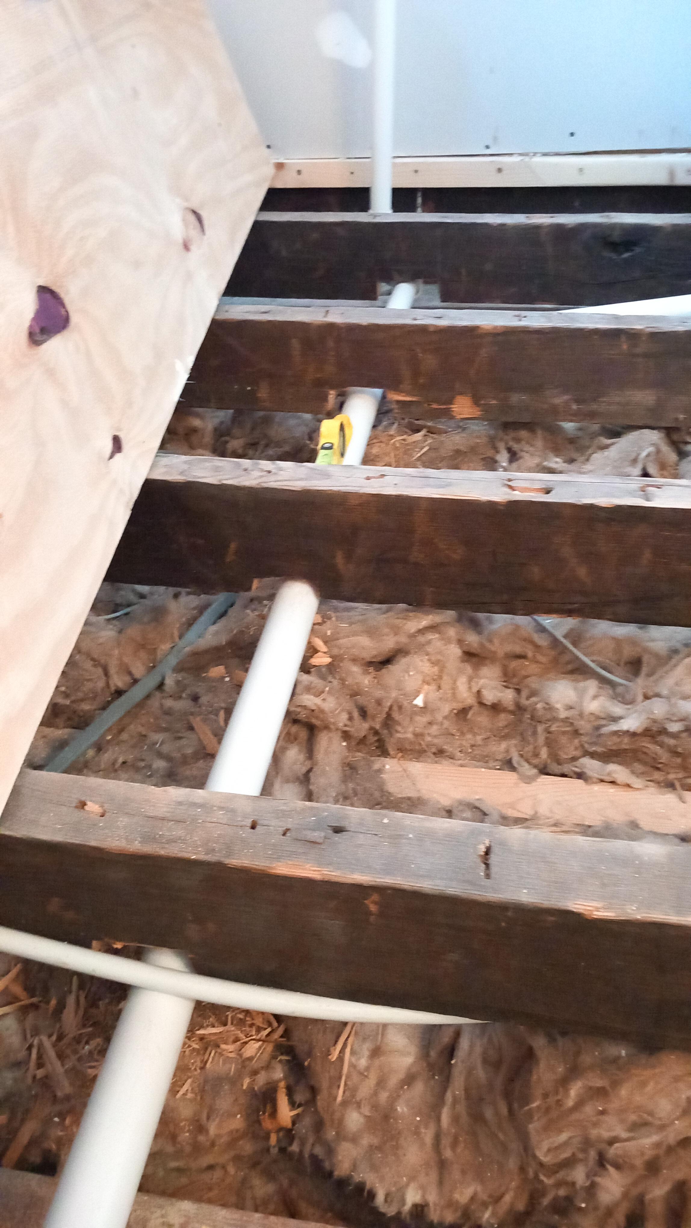

Dee Posted December 1, 2023 Posted December 1, 2023 To get enough fall into the waste pipes that 'someone else' laid I've notched out the underside of 5 joists! Sorry! The joists are 6 x 2 x 8ft and about 60yrs old. The deepest notch is 30mm shallowing on each subsequent joists. The notches are about 18" from the wall. Have I done a major boob?? How do I strengthen them? Panicking!

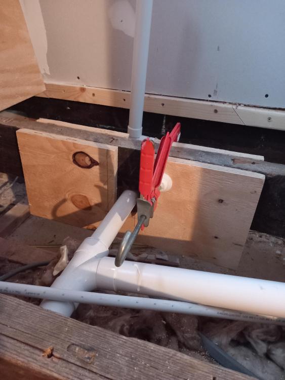

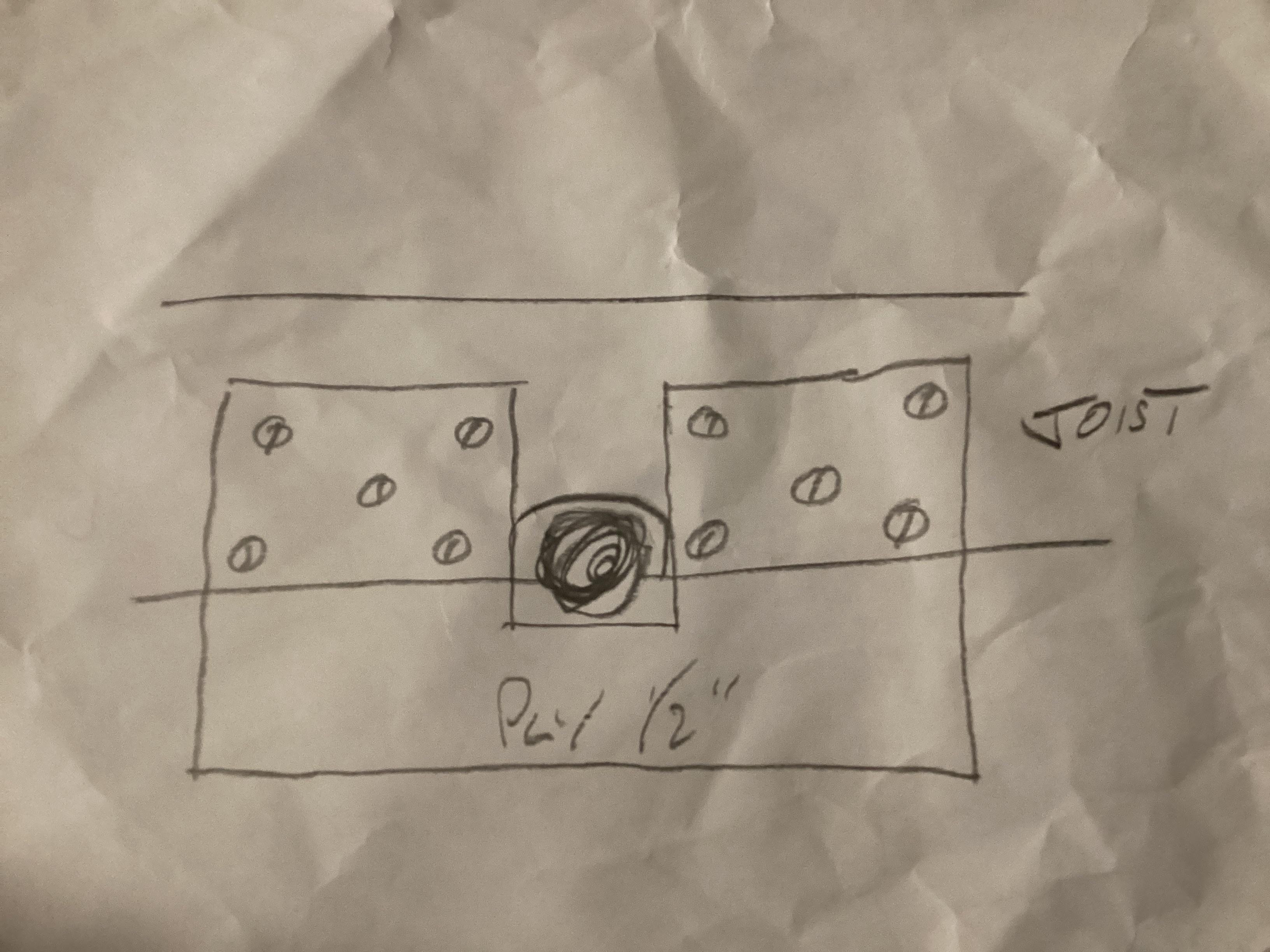

joe90 Posted December 1, 2023 Posted December 1, 2023 So it’s over the recommended depth of cut, however I would offer this solution., 1/2” ply, glued and screwed both sides of the joist. excuse the CAD (crayon assisted drawing). 1 1
Conor Posted December 1, 2023 Posted December 1, 2023 Just sister it up with a similar size piece of timber on one side. Or even ply as Joe suggests.
Dee Posted December 1, 2023 Author Posted December 1, 2023 Along the whole length or just around the notch?
joe90 Posted December 1, 2023 Posted December 1, 2023 Just around the notch ( about 300mm total length will do) 1

joe90 Posted December 1, 2023 Posted December 1, 2023 3 minutes ago, Mattg4321 said: Pretty sure no notches are allowable to the underside of joists. Only to the top My suggestion above will mitigate that . 1

Dee Posted December 2, 2023 Author Posted December 2, 2023 3 hours ago, Redbeard said: Have I misunderstood? Why not? I think I'm confusing everyone as usual. My scenario is there are floor joists, then a void beneath then ceiling joists of the kitchen below. Therefore my pipes run in the void but there is not enough 'space in the void to get fall so I had to notch on the underside of those joists to achthe fall needed. I now realise I should not have notched!

Dee Posted December 3, 2023 Author Posted December 3, 2023 This is what I can't undo! Im such an arse

joe90 Posted December 3, 2023 Posted December 3, 2023 I maybe wrong but I cant see any supports fir that pipe., if not hot water in it may make it sag over time, if you do the “ply” thing I suggested earlier this will also support the pipe 👍 2 birds with one stone and all that 🤷♂️ 1

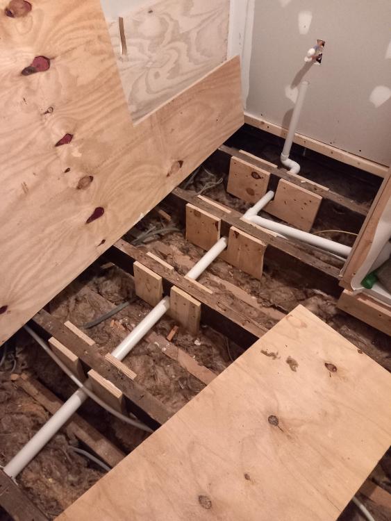

saveasteading Posted December 3, 2023 Posted December 3, 2023 I say that you should take it seriously, for strength and deflection. That 20% depth reduction is taking away 1/3 of the strength, and it will be bouncy. As above, fix a timber or ply to the side, or both sides. Jump hard on it before and after and note the difference. There's no reason to skimp, so make it 600mm long , or even more. And use plenty of screws. 1 1
Andehh Posted December 3, 2023 Posted December 3, 2023 Aa said, I've seen worse and you'd be amazed at what plumbers will do butchering their way through these, only to then hide it below some ply and tiles!! Sister joists, glued and screwed well and forget about it! 1 1
Dee Posted December 3, 2023 Author Posted December 3, 2023 Thankyou boys for your invaluable advice and encouragement! I will sister the joists as I had planned to do anyway SimonD@ no bath, will be a rarely used ensuite.
