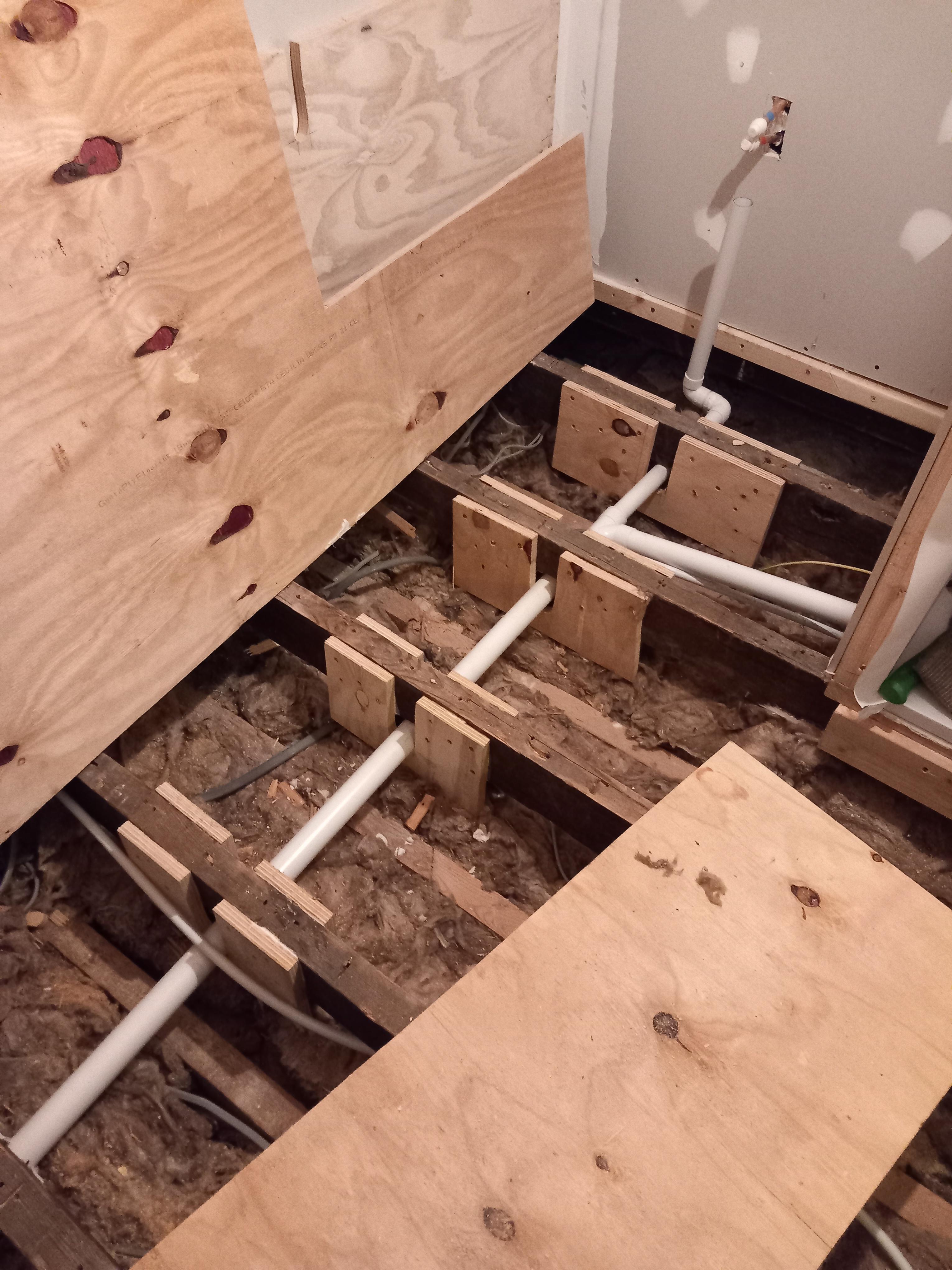

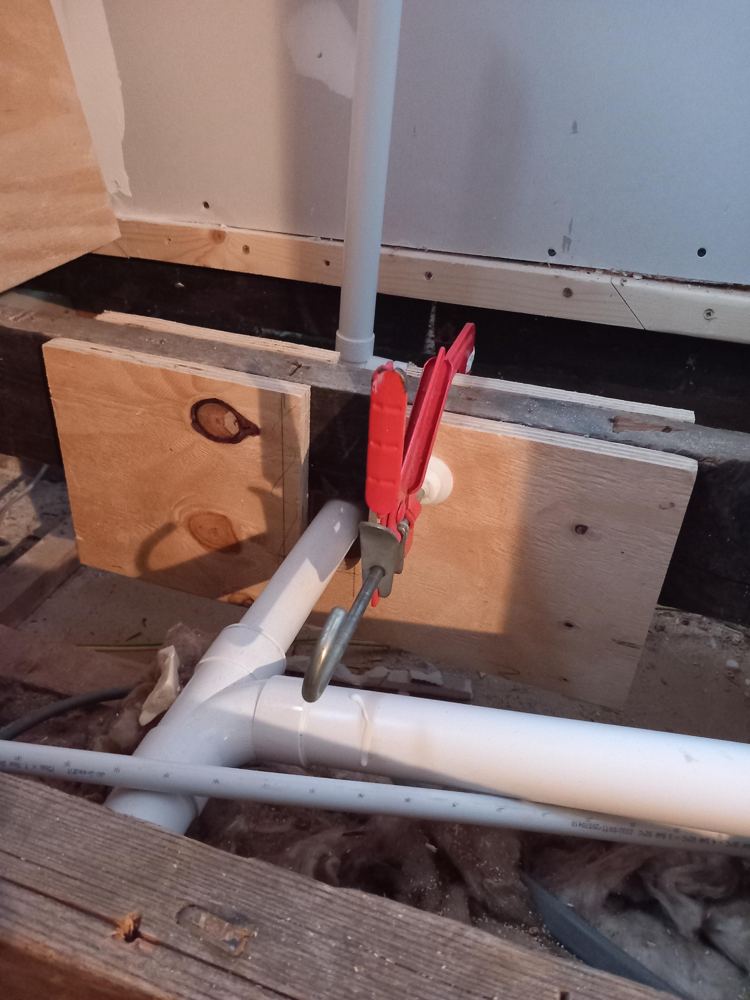

I maybe wrong but I cant see any supports fir that pipe., if not hot water in it may make it sag over time, if you do the “ply” thing I suggested earlier this will also support the pipe 👍 2 birds with one stone and all that 🤷‍♂️
I screwed brackets under the joists to support the waste....is that sufficient?

Ah could not see those, yes but as said above sistering or ply will mitigate any risk of the timber You removed.

When I had to add some 'sister' joists in my first floor extension to strengthen the existing joists, my Building Inspector suggested using M12 bolts with these double-sided toothplate washers 'sandwiched' in-between the existing and new timbers:-
