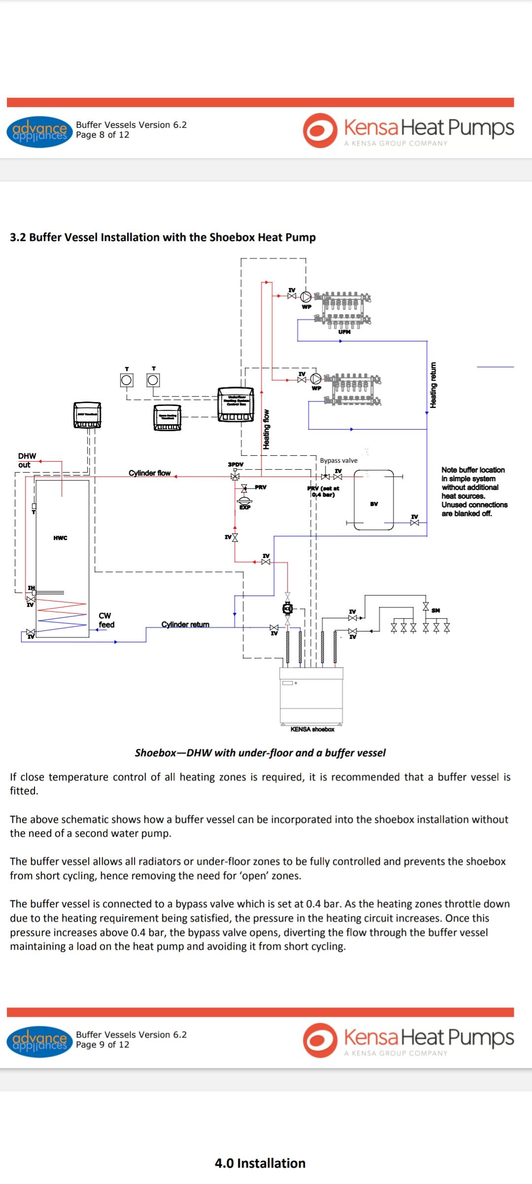

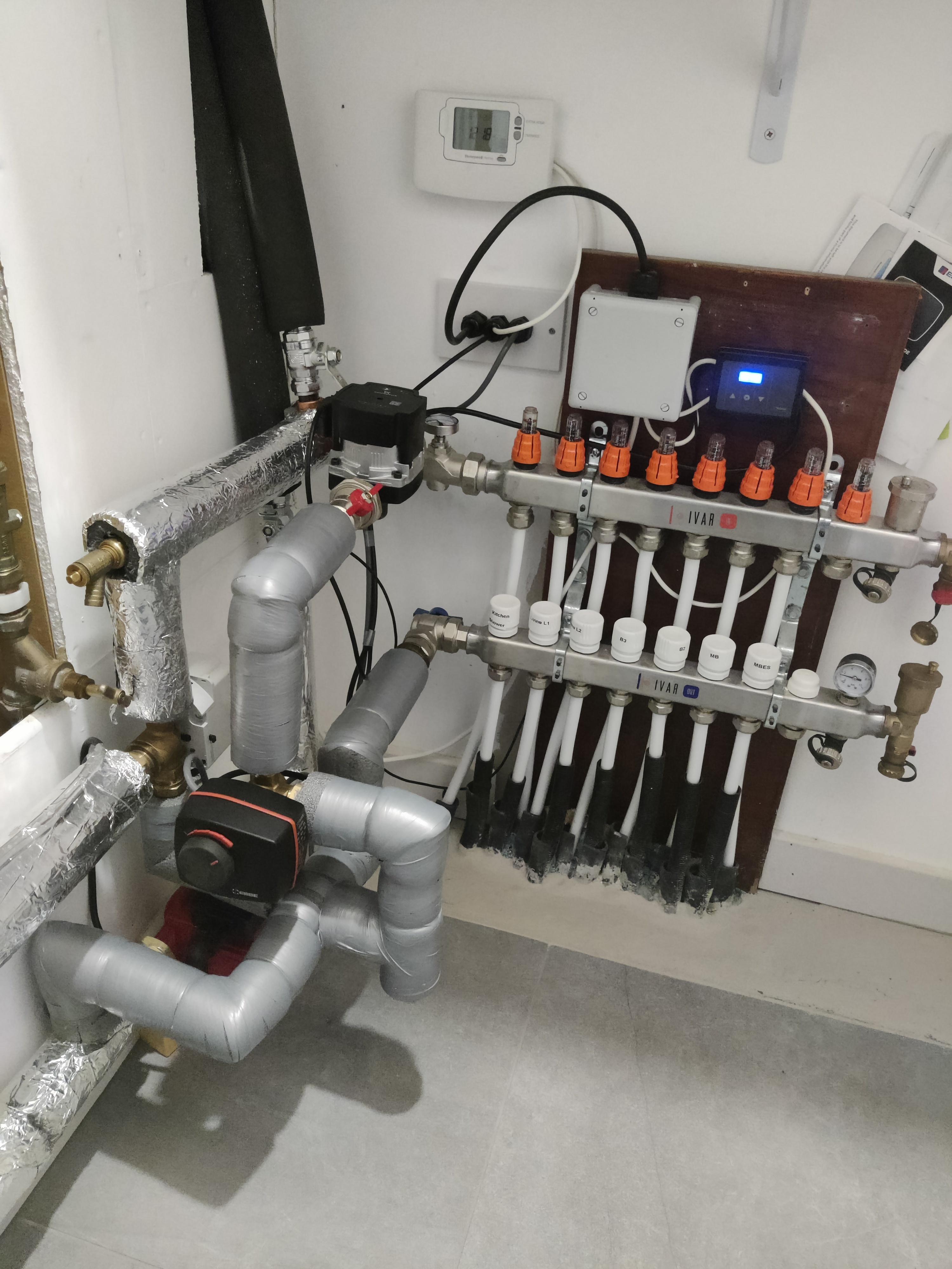

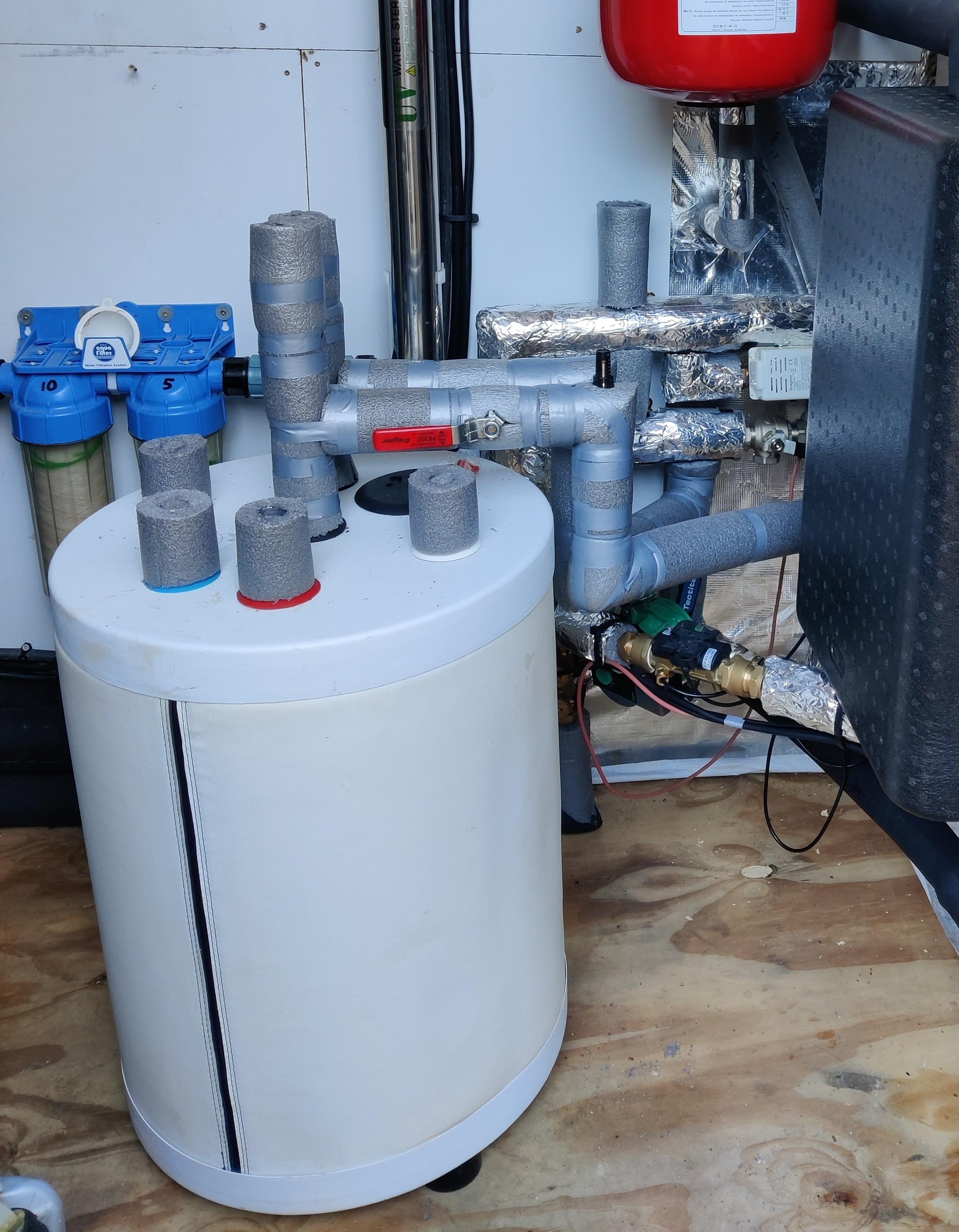

JohnMo Posted December 2, 2023 Author Posted December 2, 2023 That's all the electric stuff done. The thermostats (2x) installed and working, the ESBE controller, mixing valve and actuator have all been hooked up and working during a dry test. Pump control is via the mixer valve microswitch, when mixing valve is closed i.e. no heat required, pump switches off. The closed mixing valve is a tight shutoff so will function as zone valve also. Buffer filled with 20% antifreeze mix. It will have the by-pass valve installed and will be installed on the garden room side of a 2 port actuated zone valve. So only engaged with with a garden room heating only. ESBE controller will manage the house flow temperature based on house temperature, you can set two temperatures and time them. You can limit the max flow temp so as not to damage anything. Using the controller dry, if the target temperature is higher than actual temp, over a 10 minute period the the mixer fully opens the hot flow and closes the recycle flow. Am using the house and or summer house thermostat, so either can switch on the heat pump, both are required to have no heat demand to switch off the heat pump.
JohnMo Posted December 5, 2023 Author Posted December 5, 2023 So everything install a few days ago. With mixed results, couldn't get the garden room UFH to provide enough heat, to heat the room, above 12 degs. So have decided to use the floor heat to limit downwards heat loss, it will act passively not call for heat or switch it off, if on. House UFH with ESBE electronic mixer is great. Basically decided to run in set temperature mode, so it controls flow temp. It allows two flow temperature to be set (T and T2) T2 is activated by external timer. T2 temp is run during E7 period. The mixer remains fully open with zero mixing of returns until it sees the flow temp, above set point and then it starts to move to allow more and more mixing until it maintains a fixed target flow temp. This allows me to run a maintenance flow during the day below the WC curve and by setting the T2 target above any normal flow temp, I can charge the floor based on WC curve without interference of the mixer during the night. The buffer with this setup is required, as the mixer almost fully closes off the hot water inlet when controlling flow temp in the day. Repurposed 50L pre heat cylinder. Pipe with red handle water is added to top of cylinder, the other pipe behind water withdrawn at bottom of cylinder. Circulation pump downstream of ESBE mixer. Pump mounted on IVAR manifold adapter, with temperature gauge and isolation valve. Insulation prior to pump has controller temp probe.
JohnMo Posted December 9, 2023 Author Posted December 9, 2023 (edited) As an experiment I installed 2 Salus auto balancing actuators, one for each loop, on the garden room manifold. Reset the WC curve with a start flow temp of 34 (normally 29.6 deg). And it started to heat the floor, so left to run overnight, the summer house settles at 14.7 degs with an outside temp of 5 degs. A result - No need to have electric heater on all the time. The Salus actuators go fully open for a long time (hours), then start to set the flow rate. The other mod I made, was to remove all outside control from the ASHP, the only influence is the WC curve. So it starts and stop as it wants. Moved the house thermostat to control the two mixer valve set points (via a volt free switch on the controller), instead of when the heat pump runs. Mixer valve control set point T, is set to a flow temp of 27 and T2 set to 38 (so it goes to a fully open position). Used the thermostat timer to have a target of 19.5 for 07.30 to midnight and 20.5 during E7 time period. So running regime is, no call for heat - UFH pump stays running and mixer valve modulates to keep flow at 27 degs, call for heat - mixer goes fully opens take all the heat the ASHP is delivering into the floor. Outside temp has been a steady 5 degs, from last year's monitoring, I found the calculation of house heat loss to be very accurate. So for the last 24 hrs the CoP including DHW has been around 4.5. Maybe a little fine tuning of the WC curve as temperature drops, but quite happy at the moment. Pipes now insulated Edited December 9, 2023 by JohnMo 2

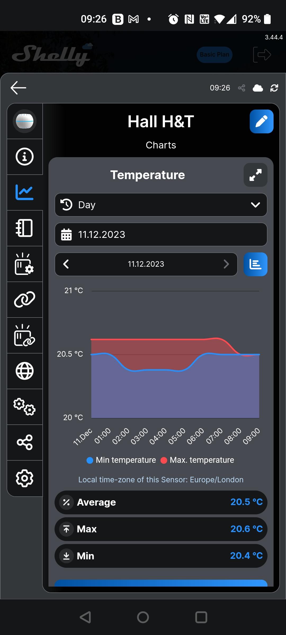

JohnMo Posted December 11, 2023 Author Posted December 11, 2023 Since the last post I have added a few more Salus self balancing actuators, they seem to do a good job of leveling out the energy going into the floor. The heat pump has settled down to a very rhythmic pattern of run - stop, the temperature going into the UFH although set for 28, goes 28 when heat pump is on and reduces down to 25 when heat pump off. The Salus actuator has a similar pattern of going fully open at 25 and then controlling dT at 28 and bringing the flows rates down again. Here is plot of the hall temperature, which shows really stable temperatures, the slight dip in temperature between 8 and 9am is 2 hours after DHW heating started, the hall temp drops 0.1 degs, then based on yesterday's data, recovers over the next couple of hours. So far the high flow temp setting (up to 36 deg based on WC curve) hasn't kicked in, OAT, has varied between 3 and 8 degs. Have -1 forecast for tonight so will see how or if things change. 1
JohnMo Posted December 11, 2023 Author Posted December 11, 2023 Energy usage comparison based on real energy consumption. During the last 48hrs no other heating sources have been used just the heat pump. Garden room was averaging around 7kWh per day for heating, using direct electric heating. This has reduced to zero for the keeping warm (via direct heating), when in use I will still use direct heating for now. Last 48hrs has averaged 18kWh a day (between 3 and 8 degrees, wet and overcast), for house heating at a continuous 20.5, garden room heating was at 14-15 degrees and providing all DHW. Almost all energy is coming from cheap rate (15.16p per kWh), via E7 overnight and a battery in the daytime. Calculated heat loads at an average 5 degrees OAT House 56kWh day (found similar gas usage last year) Garden room 7kWh (based on previous direct electric consumption) DHW 7 kWh - (based on previous usage patterns) total 70kWh heating demand, electricity consumed by heat pump is 18kWh, overall CoP of 3.88. Gas price 6.489p assuming 100% efficiency 70x0.06489 would be £4.54 per day, would cost more if less efficient E7 Electric with battery 18 x 0.1516 is £2.73. 40% cost saving. 2

JohnMo Posted December 12, 2023 Author Posted December 12, 2023 Was down to -1 last night the air very wet, house temp stayed pretty constant with the 28 deg flow temp, but summer house dropped 2 degs, so have added a couple of degrees to the end of the WC curve to compensate. Interesting there was only one defrost cycle all night. Think the ASHP is able to modulate down much further with the continuous drip feeding of heat into the house, so doing very little work.

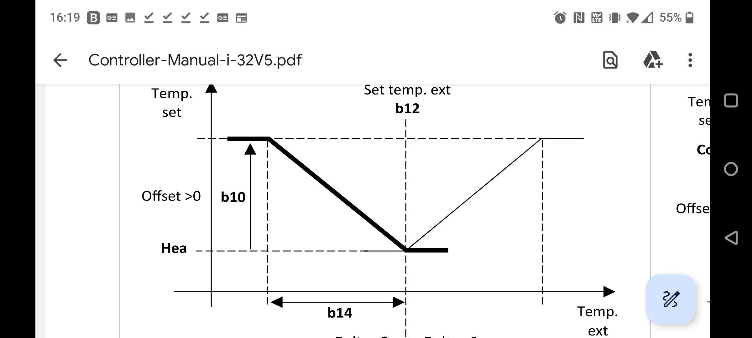

JohnMo Posted December 12, 2023 Author Posted December 12, 2023 18 minutes ago, ReedRichards said: Are you able to do this? My WC "curve" is constrained to be a straight line, whereas I think it probably needs a kink in it around 0 to allow for time spent defrosting. It is also a straight line So I have added 2 degs to B10. Moved from 7 to 9 degs. My current curve is B10 9.0 B12 8 B14 (-)16 Hea 33.5 So starts at +8 degs and down to -8 OAT. At +8 and above flow temp is 33.5 degs and at -8 it's at 42.5 deg flow temp. 26 minutes ago, ReedRichards said: kink in it around 0 to allow for time spent defrosting A kink would be better or even an additional set point at zero so it was two flat or the software made a nice curve.

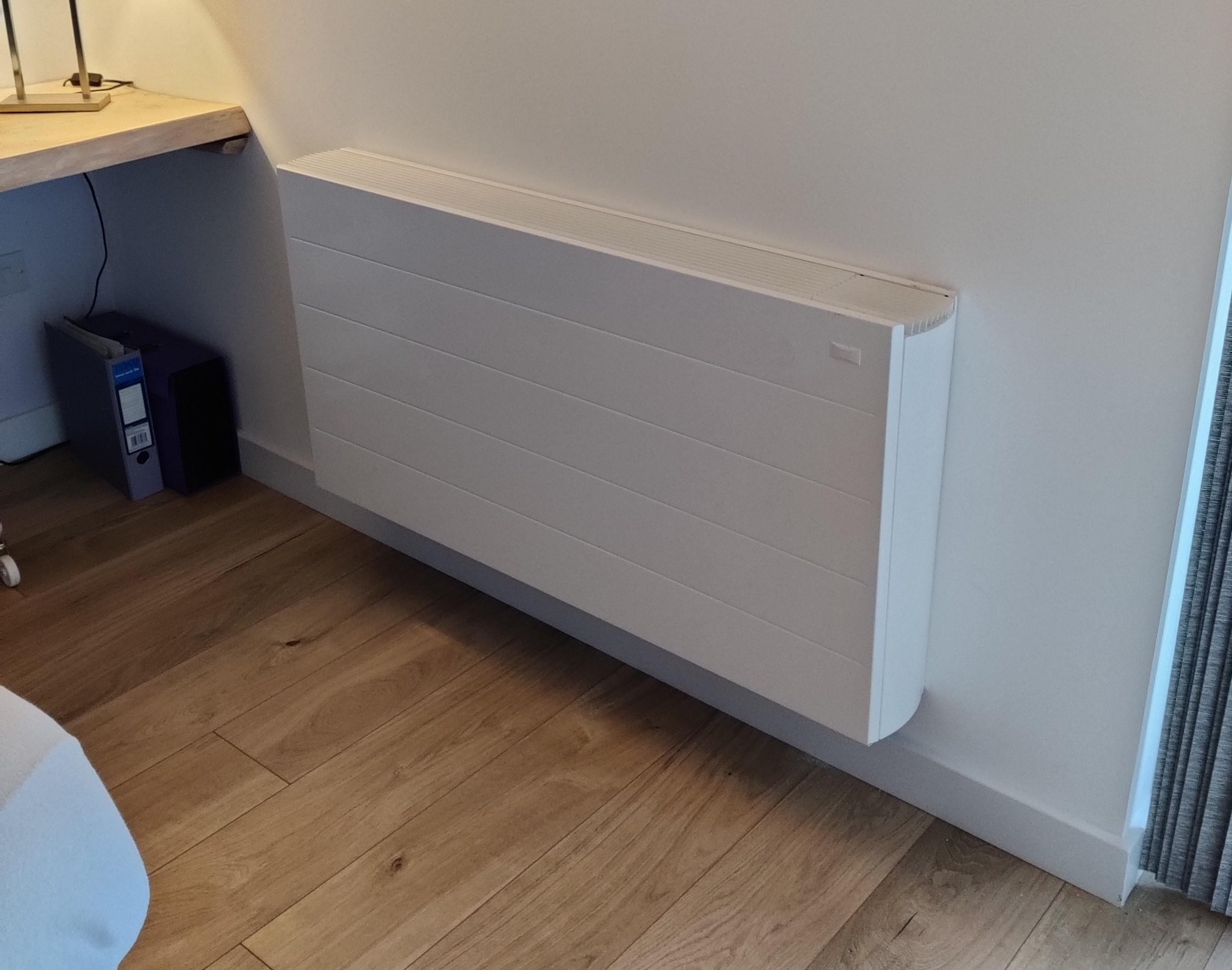

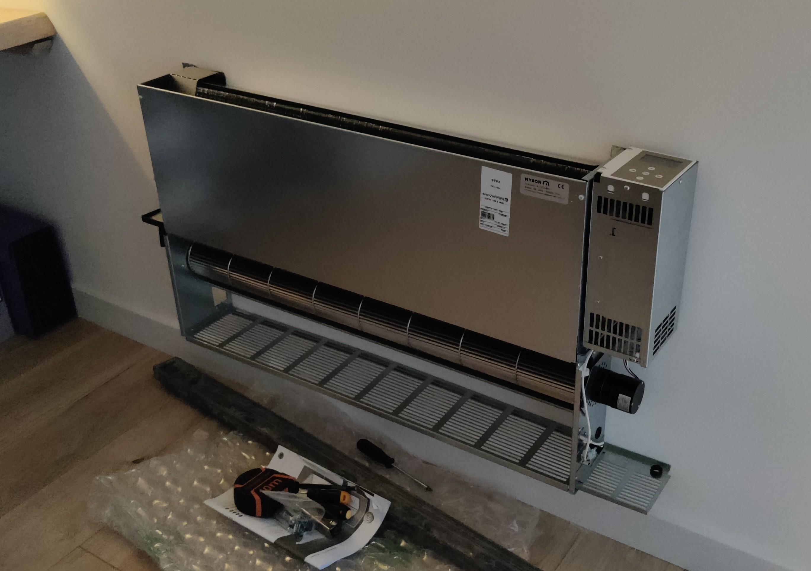

JohnMo Posted January 9, 2024 Author Posted January 9, 2024 So garden room UFH, although just about works, really isn't much use at heat pump temperatures. So a bit of research later, have purchased a fan coil unit. A Myson iVector MK2. Bargain from eBay, about a 1/3 the normal price. It is a 4 pipe fan coil, so has two heat exchanges, one for heating and one for cooling, I will pipe both heat exchanges to a single pipe in a parallel. This should increase heat transfer area and hopefully be able to run slightly cooler. Fan coils come with a temperature sensor, and the normal set point is 32 degrees for the fan to start. So the water has to be above 32 degs to get the heater running. But the Myson one has an adjustable set point, so should simplify setup. So far have mounted it on the wall. Intend to use the UFH manifold to feed the fan coil, with the Salus actuators to manage a 7 deg dT. Heater on wall, with cover off and on
JoeBano Posted January 9, 2024 Posted January 9, 2024 I was keeping an eye on that myson Ivector on eBay. They are soo expensive! I’ll be interested in the cooling as my house struggles to remove the heat in the hot summer days, I’ve been looking into these units for sometime.
