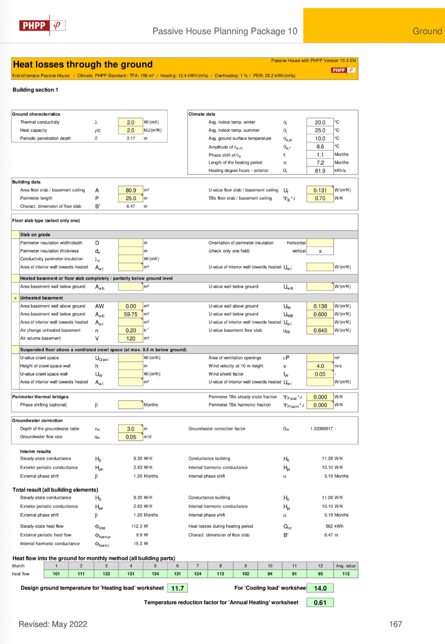

Alan Ambrose Posted November 28, 2023 Share Posted November 28, 2023 As per title - I'm initially looking at Mr Harris' spreadsheet, but also curious about SAP / PHPP treatment? I can see that PHPP talks about unheated vs. heated basements. In practice, I'll probably lay UFH pipes but only use them if we feel the need. For unheated, am I right in thinking that there's an assumption of a constant heat loss through the ground floor just like the non-basement case? Maybe, total basement wall and floor area x constant heat flow per m^2 assuming inside & ground temperatures are fixed? What does that all do to 'form factor' - does it all fall apart in the case of house + basement? I think 'form factor' sort of implicitly assumes that floor, walls & roof have the same temperature gradient? Link to comment Share on other sites More sharing options...

Alan Ambrose Posted November 29, 2023 Author Share Posted November 29, 2023 OK thanks all, much appreciated and thanks for the pointers, links and considerations. Like a lot of subjects, the answer appears to be 'it's complicated' BTW Jeremy's spreadsheet just has floor area x U-value and assumes steady state ground and inside temperature. There's no allowance for perimeter losses and it comes up with a constant heat loss rate over time. So, in an ideal world, I should model the ground conditions, ground water presence & flow, temperature fluctuations at various depths and seasons and the full thermal properties of the basement construction I'm just delving into PHPP modelling and I see they have some resources and calculation methods here: https://passipedia.org/basics/building_physics_-_basics/thermal_bridges/tbcalculation/examples/heatedb https://passipedia.org/basics/building_physics_-_basics/thermal_bridges/tbcalculation/examples/unheatedb But I was hoping for an easy answer.... I'll post back here with any progress I make. Link to comment Share on other sites More sharing options...

Alan Ambrose Posted November 30, 2023 Author Share Posted November 30, 2023 OK I've found the answer (not really). But PHPP does have a bunch of calcs for: + standard slab + unheated basement (i.e. basement outside thermal envelope) + heated basement (i.e. basement inside thermal envelope with interior temperature assumed to be the same as the rest of the building) + US-style suspended floor above crawl space + some way of coping with combinations of these. They include ... adjustment for soil type / perimeter losses / ground water depth & flow / seasonal ground temperature and delay! I'm not sure how anyone measures ground water flow rate in the typical soil investigation? Exactly what methods PHPP uses I have not determined yet. But if you accept it as a black box, then it would seem to do most of the necessary calcs. I'm not sure yet if there's a workaround for 'partly heated basement'. Link to comment Share on other sites More sharing options...
Alan Ambrose Posted December 13, 2023 Author Share Posted December 13, 2023 >>> ground water depth & flow It's also struck me that if you have reasonable insulation outside the basement RC and a membrane external to that - then the ground water effect should be minimal. Link to comment Share on other sites More sharing options...
