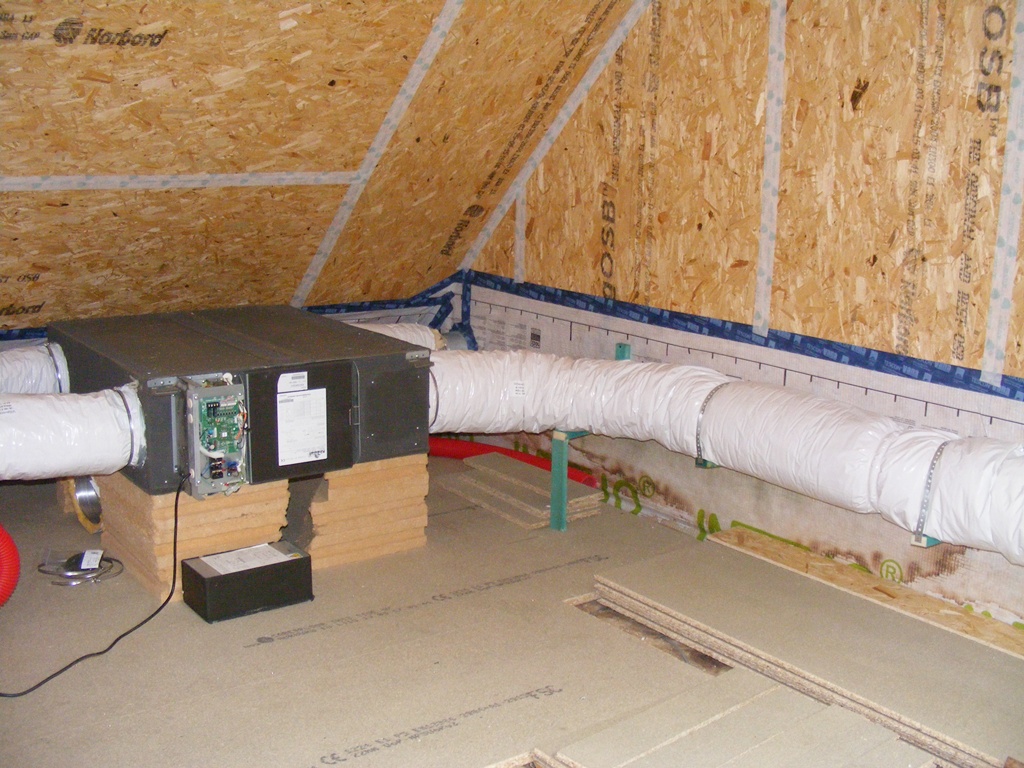

CC45 Posted September 12, 2017 Share Posted September 12, 2017 @ProDave looking sharp. Was looking back through your blog - what did you use to connect the distribution box to the mvhr box? What is the external insulation that you've fitted? Still on my to do list. Thanks cc Link to comment Share on other sites More sharing options...

ProDave Posted September 12, 2017 Author Share Posted September 12, 2017 Because I have not yet finished, NONE of my offcuts have yet been disposed of, you never know where they might come in handy. They are free to dispose of but I won't mention how. I think my key tip to being eficcient is not to be in a hurry. Two examples, when you get an offcut, take a walk around and see if there is somewhere it would fit with only minor trimming, if so put it there for when you get there. Likewise if you come to a small piece needed and don't have one, do NOT cut it from a full sheet. Leave it. Sooner or later an offcut of the right size will tuen up and you then go back and fit the mising piece. The MVHR connects to the input and exhaust ducts, and the plenum boxes with some large semi flexible aluminium insulated duct that was left over from when my plumber friend installed his. Here is a picture The external insulation is 100mm thick Pavatex (other makes are available) wood fibre board and rendered with the Baumit.com render system Link to comment Share on other sites More sharing options...
