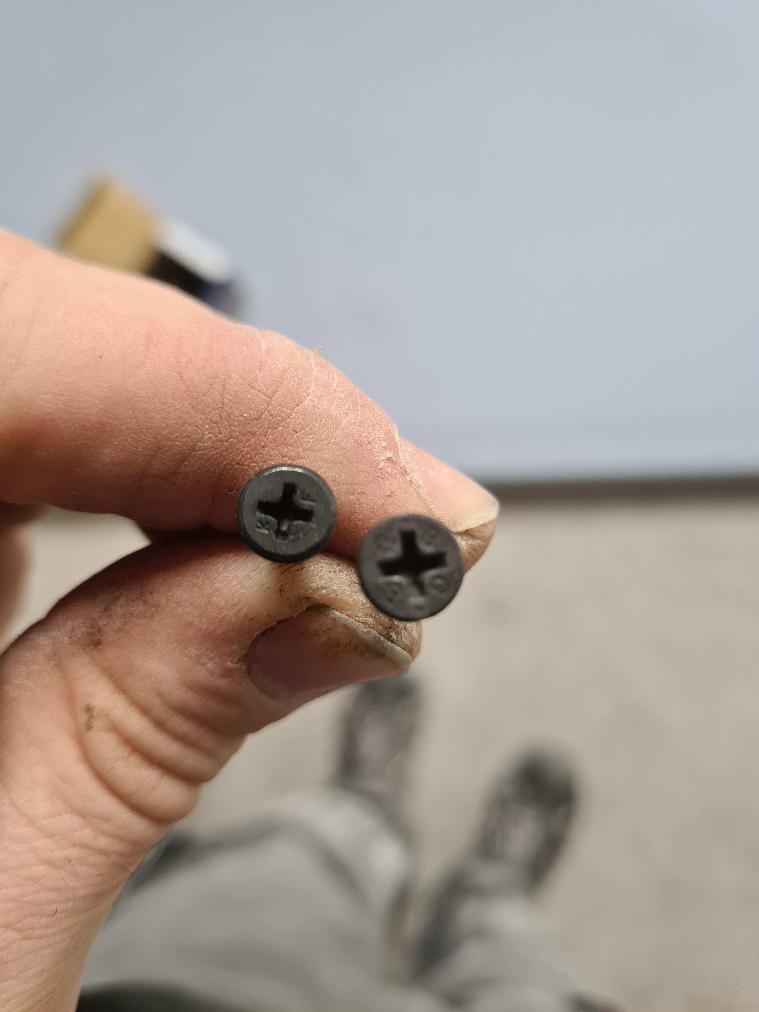

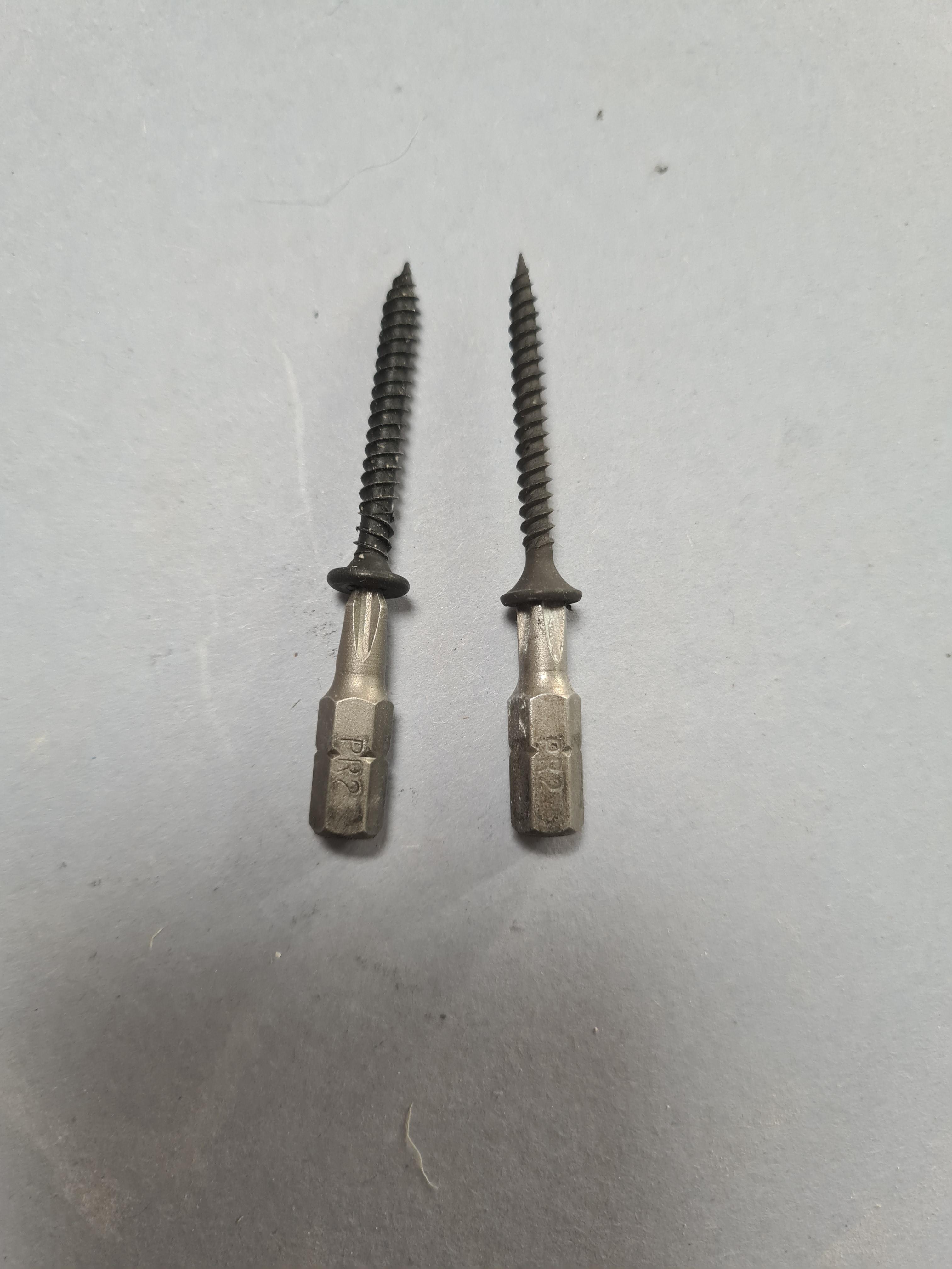

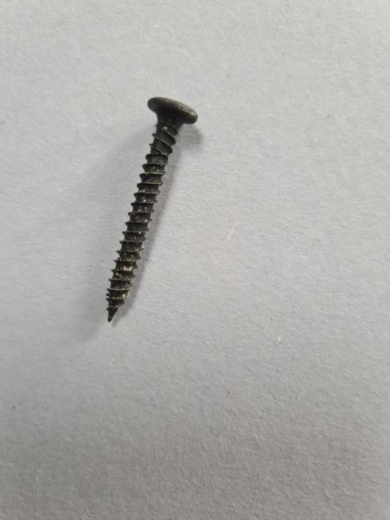

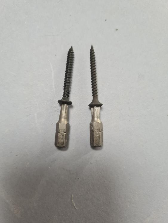

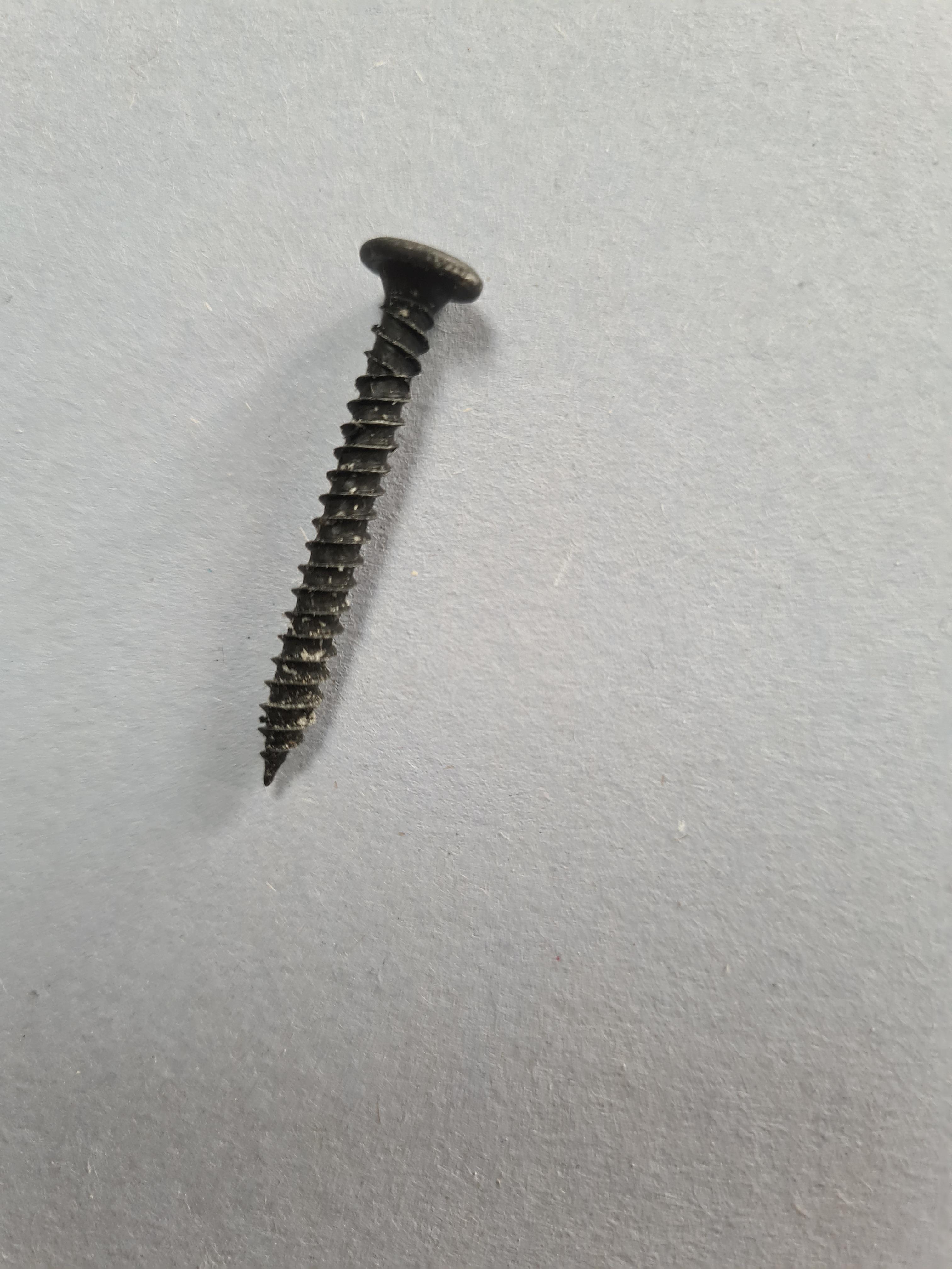

Barnboy Posted November 26, 2023 Share Posted November 26, 2023 Has anybody used the performance plus screws ? I'm boarding with Soundshield board, the spec sheet says to use performance plus screws which I've purchased for the job. They seem an absolute nightmare to get in. I've got a milwaukee collated screw gun but you've got to be perfectly square and have most of your body weight behind the gun to stop the bit spinning out of the screw head. I've taken some screws out of the plastic strip and put them in with my impact driver but as soon as the reverse thread below the screw head hits the board they go tight and require backing in and out a couple of times. I've put a few std plasterboard screws in and they're fine, it's just these specified screws with the reverse thread. Should I just give up and swap to standard screws, what's the purpose of the reverse thread ? , to force any board that the screw has pushed out the back, back into the board ? Thanks Link to comment Share on other sites More sharing options...

Barnboy Posted November 26, 2023 Author Share Posted November 26, 2023 I'm using a PR2 bit that came witht the standard screws. Admittedly it's not as snug as in the standard screws but it's the best fitting bit that I can find. Standard on the right in the photos, performance plus on the left. Link to comment Share on other sites More sharing options...

Barnboy Posted November 26, 2023 Author Share Posted November 26, 2023 I've just realised that although I had a PR2 bit in the impact driver the collated gun had a PH2 in it. I've just put a new PH2 in both and the impact driver is definitely better, collated gun is maybe better but not amazing. I think I'll invest in some better quality bits. Link to comment Share on other sites More sharing options...
