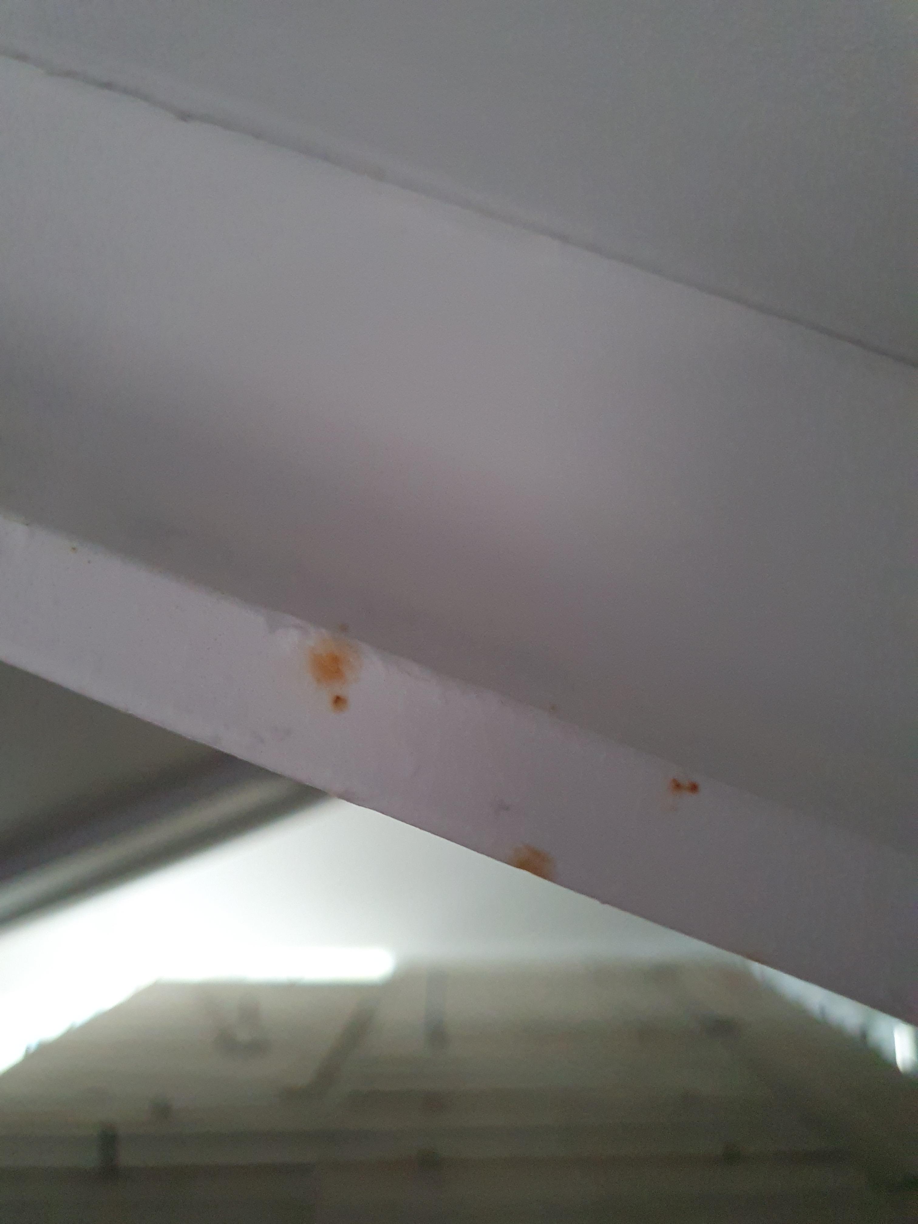

As ever two steps forward, one step back. Before the decorators started I coated all our exposed steelwork (already red oxide primed) with two coats of satin hammerite (oil based, 8yrs guarantee). The decorators have gone over everything in emulsion and quite a few rust stains have leatched through, which is annoying. Would another dab of hammerite on these work as an adequate stain block or should I try something else?
The main contractor covering the internal works have suggested "rust-oleum or similar", but I need to get this right.

Hammerite on top of red oxide is pretty pointless and emulsion definitely won’t key to hammerite and will peel off. Scrape off whatever you can (you may find the hammerite comes off as a layer to make things really easy) rub down and rust and seal off with zinzer BIN or similar before the emulsion.

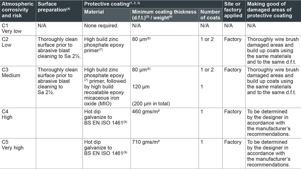

I know very little about this topic. But after a buildings control visit, we had to re-paint 2 of our steel beams. There is an NHBC note on this topic.
https://nhbc-standards.co.uk/6-superstructure-excluding-roofs/6-5-steelwork/6-5-3-steel-grade-and-coatings/
Specifically Table 5 on this page.

@Tom yes I see now, the hammerite was to be the decorative, not protective finish. The staining through the emulsion is more likely to be oils from the hammerite rather than rust.
Definitely rust leaching through, I'll get a pic if I can.
Thanks for all that info @Nick Laslett, however these are internal steels in a heated environment, so classed as C1 I think.
Hi @Tom, I completely agree that your steels are now in a C1 environment. My steels developed their rust during the period they were in a C2 environment.

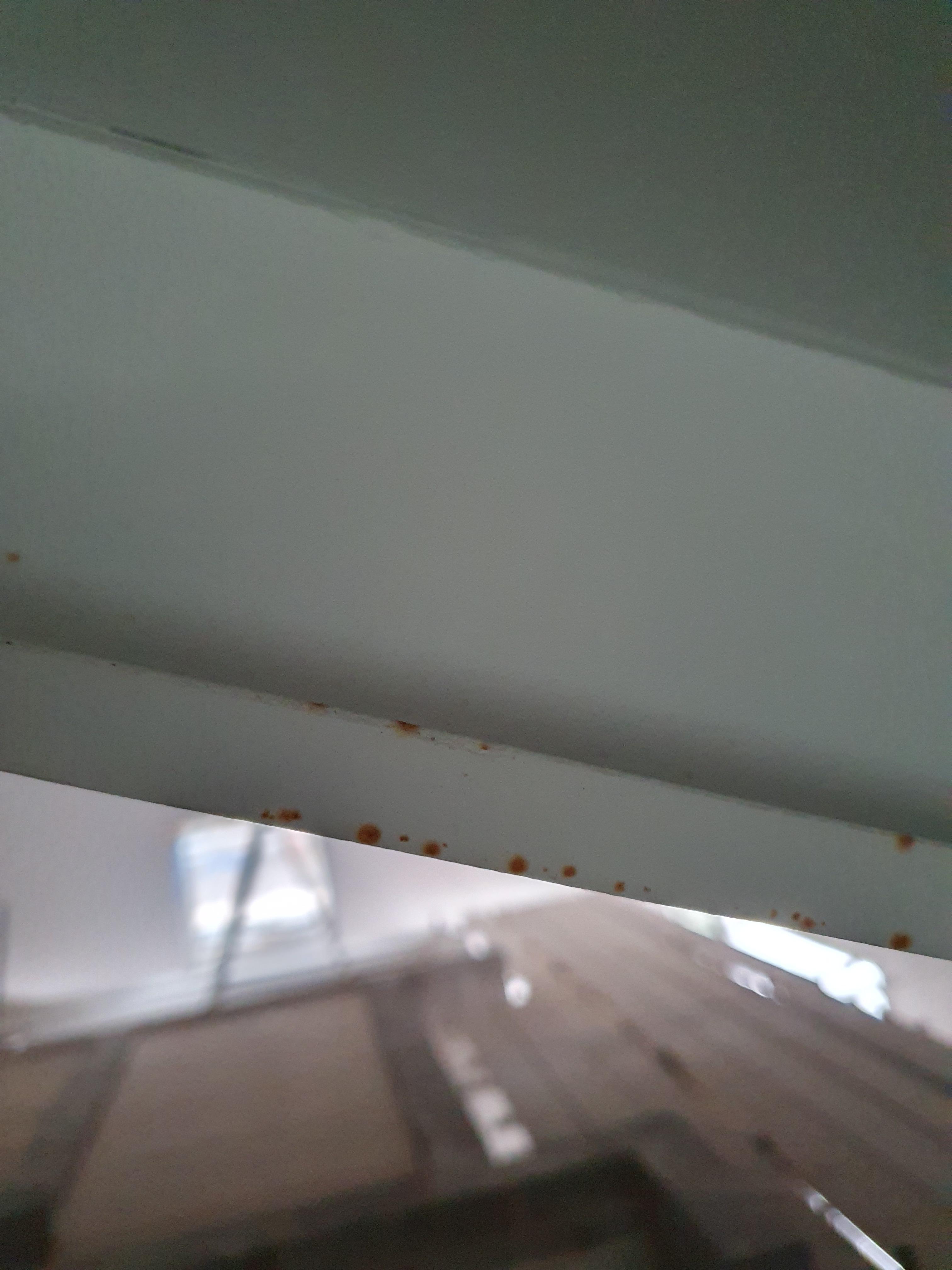

A few pics...

Is it old steel say in an old barn or new steel?
In your last photo I think I can see some roughness on the outside edges of the bottom flange suggesting it is old steel. If so you'll need to take that back to the bare metal. Do it now as later it will be messy job and spoil your curtains for example. Rust dust is a bugger as it stains many things it lands on.
If new steel then the SA2.5 blasting should have removed the mill scale.
New steel, but a few rust spots coming through the red oxide in places, hence why I rubbed it back gave a spray of Dinitrol and two coats of Hammerite. It would have been fine had the decorators not covered in emulsion. Any tiny spots that would have been invisible are now visible due to leaching out into the emulsion.
