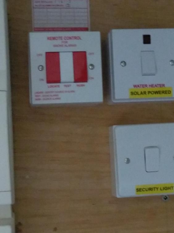

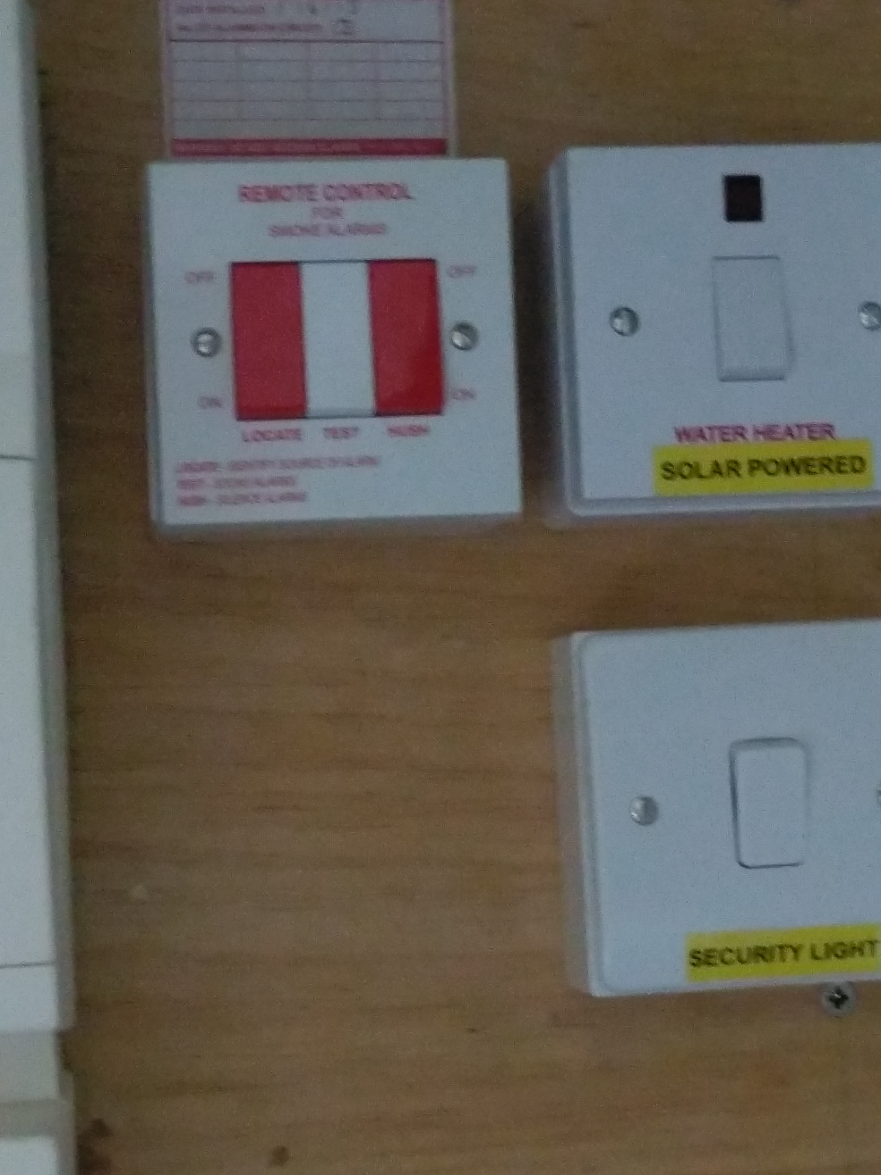

100% you can get test button for hard wired range. We have one in our cottage
Thats the locate button too. Very handy in a large or 3 storey house. If the smoke alarms go off you press locate and it silences all the alarms except the one that's been triggered, so you can head there immediately to investigate.
