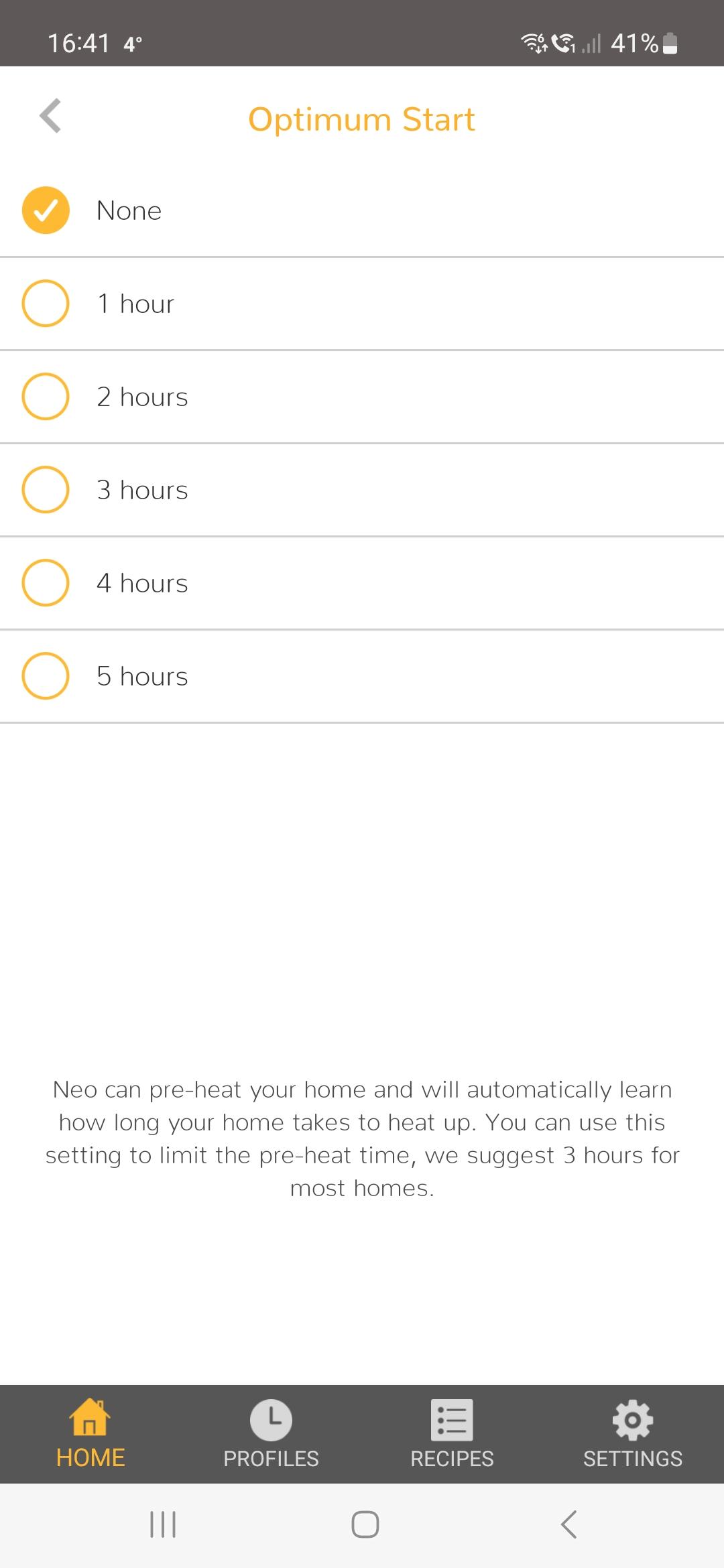

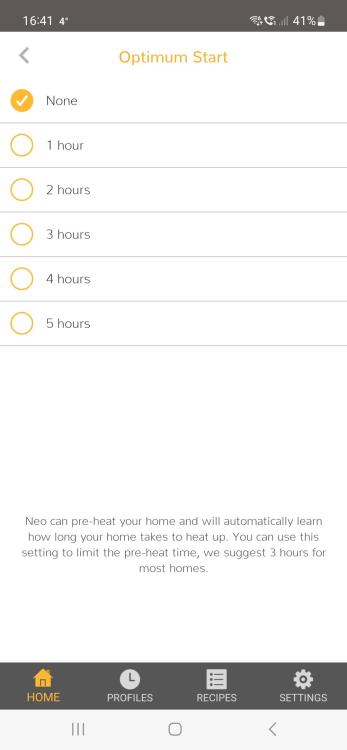

Andehh Posted November 28, 2023 Author Share Posted November 28, 2023 Well, after 4 nights of sat next to the meter (nothing happening) then a couple nights where it did happen and I slept through it.....then £40 on appliance monitoring equipment..... FOUND IT!!! Somehow I had 'prehea / optimum start' enabled in our utility room zone, which is a zone which never really comes on due to plant room...with the warm cylinder, drying clothes etc it was also a room that isn't directly connected with external temperatures. Checking the heatmiser app for this room shows the preheating kicking on at 3am...ahead of 4am when all the heating zones really kicked in! On the bright side...at least I know Heatmiser has an optimum heat capability 1 Link to comment Share on other sites More sharing options...
SteamyTea Posted November 28, 2023 Share Posted November 28, 2023 (edited) 27 minutes ago, Andehh said: Somehow I had 'prehea / optimum start' enabled in our utility room zone What is that then, a resistance heater in the plumbing? 27 minutes ago, Andehh said: £40 on appliance monitoring equipment Shows the value of monitoring. Edited November 28, 2023 by SteamyTea Link to comment Share on other sites More sharing options...
Andehh Posted November 28, 2023 Author Share Posted November 28, 2023 (edited) Just a feature heatmiser offer! Edited November 28, 2023 by Andehh Link to comment Share on other sites More sharing options...
SteamyTea Posted November 28, 2023 Share Posted November 28, 2023 1 minute ago, Andehh said: Just a feature heatmiser offer So does it run the heat pump for an hour or more then, unless you lock it out? Link to comment Share on other sites More sharing options...
MikeGrahamT21 Posted November 28, 2023 Share Posted November 28, 2023 (edited) I think all the smart heating controls have this, mine is called early start, it basically uses historic room data plus the outside temperature from weather forecast to learn how early it needs to turn the heating on so that when your chosen schedule starts the room is at temperature. The heat miser version seems a little more basic than the Tado I’ve got where you have to input the amount of time. glad you found the culprit, knowing what I’m like that would have been proper doing my head in! Edited November 28, 2023 by MikeGrahamT21 Link to comment Share on other sites More sharing options...
