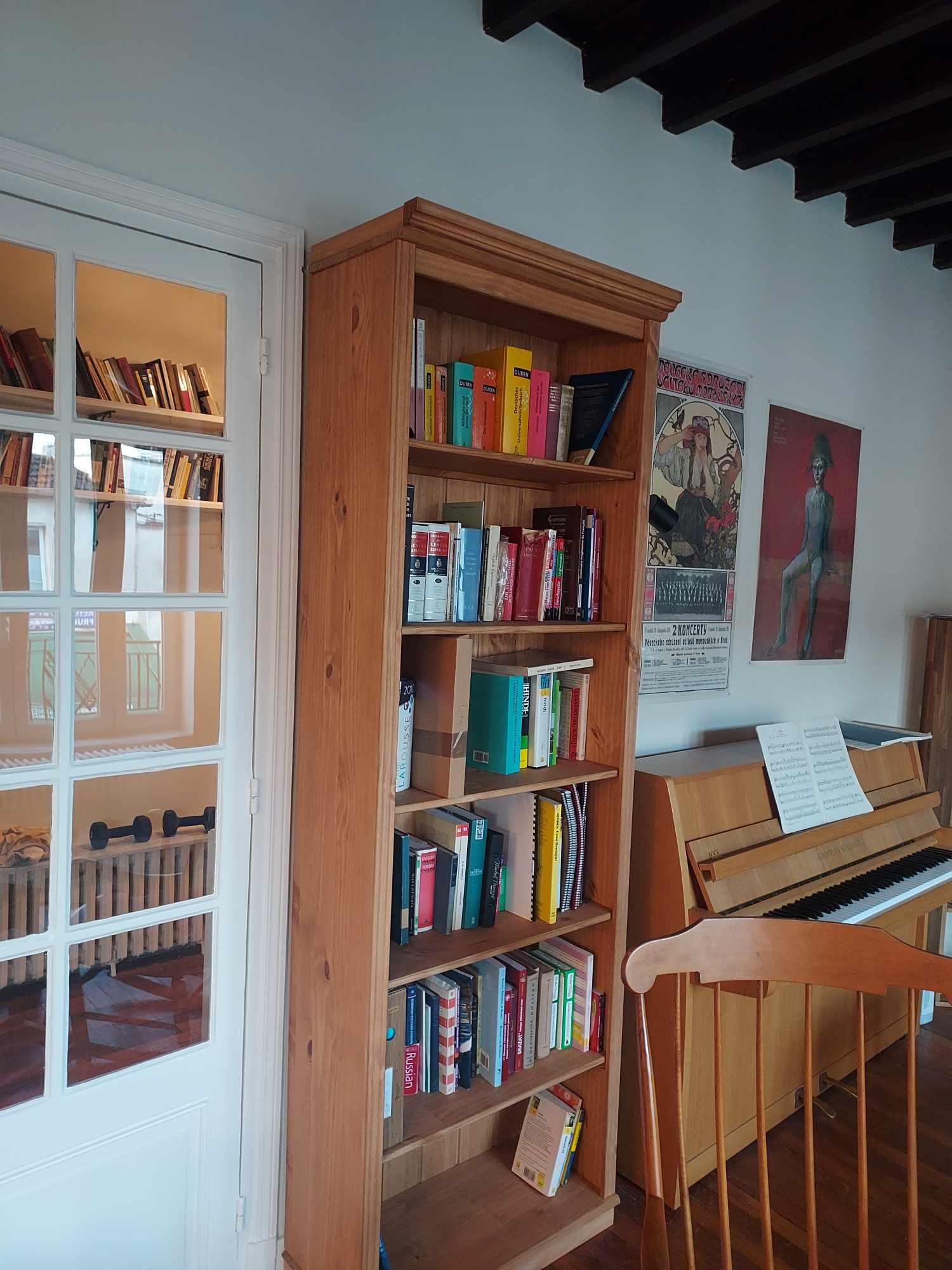

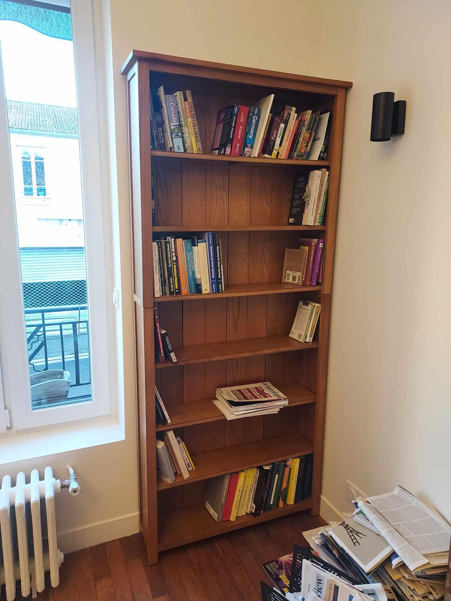

I've got and put together a couple of solid pine and solid oak bookcases - they were not expensive at all, but everything is either too small or too large.
