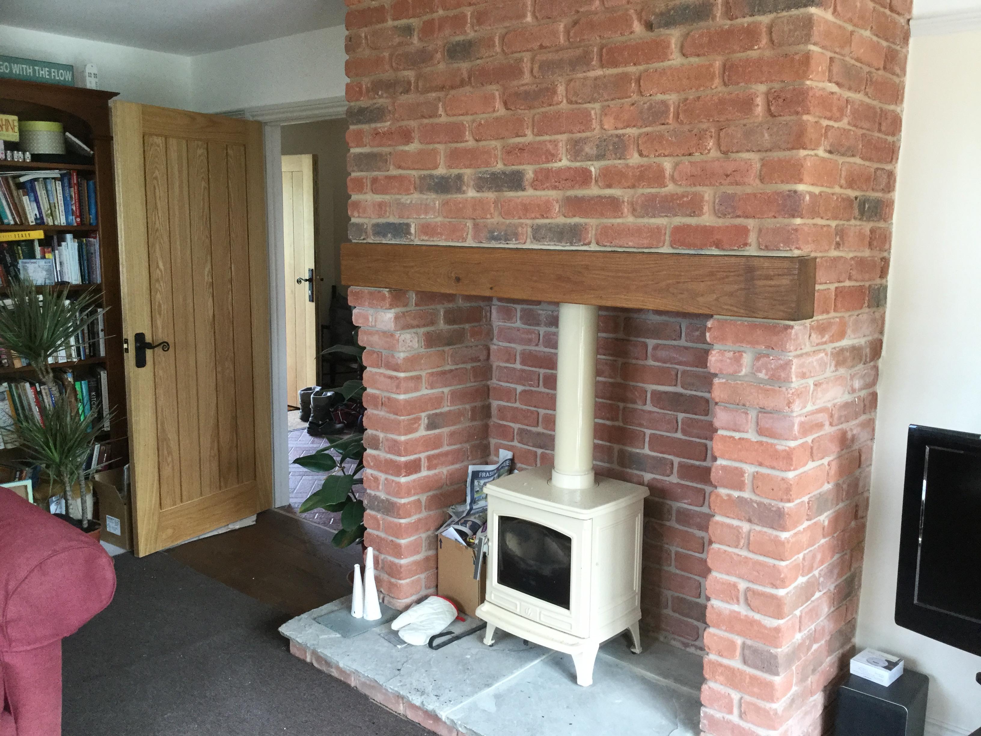

Redoctober Posted November 17, 2023 Share Posted November 17, 2023 (edited) @MortarThePoint Here are a couple of images showing how our oak beam was fitted. When installed, it came with two large "bolt" type "pins" protruding, which were then drilled into the concrete lintel. The surrounding area was then plaster boarded. I have to say in the past 5 years we have not suffered any shrinkage or cracking or either the beam or plaster. The beam was sourced and fitted by the approved stove fitter! Edited November 17, 2023 by Redoctober Tidy up 1 1 Link to comment Share on other sites More sharing options...
