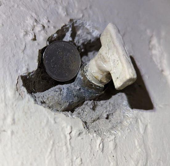

Square Feet Posted November 15, 2023 Posted November 15, 2023 I have this thing sticking out of the wall of a Victorian-era property I am renovating. I think the pipes are lead. The tap is about 180cm up the wall behind the front door. Is it the old gas supply line? It's not the modern one. I want to grind the tap off so that I can decorate over it, but I'm not quite brave enough without knowing what it is. Does anyone recognise it? Cheers. 5p is for scale.
ToughButterCup Posted November 16, 2023 Posted November 16, 2023 It doesn't matter what it carries. If you have to wonder whether it's a significant problem, it is. So treat it as such until you have more evidence.
joe90 Posted November 16, 2023 Posted November 16, 2023 I came across similar in a customers house, I got a gas safe chap to visit and cap it, not worth gambling with.
Square Feet Posted November 16, 2023 Author Posted November 16, 2023 Thank you all for the sage advice. However I am thinking of ignoring it all and drilling a hole in the pipe. 😂 The pipe seems to be lead, so it is not likely to spark. I really can't see this being a live gas line, so it's just residual gas in the pipe that I have to worry about. Drilling a hole would let it out and then I could just grind away without having to worry about losing my eyebrows.
saveasteading Posted November 16, 2023 Posted November 16, 2023 The lead won't spark but the bit might hot something. My recollection of old gas pipes is of plumbers flattening them. That would leave it intact but just about closed... or it splits and vents. But what if it is live, as the result of a previous bodge. ive seen some very dangerous copper gas pipe, expertly soldered but dangerously exposed...therefore.. it really needs a proper gas plumber to answer this. 1
SteamyTea Posted November 16, 2023 Posted November 16, 2023 On 16/11/2023 at 11:00, Square Feet said: However I am thinking of ignoring it all and drilling a hole in the pipe Expand You got your, matches, blow torch and some solder ready in case it leaks?
Conor Posted November 16, 2023 Posted November 16, 2023 The local gas network owner will come out and check it for you, for free. 1

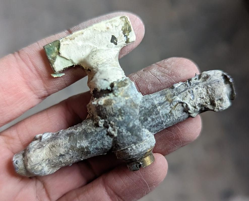

Square Feet Posted November 17, 2023 Author Posted November 17, 2023 It wasn't live. All is good and I still have my eyebrows. I drilled a wee hole in it and nothing came out, so I went ahead and cut out the brass tap from the lead lines.
Square Feet Posted November 17, 2023 Author Posted November 17, 2023 On 16/11/2023 at 11:04, joe90 said: BUT WHAT IF IT IS A LIVE GAS LINE!!!!! Expand Then it would be bypassing the gas meter and supplying me for free, which just isn't happening. It probably hasn't been live for about 100 years - it was more a question of whether there would be residual gas in the line, but there wasn't. 1
