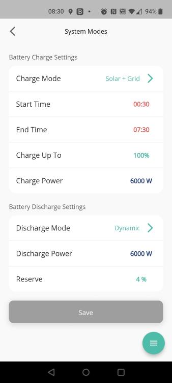

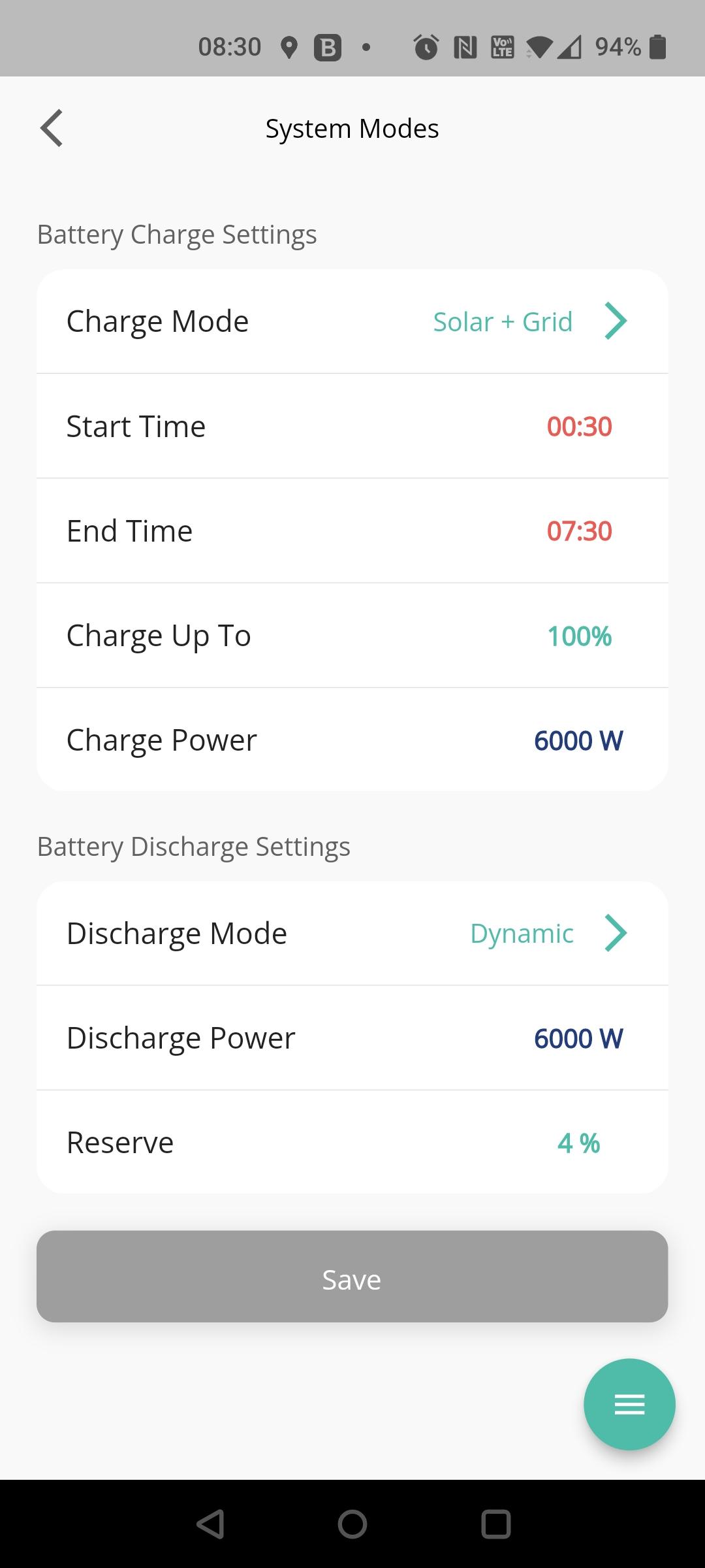

JohnMo Posted November 7, 2023 Posted November 7, 2023 You can limit the watts going between the battery and the gateway, your install can set hard stops also, which the end user cannot change later. Discharge and charge power are all setting that can be changed. If this simplified the install. 1
