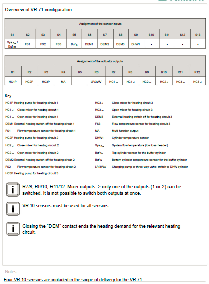

sharpener Posted November 7, 2023 Share Posted November 7, 2023 (edited) 6 hours ago, Lofty718 said: I have a VR71 and Sensocomfort with my gas boiler, it's a very good bit of klt but quite complicated with many different settings that even the installer barely understood himself but I worked it all out for myself. Have you found any decent documentation for the VR71 @Lofty718? By which I mean a description of what all the inputs and outputs are intended for and what the voltage levels are? Seems to be lacking, though I have reverse-engineered a version by looking at numerous schematics and Vaillant tell me my interpretation is correct as far as it goes. The SensoComfort simulator on the web is quite good. 2 hours ago, JohnMo said: Are you sure you need the install to be so complicated? Its complect just reading it, let alone installing and getting to work efficiently. It is designed to be hierarchical in the following way (and commissioned in this order): So at the bottom level is the HP and its native controls, this should work to give DHW, and plain WC heating if the frost stat on landing is turned up so as to create the demand. Zones and thermal store do nothing in this mode. I will get the installer to achieve just this level of functionality to begin with. The thermal store comes next, the re-purposed external timer will control when it charges (e.g. 0500 - 0600 on Economy 7, and 1300 - 1600 from surplus PV or Octopus Cosy) and when it discharges (to feed bedroom radiators 0700 - 0830 and 2200 - 2330). Then we have the Honeywell zone control system. If any zone is calling for heat it will turn on the Honeywell boiler relay wired in parallel with the frost stat so calling the HP on its two-wire voltage free heating input. Other than that it is electrically separate. Lastly is the internet control box. By judicious use of the 4 normally closed and 4 normally open relays it will default to allowing all of the above to operate normally if it is powered down, is reset by a power outage, or fails. Two of its timers also do the night setback for the MVHR fan speed. Edited November 7, 2023 by sharpener Link to comment Share on other sites More sharing options...
JohnMo Posted November 7, 2023 Share Posted November 7, 2023 18 minutes ago, sharpener said: Have you found any decent documentation for the VR71 @Lofty718? By which I mean a description of what all the inputs and outputs are intended for and what the voltage levels are? Seems to be lacking, though I have reverse-engineered a version by looking at numerous schematics and Vaillant tell me my interpretation is correct as far as it goes. The SensoComfort simulator on the web is quite good. It is designed to be hierarchical in the following way (and commissioned in this order): So at the bottom level is the HP and its native controls, this should work to give DHW, and plain WC heating if the frost stat on landing is turned up so as to create the demand. Zones and thermal store do nothing in this mode. I will get the installer to achieve just this level of functionality to begin with. The thermal store comes next, the re-purposed external timer will control when it charges (e.g. 0500 - 0600 on Economy 7, and 1300 - 1600 from surplus PV or Octopus Cosy) and when it discharges (to feed bedroom radiators 0700 - 0830 and 2200 - 2330). Then we have the Honeywell zone control system. If any zone is calling for heat it will turn on the Honeywell boiler relay wired in parallel with the frost stat so calling the HP on its two-wire voltage free heating input. Other than that it is electrically separate. Lastly is the internet control box. By judicious use of the 4 normally closed and 4 normally open relays it will default to allowing all of the above to operate normally if it is powered down, is reset by a power outage, or fails. Two of its timers also do the night setback for the MVHR fan speed. As I said, very complex. Found myself doing this sort of thing, when I first built the house, slowly undid it all when I started seeing the bills - KISS wins every time. 1 Link to comment Share on other sites More sharing options...

Lofty718 Posted November 7, 2023 Share Posted November 7, 2023 (edited) 2 hours ago, sharpener said: Have you found any decent documentation for the VR71 @Lofty718? By which I mean a description of what all the inputs and outputs are intended for and what the voltage levels are? Seems to be lacking, though I have reverse-engineered a version by looking at numerous schematics and Vaillant tell me my interpretation is correct as far as it goes. The SensoComfort simulator on the web is quite good. It is designed to be hierarchical in the following way (and commissioned in this order): So at the bottom level is the HP and its native controls, this should work to give DHW, and plain WC heating if the frost stat on landing is turned up so as to create the demand. Zones and thermal store do nothing in this mode. I will get the installer to achieve just this level of functionality to begin with. The thermal store comes next, the re-purposed external timer will control when it charges (e.g. 0500 - 0600 on Economy 7, and 1300 - 1600 from surplus PV or Octopus Cosy) and when it discharges (to feed bedroom radiators 0700 - 0830 and 2200 - 2330). Then we have the Honeywell zone control system. If any zone is calling for heat it will turn on the Honeywell boiler relay wired in parallel with the frost stat so calling the HP on its two-wire voltage free heating input. Other than that it is electrically separate. Lastly is the internet control box. By judicious use of the 4 normally closed and 4 normally open relays it will default to allowing all of the above to operate normally if it is powered down, is reset by a power outage, or fails. Two of its timers also do the night setback for the MVHR fan speed. There is barely any documentation on the Vaillant wiring centres and like you I got my information from schematics/reading forums With the VR71 it's a case of wiring your auxillary inputs into it, mine being UFH pump, radiator circuit pump and an electronic mixing valve (esbe) Then the corresponding sensors need to be fitted to the pipework one for each zone, then another sensor before low loss header if you have one and also one sensor sits in the cylinder pocket and all of this combined with the outdoor weather sensor allows amazing control of your heat source. Edited November 7, 2023 by Lofty718 Link to comment Share on other sites More sharing options...

sharpener Posted November 7, 2023 Share Posted November 7, 2023 1 hour ago, Lofty718 said: There is barely any documentation on the Vaillant wiring centres and like you I got my information from schematics/reading forums With the VR71 it's a case of wiring your auxillary inputs into it, mine being UFH pump, radiator circuit pump and an electronic mixing valve (esbe) Then the corresponding sensors need to be fitted to the pipework one for each zone, then another sensor before low loss header if you have one and also one sensor sits in the cylinder pocket and all of this combined with the outdoor weather sensor allows amazing control of your heat source. For anyone else looking this is the best I have been able to find, in a 700/2 controller manual online. VR71 pinout.pdf Seems to have suffered a bit in translation, @Lofty718can you confirm that the demand inputs R6, R7, R8 are for external contacts that need to be closed for heat demand (as it would be for a conventional boiler)? Link to comment Share on other sites More sharing options...
