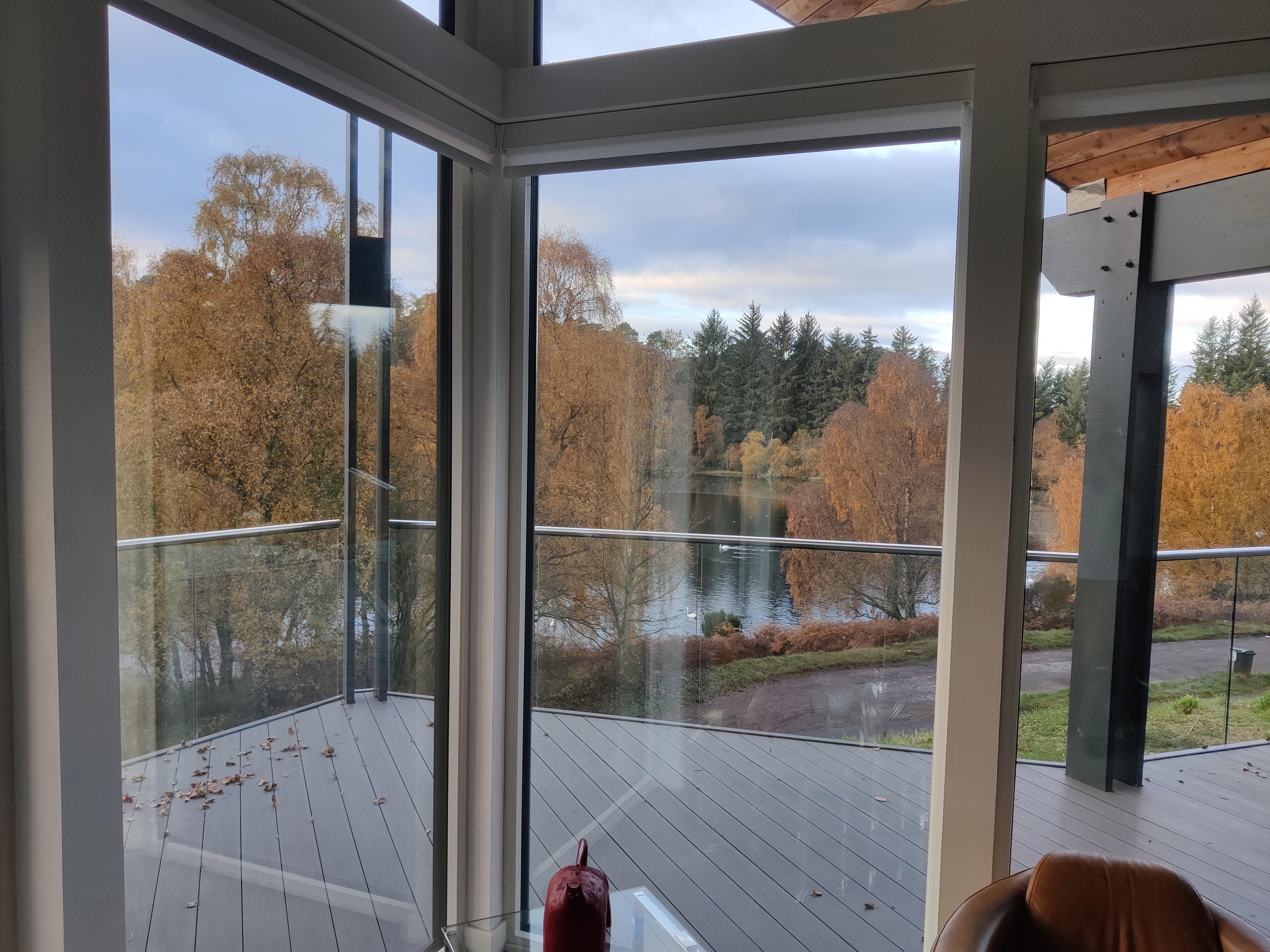

mjc55 Posted November 6, 2023 Author Share Posted November 6, 2023 4 hours ago, Andehh said: It's 1.5m horizontal, about 1.8 of actual overhang. Down the side it's only 800mm. About 23sqm of surface area based on the cladding we put on. Brick and block with some serious steels to hold it all up, especially as its a floating corner that is suspending the overhang! Sliders are 5m on one side and 3m other side. I do love the corner sliding doors, a great feat of engineering. Did you consider cost differences between making that corner floating and using a post? I guess the detailing regarding roof construction and insulation were interesting, how did you get away without cold bridging? Link to comment Share on other sites More sharing options...

saveasteading Posted November 6, 2023 Share Posted November 6, 2023 6 hours ago, mjc55 said: Did you consider cost differences between making that corner floating and using a post? I'd estimate £15k, perhaps more, extra for a lot of heavy steel and foundations as it's supporting the roof, snow loads* and the sliding door. I'd love to see drawings or photos of it. * a valley gutter is assumed to collect a snow drift as well as the standard depth allowed for loading. It does look good though and where would we be if everybody did the cheapest thing? Link to comment Share on other sites More sharing options...
JohnMo Posted November 6, 2023 Share Posted November 6, 2023 You can do overhangs quite cheaply if you make the the structural engineer think about, our total steels bill was £9k including full design, all surveys and the install. 2 Link to comment Share on other sites More sharing options...
saveasteading Posted November 6, 2023 Share Posted November 6, 2023 12 minutes ago, JohnMo said: if you make the the structural engineer think about That's clever. There isnt any cantilever because, instead, you have displaced columns away from the glazing/ floor area. Link to comment Share on other sites More sharing options...

Andehh Posted November 6, 2023 Share Posted November 6, 2023 15 hours ago, mjc55 said: I do love the corner sliding doors, a great feat of engineering. Did you consider cost differences between making that corner floating and using a post? I guess the detailing regarding roof construction and insulation were interesting, how did you get away without cold bridging? We never asked... due to a rapid change from extension to full rebuild, offered by the builder with a decent 15% odd discount if we agreed to start in 5 weeks vs the expected 9-12 months. - Builder had a large last minute commercial cancellation hitting him at the 11th hour, and we were the closest project to him to fill the gap. The price he offered for the build we'd end up with included the floating corner, so we left them in. I would guestimate its near 5 figures of potential saving, had we stuck a single post at that corner & done it sensibly. The depth of foundations, sheer size of the steels, a month of delay due to some slight flex that was seen in the roof overhang steels (so the floating corner steels also then support two more steels that support the overhang....) and knock on design work to that corner of the house must have added up. Cold bridging was an issue & will be a compromise still I am sure..... Every bit of metal was infilled with PIR and foam, then the leading edge of the steels I applied a small strip of insulation likely butting up against the plasterboard. Basically did what little I could to micromanage the steels out of site with insulation best I could! Link to comment Share on other sites More sharing options...

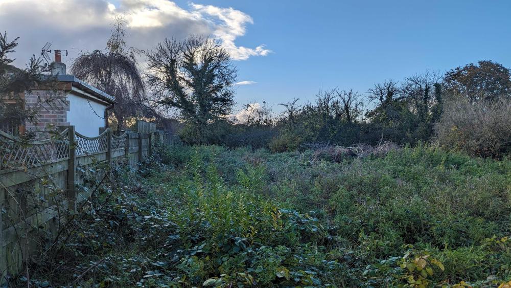

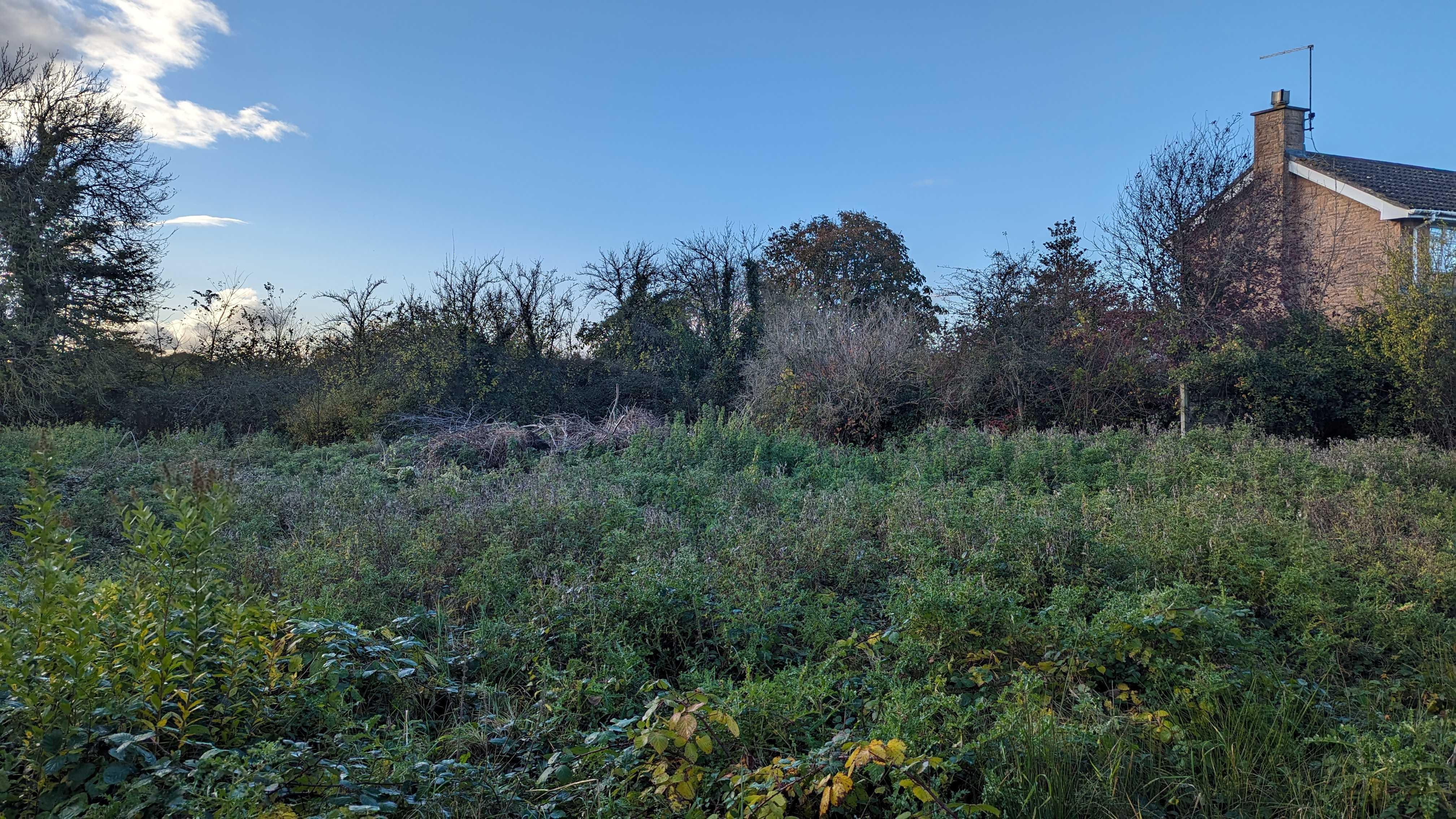

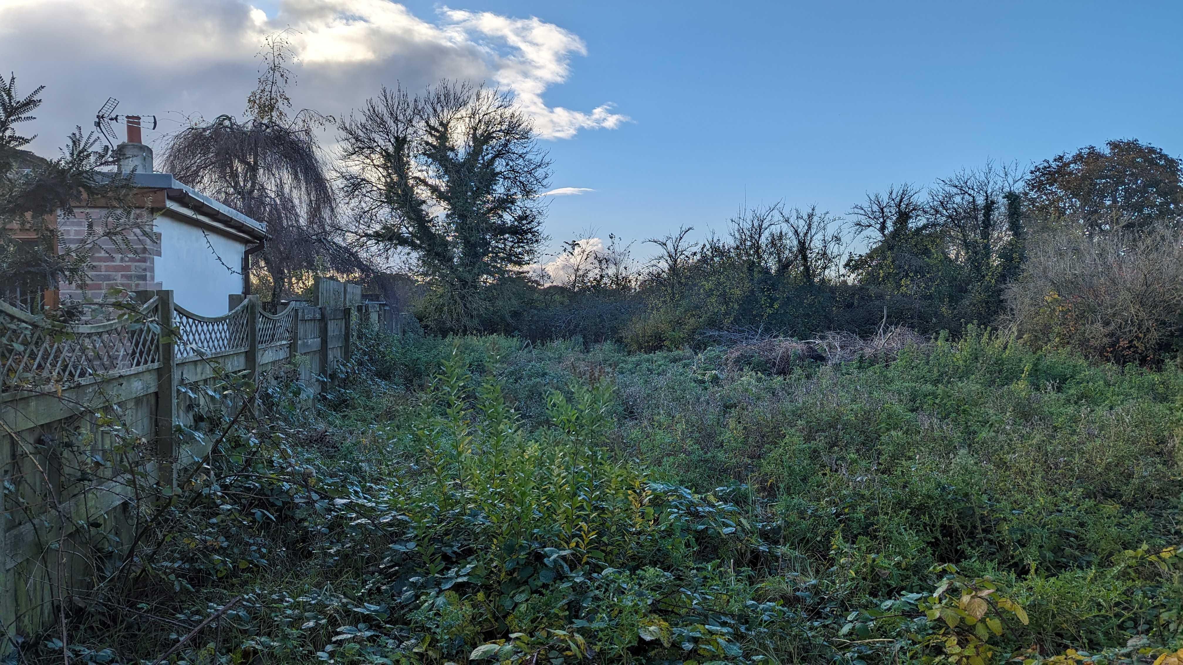

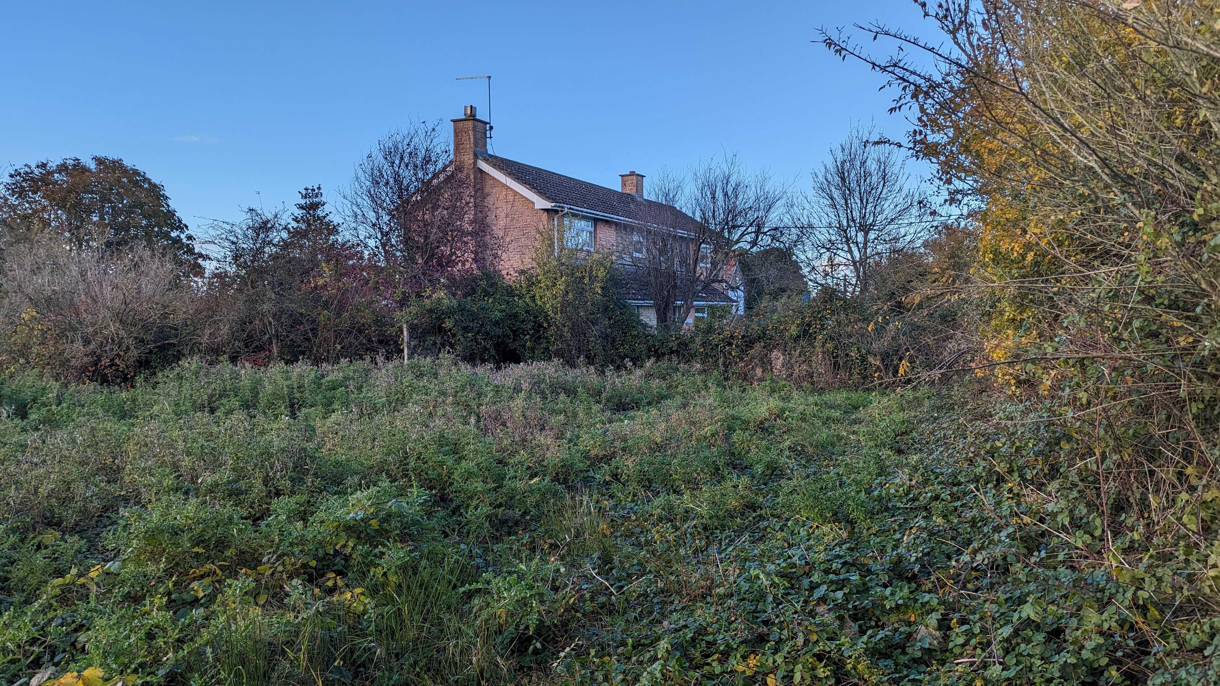

mjc55 Posted November 30, 2023 Author Share Posted November 30, 2023 Just completed on land, relatively straightforward although vendors solicitors was part of the hack that has hapened in the last week or so. Now the hard work starts! (actully the really hard work will start sometime next year, in the meantime there is a lot of stuff to clear) 3 Link to comment Share on other sites More sharing options...
